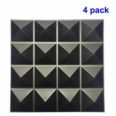

the reason I ask is because this pyramid looking diffuser looks like it would not diffuse low signals which would allow me to sit closer.
