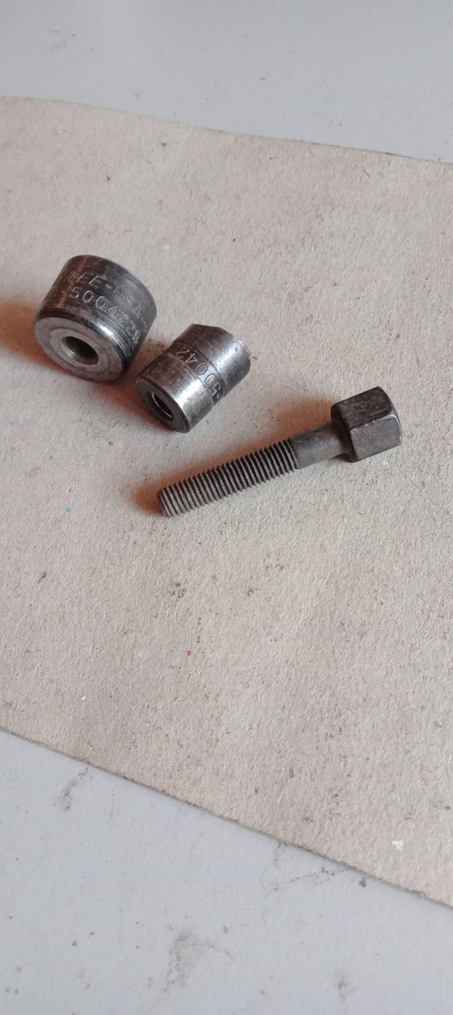

I used hydraulic punchers like this, don't have one do but I could DIY it with car lifting jack.
Problem as so far is that this tool will need 2 very hard dies to punch XLR , many holes in lets say 6mm alu plate. Puncher is 145€, tools probably another 300 . , wild guess as I couldn't find anything in google under "punching tool for XLR". Set up for punching 50 and more holes will probably be over 500€ . This is far too much for hobby, for most of folks....
Mostly, I use similar to these.

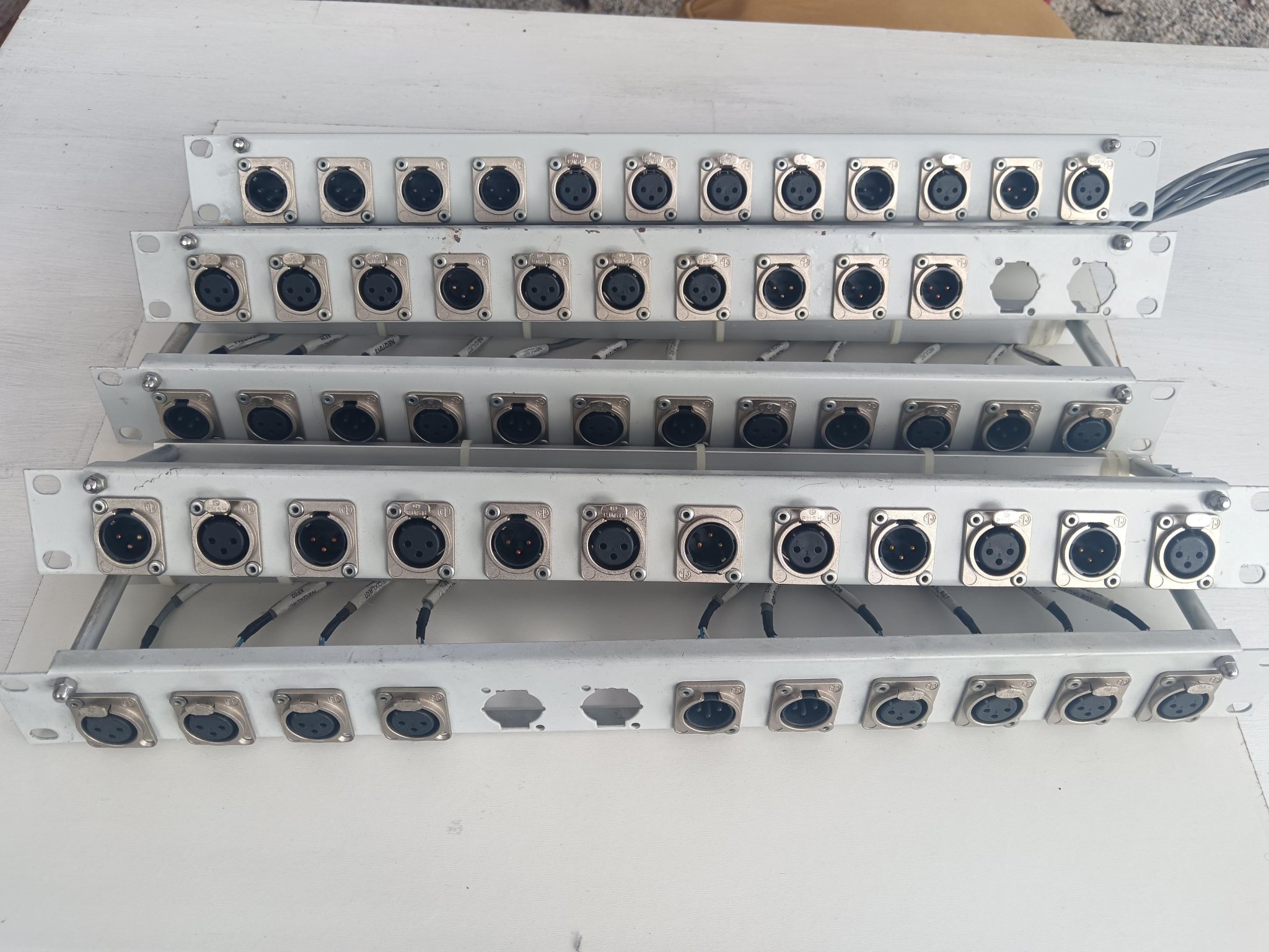

We used it for patch panel steel plates +/- 1mm thick.
Hi Netlist,
I also have small pile of XLR patch bays, 1.5 mm thick with paint, and of course already drilled. Combining pieces of them does the job, but not so nicely . Besides not everyone has proaudio XLR patchbay's in garage laying around..... I believe many DIYers loose so much time doing this, and eventually they avoid superb XLR-s

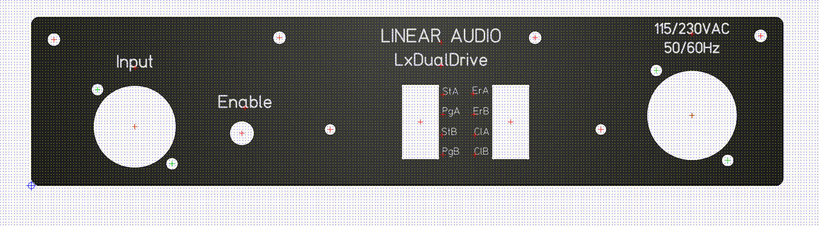

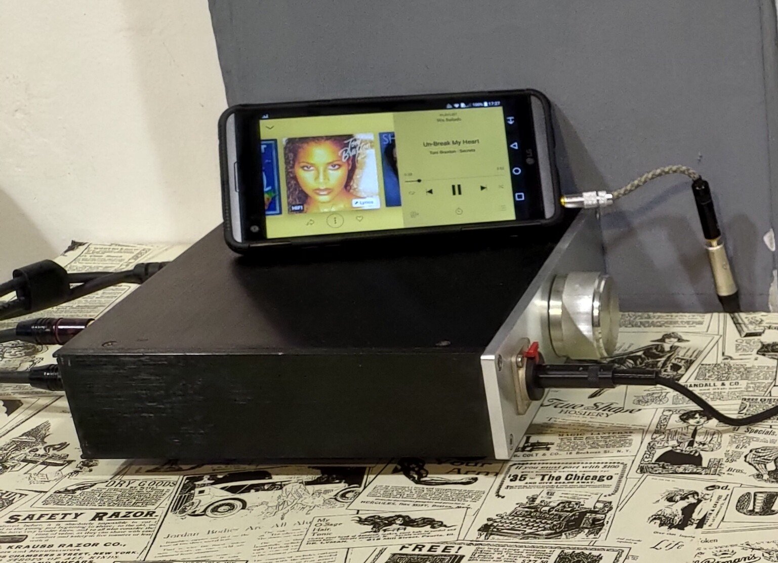

i use 24mm holesaw which fits neutrik headphone perfectly, it can drill 7mm alum plate easily without too much trouble. also made holes for 4 powercon and 2 speakon with same holesaw
