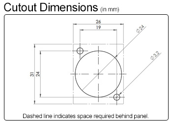

23.6 mm to be (too) exact.

Oh I only use plastic Neutrik with silver plated contacts like NC3FPP and NC3MPP. Never occurred to me that different diameters exist. When I started with XLR the vast amount of different versions surprised me indeed. Just thought "WHY?".

Neutrik is relatively consistent in mounting hole sizing, when one learns how to make them holes easy as this thread asks. Also RCA, USB, LAN, multipin XLR like 4 pin for balanced headset, powercon, Speakon (in multipin variations to handle active speaker with remote amps))....... all can be fitted in almost 🤣 🤣 🤣 🤣 same opening covering all that little audio student needs. So it is not that bad.
For back mounting, 24mm hole should fit all I think. For front mounting, bit messy, as Jan posted.
