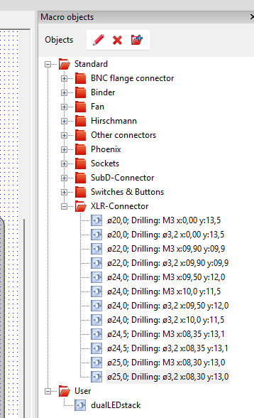

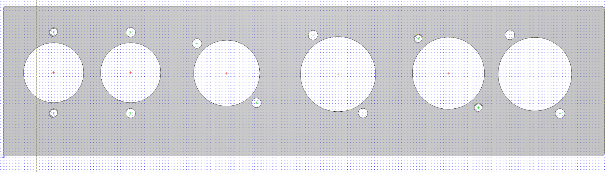

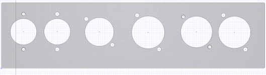

I did a quick one with 6 random XLR types on 3mm panel to keep cost under control. This one is 54 euro. Just an example.
You can also send them your own panel and they will machine it.
I have no connection to Front Panel Express, but find their service affordable, quick and perfect quality.
The attached panel was also around 50 euro, including the text engraving.
I had to modify the XLR hole as I changed my mind to the type of plug afterward. That's also diy ...
The square holes are for LED display stacks.

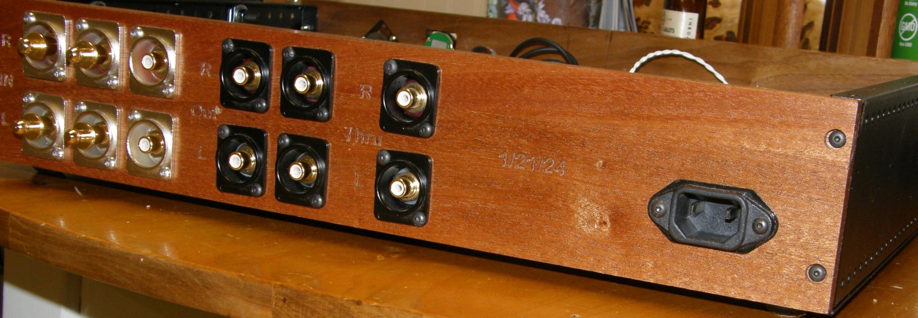

I must confess that at a certain point, I am not willing to try and produce 16 perfectly aligned holes for these sockets. It was enough to drill out the original RCA sockets so that the type of RCA that I wanted to use required a larger hole. A good friend in Washington state helped me along with his CNC machine. Now, I realize that this is close to apples and oranges because my front and rear panels were made of 7/16" thick wood. The point is that it would have been really shaky for to get all of that right. That is when you try and find maybe local help.
Hi Jan, these on picture are still for male back panel mounted ones 🙂 no slots that are the issue.

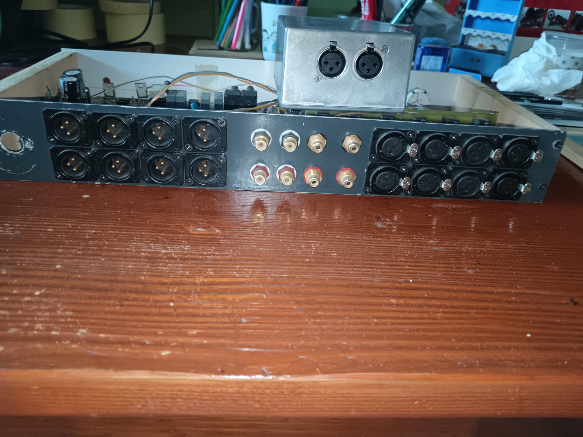

Just for fun, picture of what is laying around my man's cave: abandoned preamp experiment with 16 Neutriks, and on top experimental box for ultra low noise amps (this time I was smarter and went for back mounting)
On abandoned preamp there is hole for removed DIN (far left) that was DC power connector.

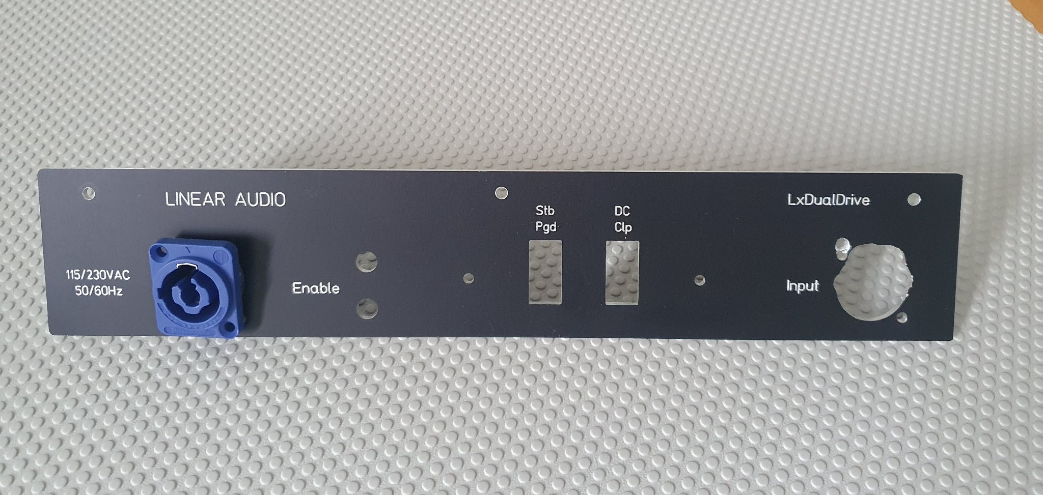

Jean-Paul. Not exactly. That was the first attempt (I had another panel) and I first did several successful tests.
I purposely countersunk the hole, the step bit has nothing to do with it.
The step bit, as the name suggests, is stepped, but you may want an intermediate diameter and therefore you have to use a bit of inventiveness.
After mounting the connectors, any possible smudge is obviously completely invisible.
