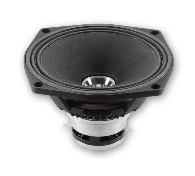

got BMS 6CN160 to demo just for fun.
listening now as 4 sub again.
if just i had some 15" i could cross sealed 18" @40hz that could be it.
Of course i could hit two more 862´s but those boxes are bit too large for me for now, but sure cats would love them.
