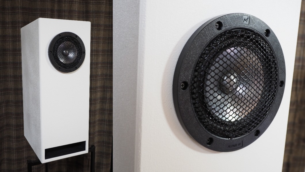

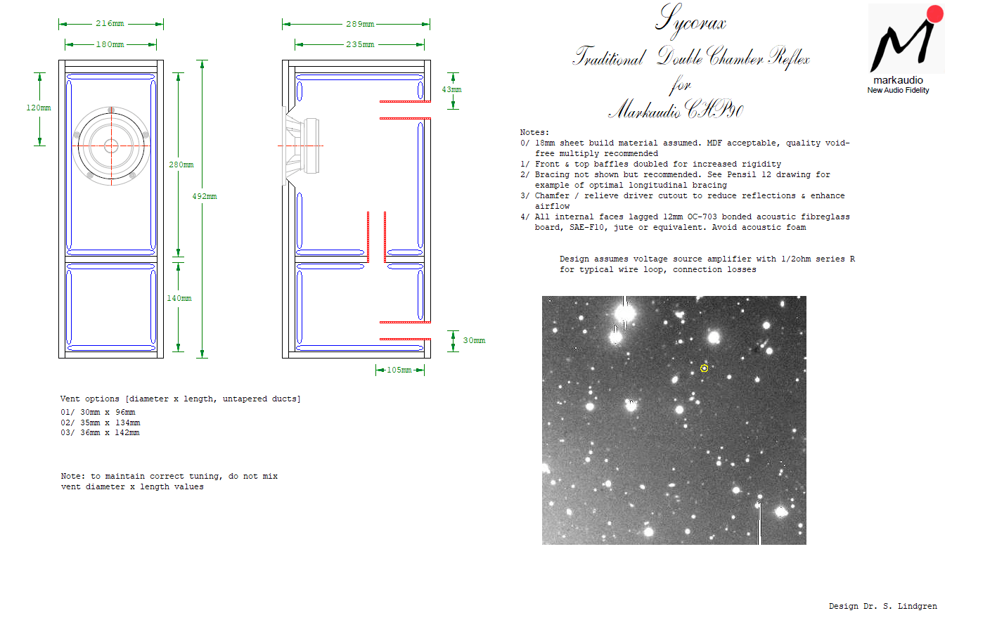

I just got a pair of this new MarkAudio fullrange drivers, the CHP-90 and would like to explore the options and have some advice for a nice build!

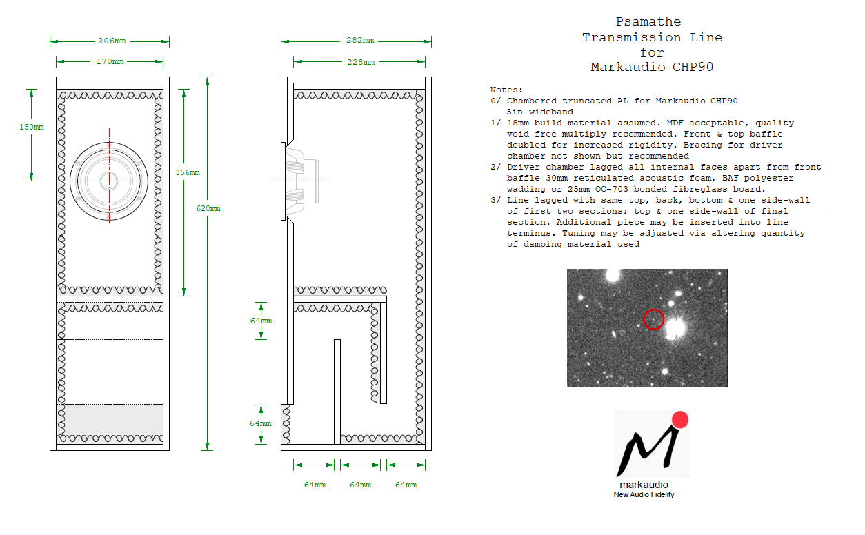

There are actually 2 rather interesting plans in the MA website, the Psamathe (some kind of TL) and a double bass reflex named Sycorax.
In another thread, the user nandappe posted a floorstanding TQWT that also seems interesting!
Another option I'm actually evaluating it's a so called "Hyper Bass-Reflex" (website of nandappe) that I would say a mix of ???Transmission Line and BLH??? Am I wrong?
I'm particularly interested on this one because I have now a pair of Dayton Audio RS100-4 in a small TLine adapted from this project named HADO and I have to say that they're really great! as desktop speakers! with really surprisingly great and pleasurable bass!!!
I'm actually testing the CHP-90 in a simple pensil and in a TL I've made, medium size box (45x25x25cm) but not really satisfied yet even because the material I'm using to prototype is styrofoam panels! of 3cm... so not at all acoustically perfect!
but great for modeling!

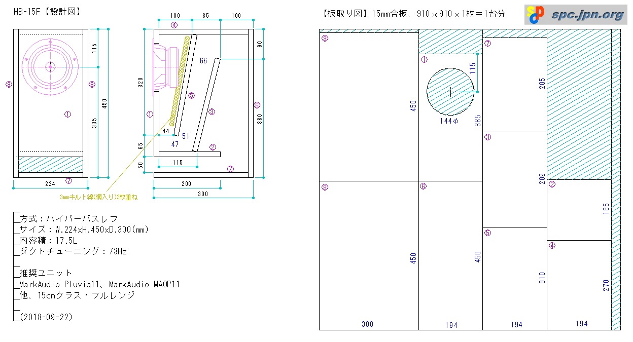

Any suggestion is welcome! and specifically to nandappe I would like to ask if it is possible to have a plan of an Hyper Bass for the CHP-90 or if the [HB-03] HB-15F (in attachment and linked above) can be fine!

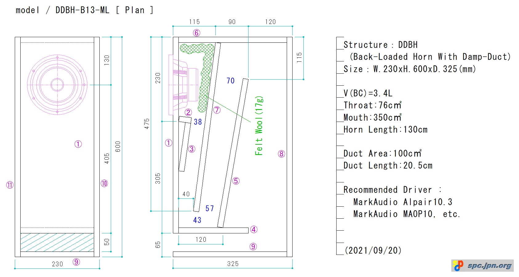

HB-15F works double bass reflex but does not fit CHP90, so I would recommend DDBH or TQWT.
DDBH-B13-ML, DDVP-12.5-ML, DDVP-15, or TWTD-13.5T would be good.
YouTube | MarkAudio Alpair10v3 + DDBH-B13-ML

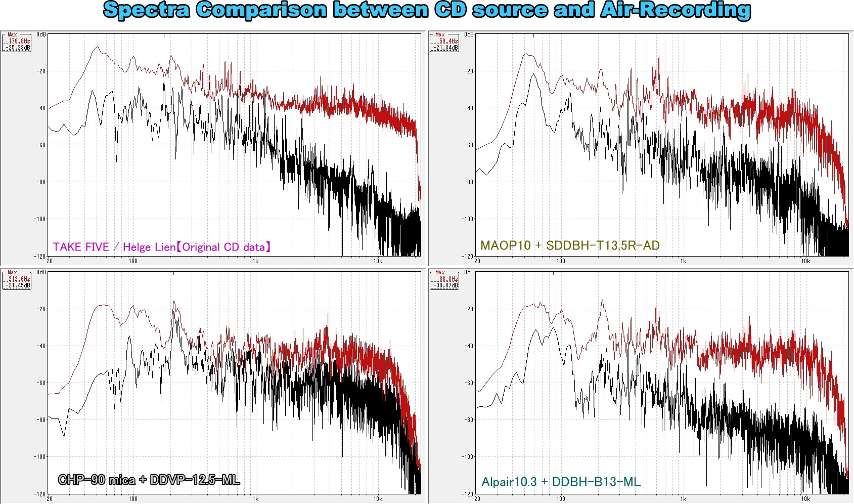

Any type of DDBH, SDDBH, DDVP, TWTD can be reproduced with sufficient sound pressure up to 50Hz.
Please consider the size, appearance, and difficulty of production when making your selection.
SDDBH-T13.5R-AD is very difficult.

From your attachment seems to me like DDBH follows as close as possible the source (CD)

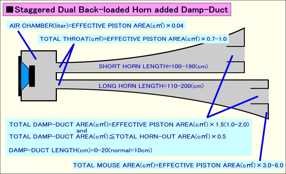

About SDDBH I have as a guide this
The box on YouTube that Elias introduced is an "Staggered Dual Back-loaded Horn".
It is not a SDDBH (Staggered Dual Back-loaded Horn added Damp-Duct).
If we add an optimal duct to the mouth of the BH, the bass output will change for the better. (DDBH, Back-loaded Horn added Damp-Duct)
NandappeThe box on YouTube that Elias introduced is an "Staggered Dual Back-loaded Horn".
Thank you so much for the translated schema!
I couldn't find some way to translate from Japanese to English the content of this schema (maybe a partial translation through my mobile phone by capturing my pc-screen)
![Christmas Hat Smily :xmasman: :xmasman:](https://files.diyaudio.com/forums/images/smilies/santa_smiley.gif)
Elias
Thank you for the clarification about SDDBH. Yes I missed the difference. My apologiesNandappe
In the above schema you wrote (bottom line) "TOTAL MOUSE AREA....." ? Do you mean "mouth area" ? Maybe your design https://www.diyaudio.com/community/threads/markaudio-chp-90-mica-ddvp-12-5-ml-tqwt.389031/ it is equally good sounding but much easier construction and maybe I have to follow that.

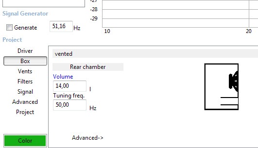

I want a slot instead of tube so here what WINISD give me (1st time using it but I think shld be fine).
14L, 50hz, slot 2x12,5x17 cm
