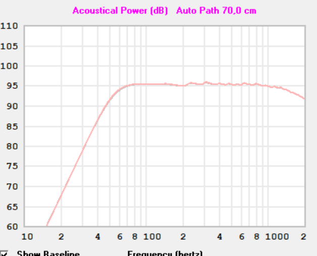

Yes. But I use free air 2x. ~89db.Is it ok hornresp simulation for CHP-90

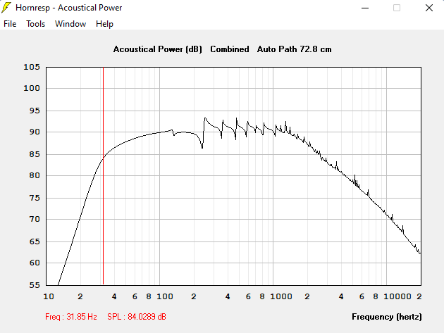

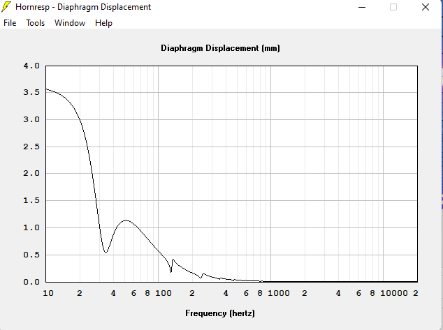

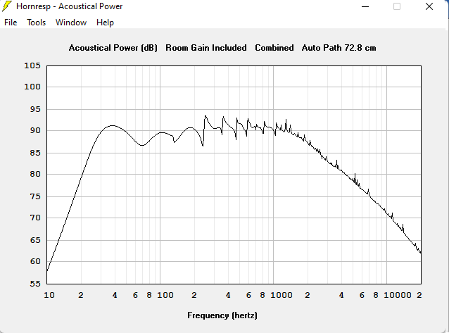

For fun, I modelled them in a bipole metronome (two series drivers), and landed on an unusually large (58 l) and low-tuned (34 Hz!) EBS-inspired alignment that looks pretty decent on paper. Looks like diaphragm displacement is controlled pretty well, and the rolloff when blended with some simulated room gain looks like the end results are decently flat. Practical in real life?
Plots are at 1W input power (3.52V into 12.4 ohms for series drivers)

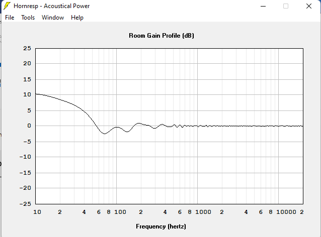

Just two CHP-90 drivers in series (2S configuration in hornresp); practically speaking one forward facing and one rear. Single port at the bottom as usual for a metronome. You can get the same response curve shape by using a single driver, 1/2 cabinet volume, and lengthening the port to match the same fundamental. The end result for this design scaled down to a single driver has less sensitivity and higher excursion; lower power handling capability and more distortion.
