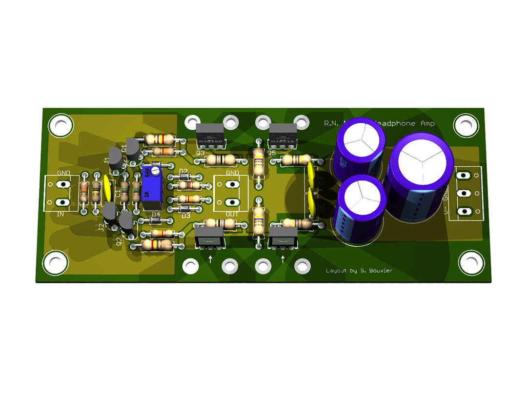

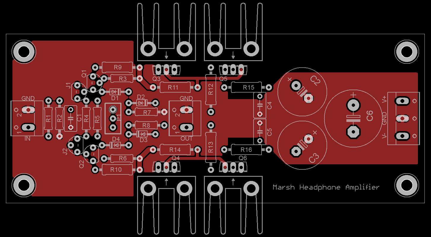

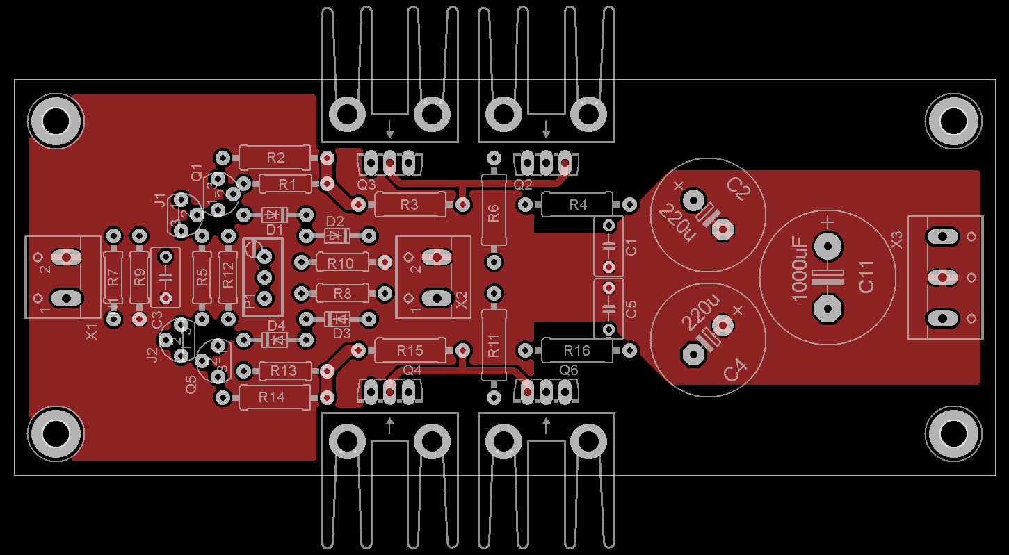

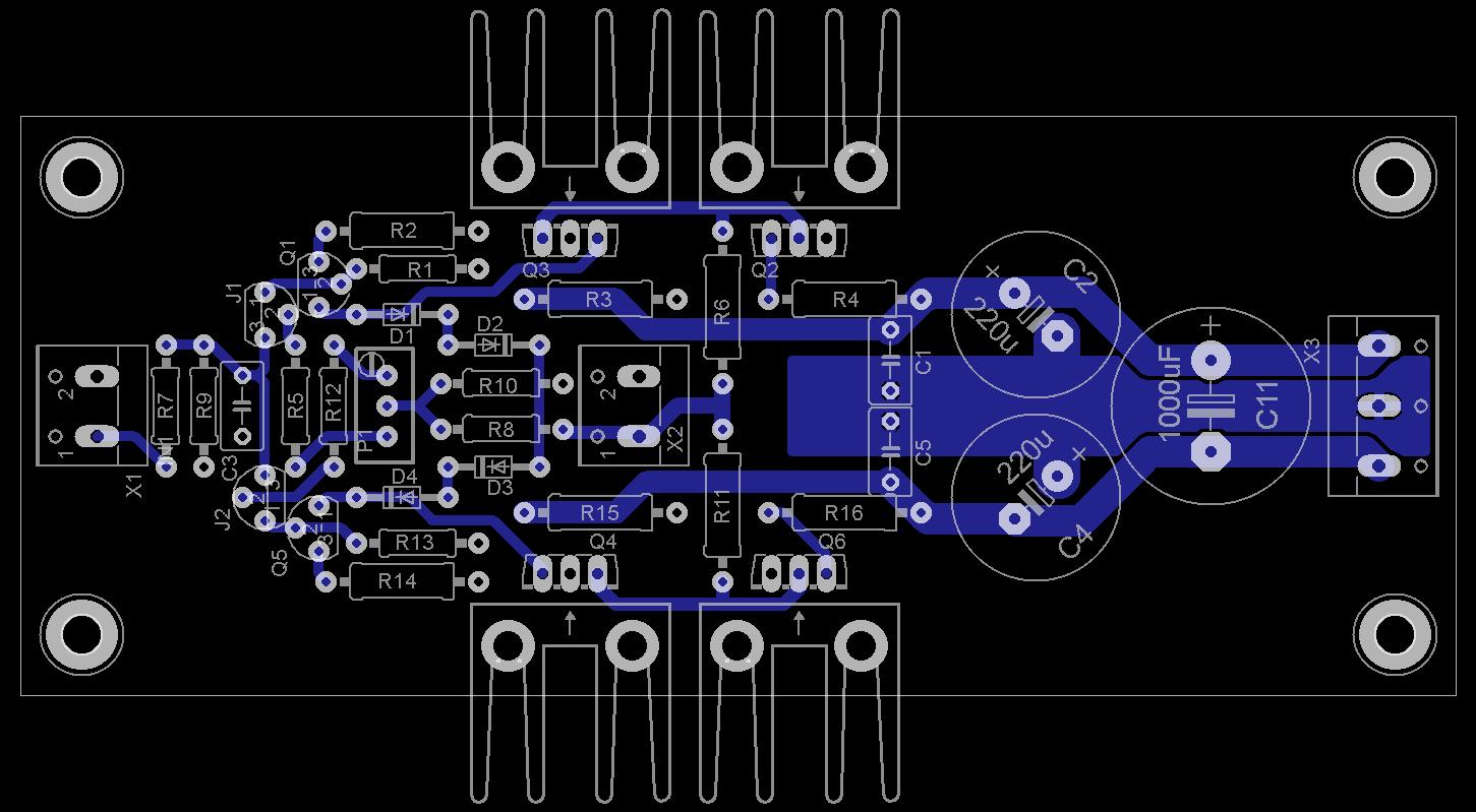

New layout guys, what do you think?
Different approach this time. Following previous advice, it began with small changes and ended with quite a different shape.
I also added optional bypass capacitors, filter cap on the input (220pF), big electrolytic across the rails, and higher bias if needed.

OK, I increased a bit the clearance on the supply rails side, but I prefer not to on the signal side, as it would split the ground plane too much. Do you have any reason that you want to widen it more? The clearance is 16mil, which is quite conservative and should not pose any problem for manufacturing.
I renumbered the parts, and added information on the silkscreen.
I will soon send the files to manufacturer for a quote.
Anybody interested can shoot me a PM. Cost for one board should be no more than $6-8 each, possibly lower if several people join in.
If there is enough interest, we could go for high quality 2oz copper PCBs, possibly gold plated.
