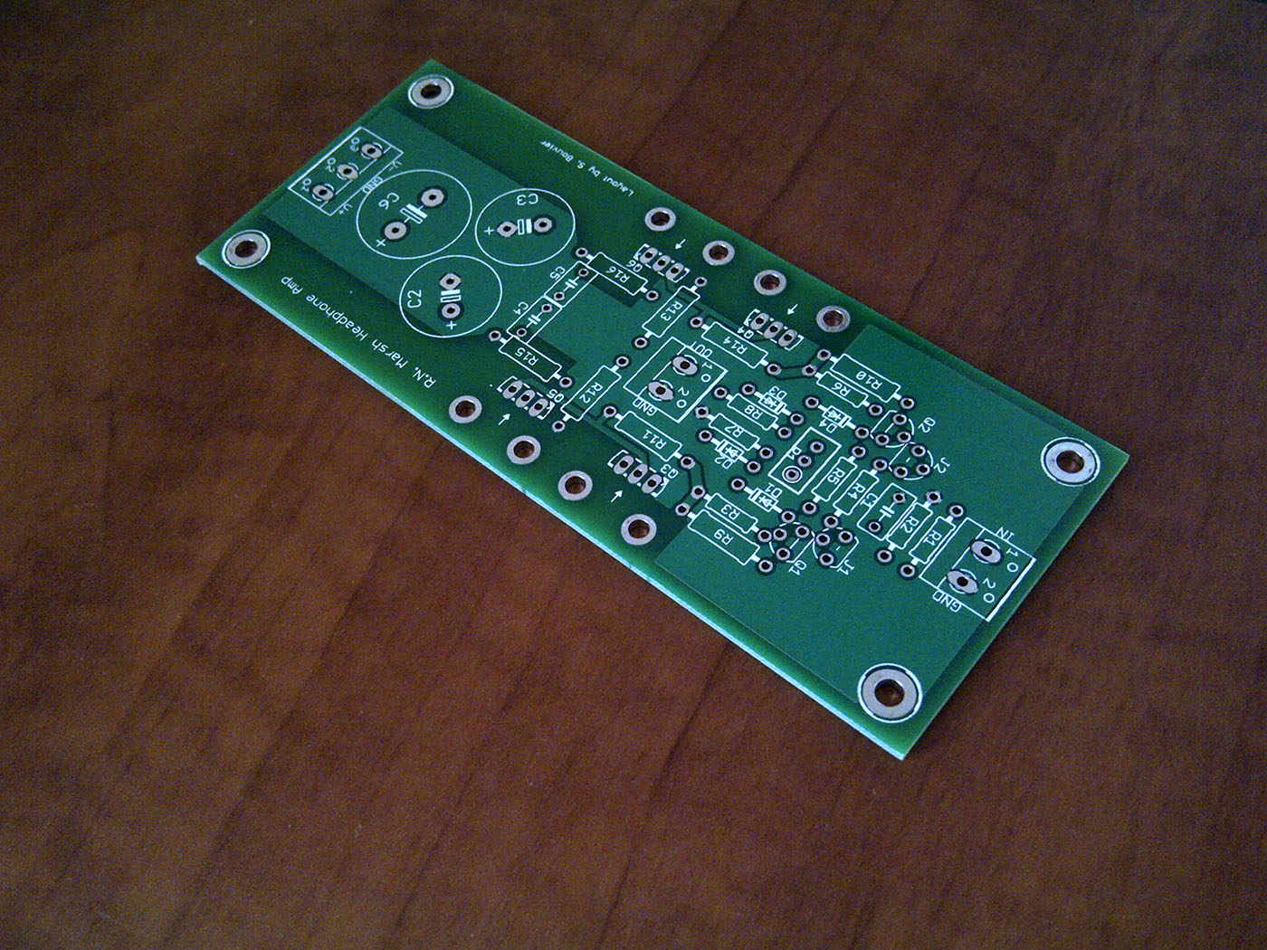

Hi CafeNoir,Files have been sent to production; I ordered 10 PCBs with 2oz copper.
Below is a virtual render of a populated board using Eagle3D.

My boards were made to accommodate mounted heatsinks, as well as other options (bias, filtering, etc.). They are a bit more expensive ($9 per board, so $18 for a stereo set), but if you still want it, I can put you down for two PCBs.

One small note about Tech-DIY boards: the copper plane on one of the channels of the PCB is not connected to anything, even with the jumpers mentioned earlier. If one wants the pour to be connected to ground, one must scratch some silkscreen off and make a connection there. The issue is in the right part of the pcb, when seen from the top.

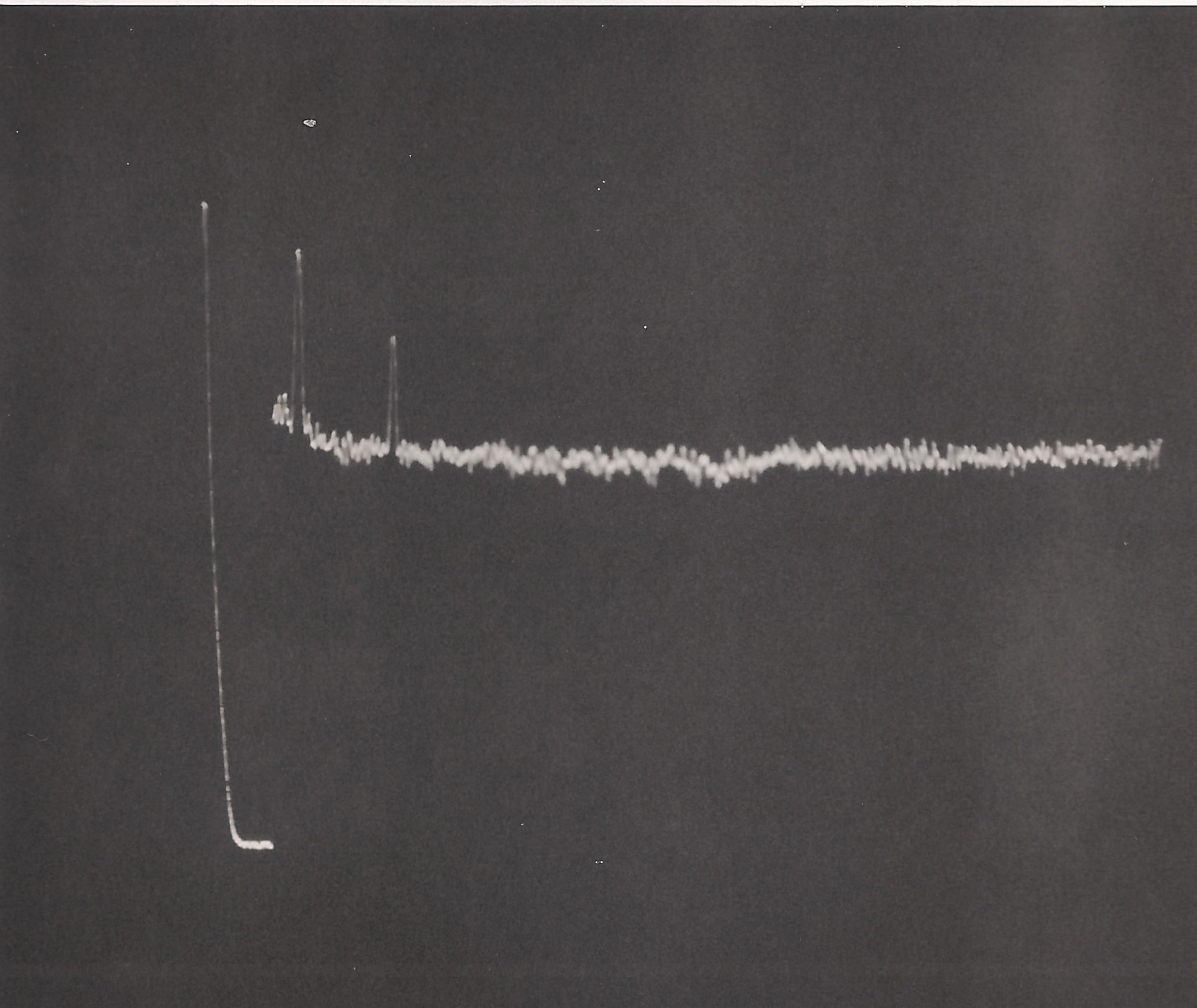

One of the reasons for making a gnfb amp with moderate nfb is to get a flat thd curve vs. freq. Usually you get a rising thd as frequency increases. With the same amount of nfb at all frequencies the thd should be constant over the audio range.
In fact this is the case. I see only 2 harmonics with either 1KHz or 10KHz and they are the same level. Plus, No higher orders -- no 5, 7, 9th etc.
-110 -120dB

there are plenty of distortion mechanisms that rise with frequency despite flat global loop gain - anywhere you have a nonlinear C
and if we are most concerned with IMD products in the most sensitive hearing bands then we don't want to "throw away" loop gain that gives distortion reduction there - global feedback does reduce even IMD difference products
so if you can have 26 dB more loop gain at 1 KHz than 20 kHz with common single pole compensation, the CCIF 19+20 kHz test 1 kHz IMD product is ~26 dB lower with the integrating loop gain curve than with the same amp with flat audio frequency loop gain below 20 kHz for typical output stage dominated distortion

The point here is a narrow one. yes, i admit that. never-the-less, when one looks at all forms and causes there are a multitude of mechanisms to be sure. And, yes more fb will reduce distortions more Etc etc etc.
BUT --- if you look at the harmonic distribution - the harmonic structure, the harmonics them selves and which ones and their relative amplitudes to one another.......
With the Same amount of gnfb appplied at all freqs tends to give the same characteristics for the harmonic structure anywhere. You dont get one set at low freq and another at high freq. levels are the same and structures are the same. This has an affect on the percieved sound, I believe. A continuity in the sound that cant be duplicated any other way.

Good news; boards just arrived
Time for a quick inspection. They look good to me so far
All people interested, expect a PM soon![]()
