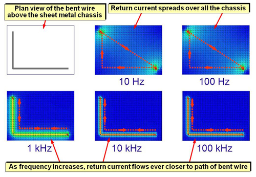

Mutual Inductance paths for current -
I mentioned that pcb traces for power supply need to have their own ground trace running under it, didnt I?
Ground planes act as a wire at the higher audio frequencies for same reason.
This is a visual of what I am talking about ---> It isnt just at RF this happens;
THx-RNMarsh

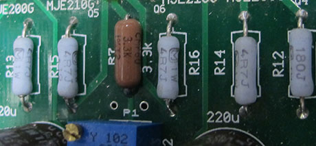

Also, my parts kit came with a mix of CMF55 and CMF60 3.3K resistors and the latter don't fit the PCB hole spacing ... just an FYI ... I can order some extra CMF55's in my next Mouser order.

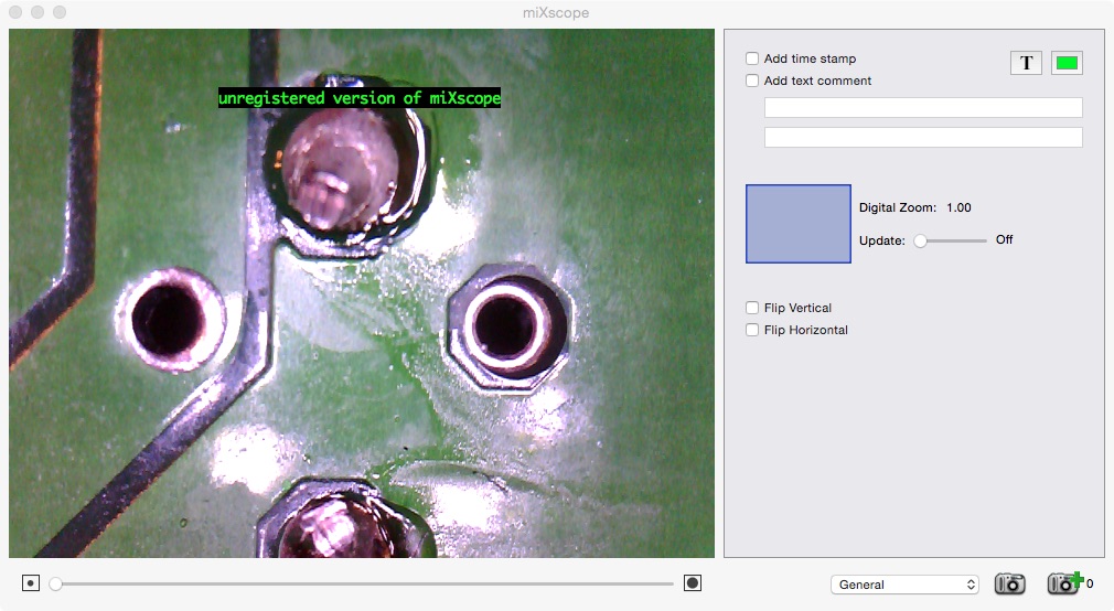

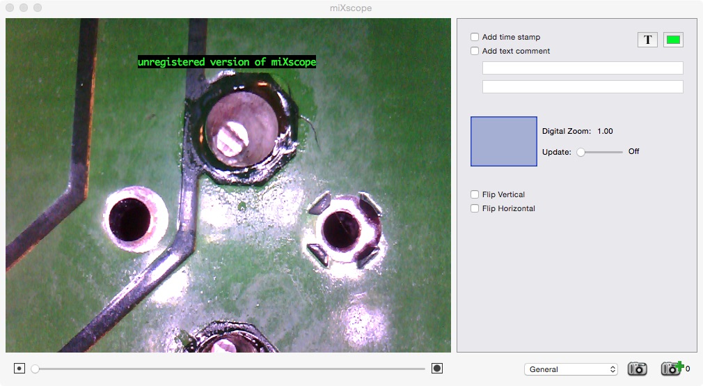

Thanks ... went back through the whole thread and found the jumper discussion. The discussion is very confusing to say the least. After looking at the PCB, all it does is tie the "shield plane" on the bottom to Ground ... and if you look close, it only does so on one side of the PCB ... the other side is missing the thermal ties on the vias, so a jumper would do nothing on that side.

WRT the CMF60 resistors -- there was also 3.3k CMF55's in the package.

True, but not enough to build the board. My OCD won't let me put 3 CMR60's on a PCB when the rest are CMF55's.WRT the CMF60 resistors -- there was also 3.3k CMF55's in the package.

That the signal ground and ground power plane are not connected and is not an error in the Gerbers, but to allow the two nodes to be connected at the user's discretion.
Use the CMF60's for the feedback resistor, the CMF55's on the drains of the jfets, a la:
Take a look at the screen caps below. One channel the via in the "ground plane" has thermal ties. On the other channel it is floating, so soldering a jumper will do nothing.
This sure looks like an error to me!
