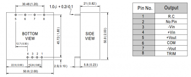

I have everything wired and ready to go but I can't figure out how to power the DKA30A-15 with with the wall wart on the input side of the converter.
What capacitors are you using across the mean well ska 30A-15?
What the problem appears to be is that without the caps, the dc-dc converter puts out a lot of ripple, per Jameco. They do not recommend the converter for audio for this reason. When I stated that the ripple should be able to be dealt with, they stated, yes possible with a cap. Since the ripple is 100khz, I need to figure out the best cap to bridge. I would suppose this would be across the pos and neg output.

I get 18.2 volts across pos and neg of the output of the dc-dc converter.

Anyway, I am using the HE-560's right now. Sound pretty good. A little bright, which they aren't on other amps, including the Lyr 2 with Telefunken E88C's. But burn in is needed, I would think. Still need to resolve the hum but almost inaudible on the 560's with the output of the converter bypassed with 4300uF's of Black Gate.

Ok, it was the wall wart. Go figure. I plugged in a battery supply I have that can run this fine to the converter and zero hum, even on my very sensitive phones. When I called Jameco the tech said that anything on the input side of the converter would not cross to the other side but somehow the WW, even though there is little ripple is doing something to the whole system. So there you go. I can get it together, button it up and enjoy the music.
