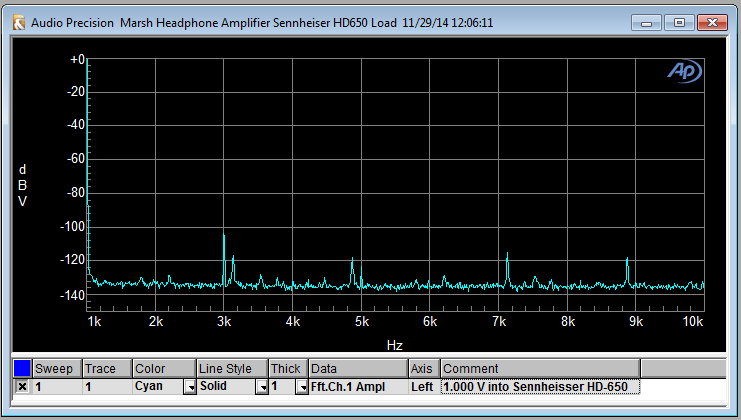

The 2H and 3H are the only harmonics produced .... 4th and higher order harmonics are below the residual of the instrument. You ought to be able to get what I measured ---about -120dB re 1v --- with matched compliments every where.
With as few transistors as possible, these numbers compare well against high gnfb IC amp/opamp performance used for a headphone amp. But it is the sound which exceeded my expectations and hopes that it would be better than an IC amp.
Enjoy !

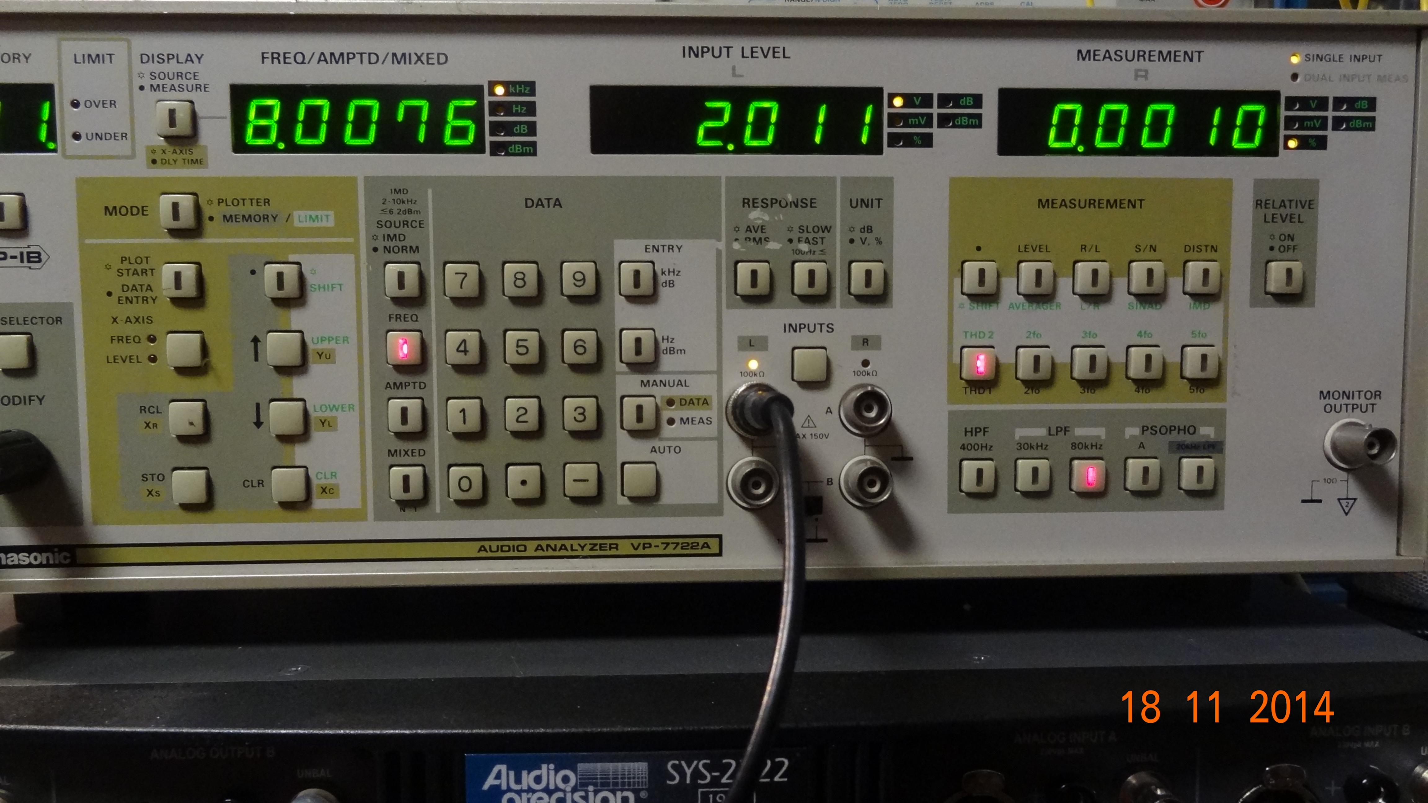

If you want to use it to drive other gear directly (power amp etc HP amp using +/- 24vdc supplies) Here it is at 2v rms and at 8KHz... the THD is still -100dB.

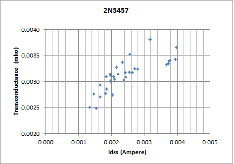

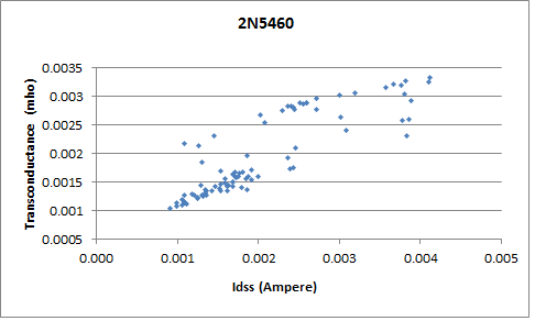

I tested a bunch more 2N5460 and 2N5457 -- this time I noted Vgs(off) and Idss and graphed the result. As you can see, the relationship is linear, but the variation is pretty significant. If you're matching these devices, it would seem best to measure both variables.
But, why not adjust for lowest thd with the actual headphone plugged in instead of a resistor value? Sometimes, the complex Z of the real headphone (or speaker) is more difficult than a pure resistance and raised THd of the amp. If you have the equipment, you can use your own headphone when adjusting or balancing the amp

le voila -- il n'y pas de second harmonique:
Could you do same with a -5458? I found more compl. pair matches per group (Idss) with this fet.
THx-RNMarsh
Sure -- what I've found is that the 2N5460's are about evenly distributed between 1.0 and 3.5mS while the 2N5457's are distributed between 2.4 and 3.9 mS.
It's easy to make a higher gm "2n5460" by paralleling 2 devices.
The Peak doesn't work particularly well with these low Idss devices. It tests JFETs between 3 and 5mA.

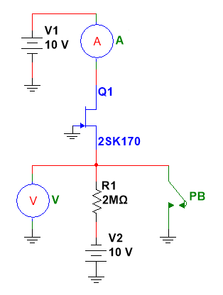

I'm trying to match some PF5102s:
http://www.mouser.com/ds/2/149/PF5102-99964.pdf
Will the circuit you posted also work for matching them by Idss, or can you suggest a circuit that would work?

It should, the one thing to be watchful of is that the noise of some switching JFETs can be high.

Dialed in -
Whoa ! Jack, you have really got that thing dialed in. What supply voltage are you using? Have you tried higher voltage?
And, are you using the original low C jFETs (2N5460 etal) or other?
THx-RNMarsh
THx-RNMarsh
Using a pair of 7AH 12V batteries and the Sennheiser HD650 cans.
Those are the 5457 and 5460 JFETs from Fairchild.
To tweak R10, I kept the original 249R in with a 200 ohm trimpot. These were paralleled with 820R which gives me a range of 191 to 290 ohms. The DC offset is plus or minus a millivolt or so.
