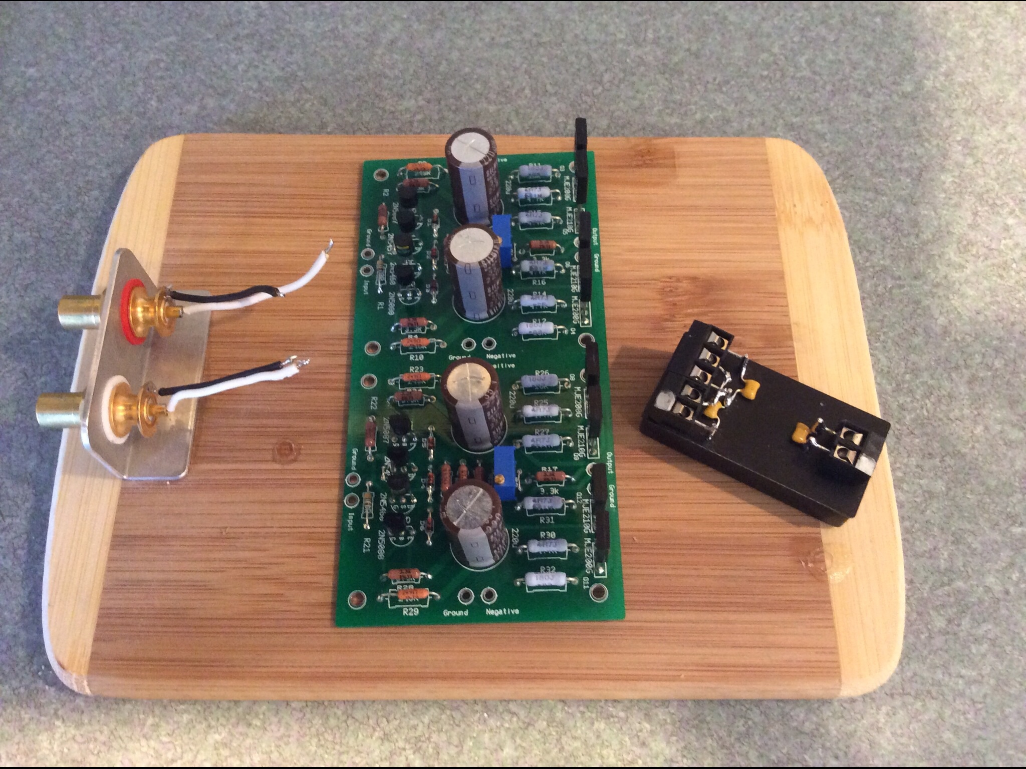

Steve,Well, the PCB and DC-DC converter is assembled now . . . Waiting now on a 12V 2A wall wart and a 1/4 stereo phono jack.
I just finished soldering up my boards this weekend and still need to build the power supply. Like you, I'm waiting for a few parts. I took a quick look at your build and noticed that you seem to have put in jumpers shorting the two vias close to the potentiometers p1 and p2. Is that for connecting power ground to signal ground? I missed the discussion about these jumpers.

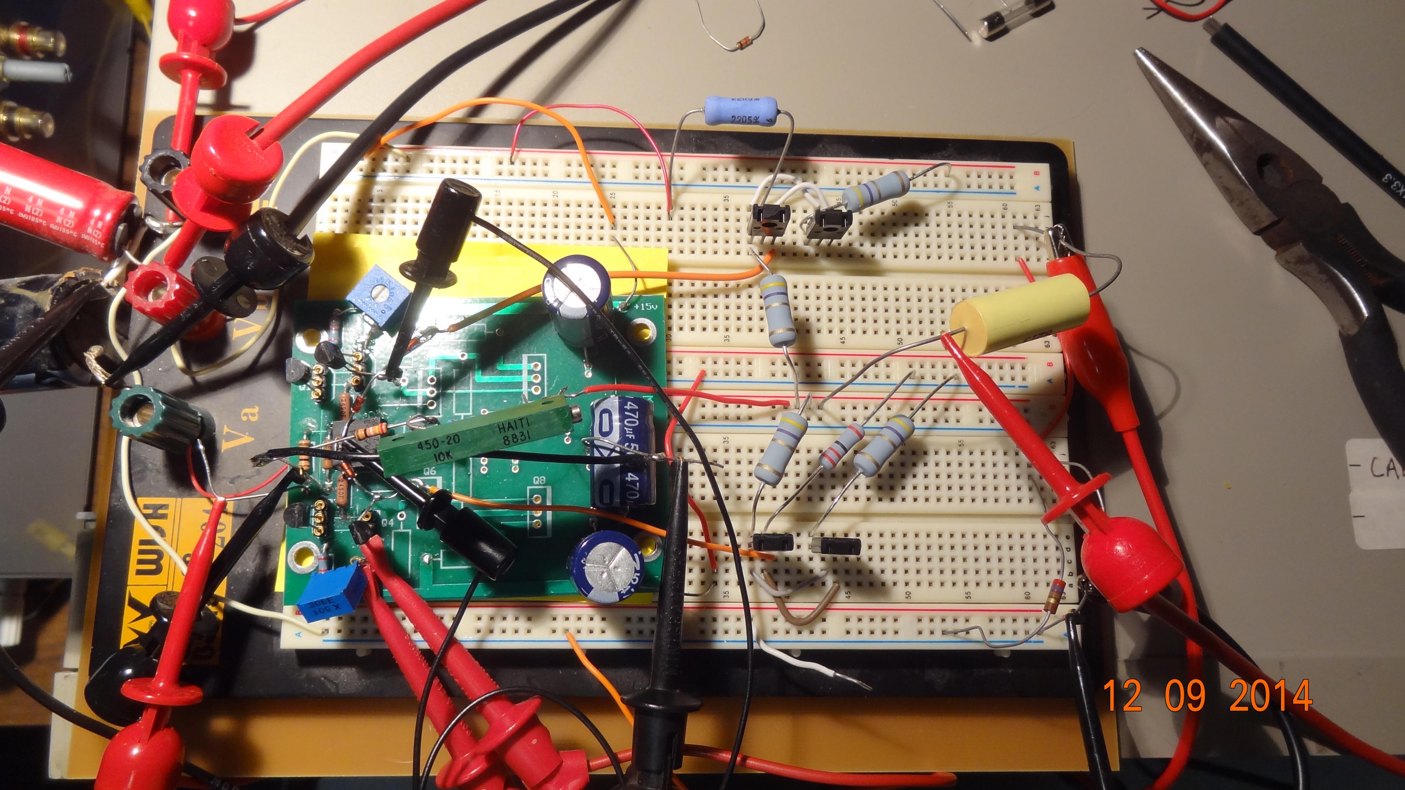

A genuine breadboard layout. Sorry, I could not help myself. I have been following this post with interest. Thanks for sharing.
Its a teak coaster from Bed Bath and Beyond. Only a couple of bucks, and great to do small layouts on.
Steve,
---Gary
JackinNJ covers this back starting at post #293. There is another jumper near the input, per channel too. They tie ground together for each individual channel. Then both channels then need to grounded, at the star ground/CT as outlined by Richard Marsh.

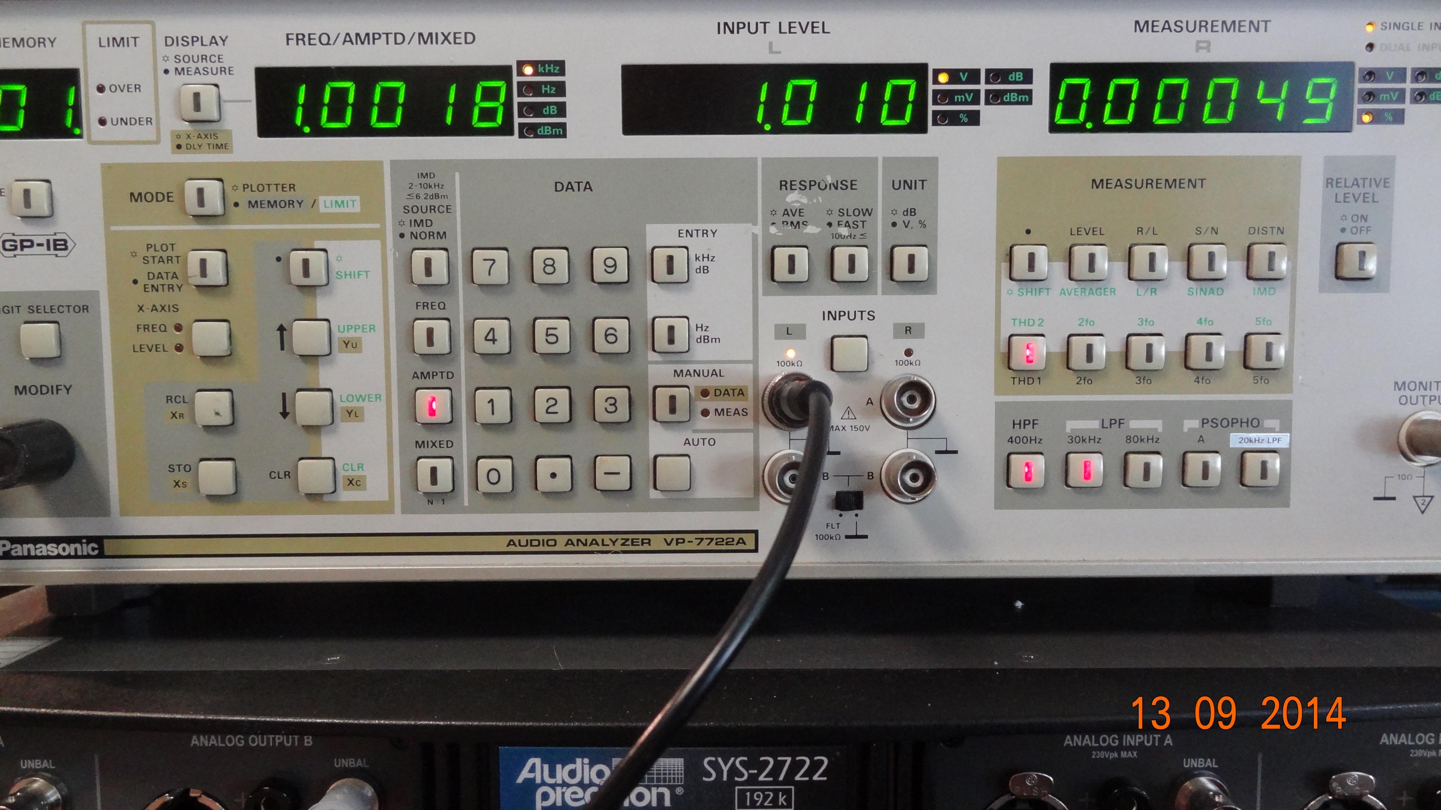

FYI - higher PS voltages
Here is something I did a couple days ago because i was curious and others might want to experiment.
I tried some options for transistors. I found that the yield for matched fets was higher when using the 2N5458 and 2N5462 for J1 and J2. And, Q1 and Q2 can be BC560C and BC550C. I tried higher voltage output devices so I could run up the power supply voltages.... more headroom and lowers the THD further. With the orignal transistors you can run at 15vdc... in fact I ran the whole circuit at +/- 24vdc with out blowing up the output devices. For the original device choices, 18vdc PS seems like a sweet spot for lowest THD.
I did a quick test using the above transistors with higher voltage OPS transistors... Q3,6 were 2SC5694 and Q4,5 were 2SA2037. I didnt match them.... though they should be for lowest distortion.
Using 24vdc supplies. Unmatched OPS transistors.
This higher voltage reduced the THD compared to lower PS voltage and allows lower Z loads with minimal affect on THD. Greater heat-sinking would be required. At 18vdc, the THD was in the .001x range.
THx-RNMarsh
I did a quick test using the above transistors with higher voltage OPS transistors... Q3,6 were 2SC5694 and Q4,5 were 2SA2037. I didnt match them.... though they should be for lowest distortion. About 145 F at 24vdc without heat sink.
View attachment 438275 Using 24vdc supplies. Unmatched OPS transistors.
THx-RNMarsh
