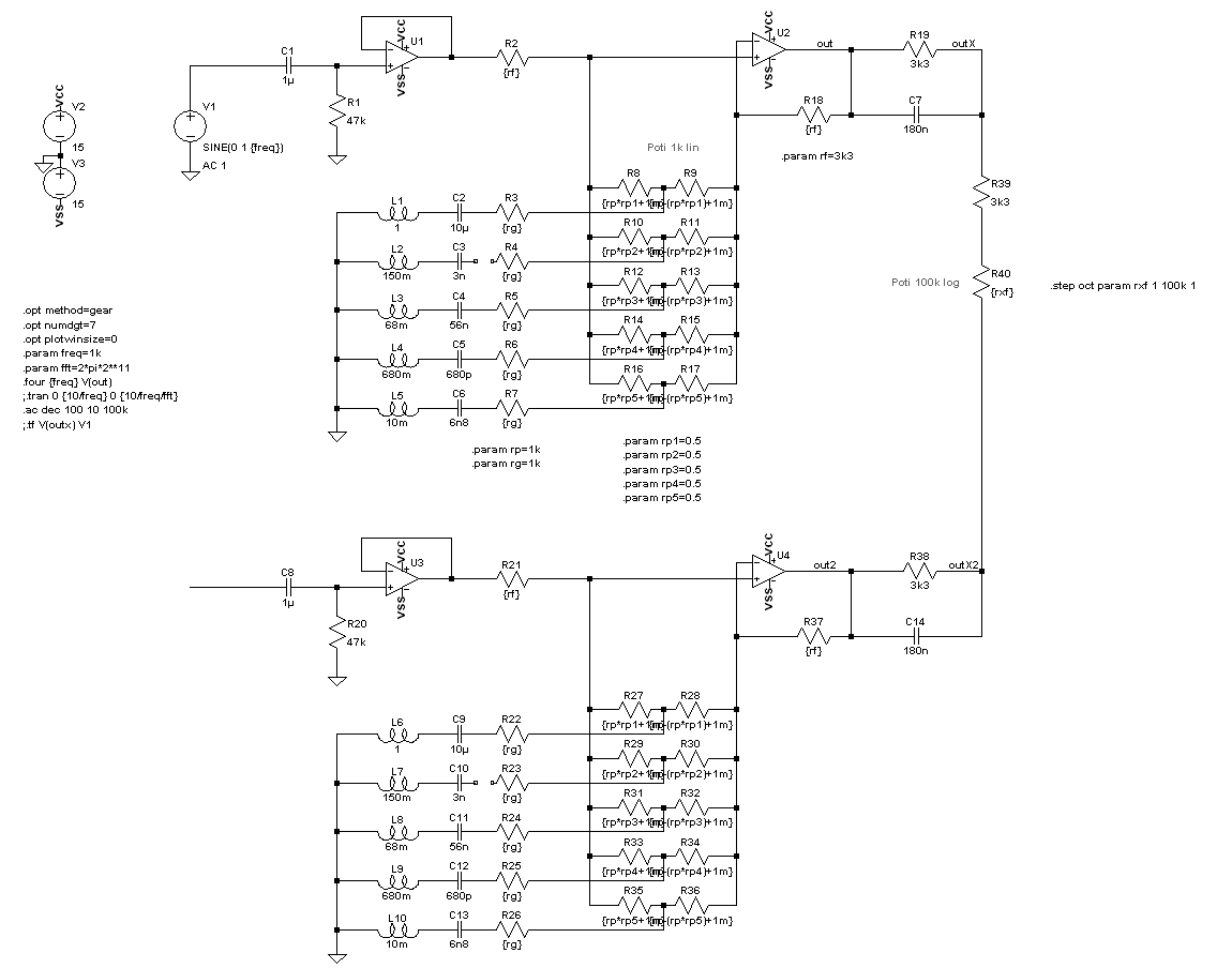

The EQ is currently working in the simulator. I've used a tested Elektor design where I have a pcb lying around for and adjusted the values according to a graph found around the interwebs. Added a sharp notch filter at the "Linkwitz Frequency" of around 7.5kHz and some crossfeed a la Jan Meier. Did not build it yet, but it should work out.

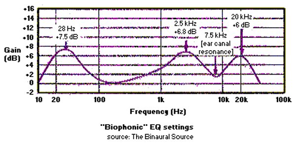

It will be interesting to know if you like how it sounds with it EQ'ed with that curve. I have a 1/2 octave EQ to play with and can set its controls to hear the affect of EQ. Also some software can be used to change EQ with. Didnt work for me.
What DID work was to EQ the headphone and ear canal to flat freq response at the ear drum. Its all described in the same headphone article in Linear Audio.

I did actually try something along those lines. Used REW (Room Equalisation Wizard) as a software to pick out the peaks and dips to then resemble them using the Electri-Q plugin for Winamp. The effect was not as pleasing to me as dialling in a roughly biophonic curve using the same plugin. I also did notice that the dips and peaks used to vary by an octave or more depending on how and where I put the mic probe under the earpad (i.e. from the front or bottom, a little lower or higher, put it in some more or not as far, etc.), which made the whole affair a little awkward .
