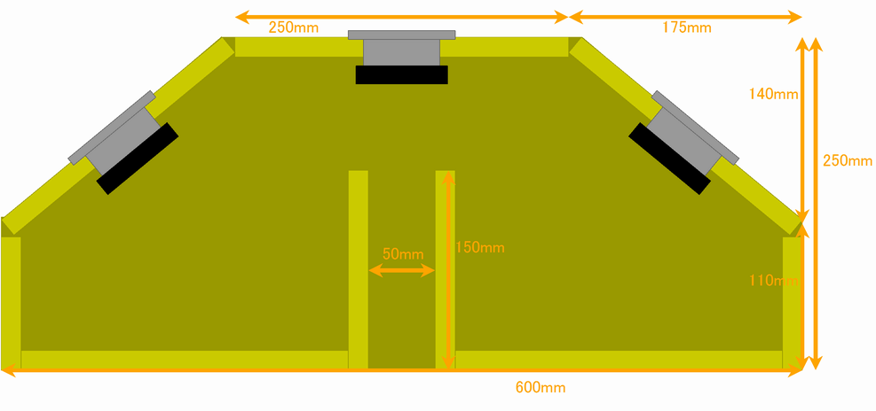

I am looking forward to an improvement in the sound once I put it in a single box. The spacing is currently 16 in wide side to side, is that too wide? Also, could not a test "box" be implemented in a U shaped open baffle tri-fold of stiff cardboard or foam core so that the angle of tilt can be adjusted? Or will the semi dipole behavior of the open back ruin everything?
When you say the spacing and arrangement is delicate what is the max spacing between left and right channels?
What would be a fitting solution for a helper woofer under such a Matrix speaker? Monopole? Dipole? Running a summed mono signal, or differential signal (probably not a great idea on that last one....)?
Is it better to keep the Matrix speaker a certain distance from the back wall?

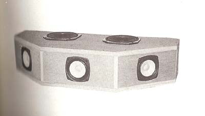

In 1980's when VHS video cassette ruled the world, there was a need to focus on audio quality on audio-video systems.
Then Tetsuo Nagaoka designed these matrixed single stereo speakers.
Nagaoka MX-16AV
Nagaoka MX-17AV

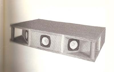

with extra bass output
Nagaoka MX-20AV

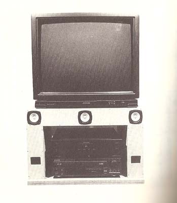

to be placed under the TV
Nagaoka MX-200AV

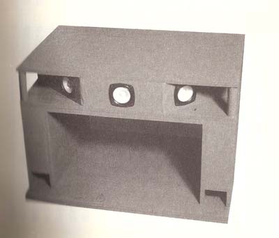

complete AV rack. Reflex ports on the bottom ?
Nagaoka MX-210AV
with elements directed at front
I don't think OB will work for this matrix. Closed box is better, and elements can share the same volume.
Because I discovered this single speaker stereo system independently, I used dimensions slightly smaller than Nagaoka, plus I used 90 degree angles in the box. I tested box widths between about 20 and 25 cm. The size of the side panel should be big enough, I would say minimum of 30*30 cm.
If the cross over if low enough, the topology of the added bass may not be critical.
Most elegant is to use matrix bass, of course 😉
And the vicinity of the front wall seems not to be critical. I've pushed the box touching the front wall without much influence. Except of course there is some bass boost with on the wall placement.

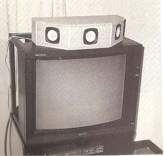

nice looking, but...................
Most tv's over here are 3" thick.
Maybe if the tv sat on the speaker. I like it though.
Maybe run a 30 degree angle off the front for the stereo speakers, then break another 30 degrees to run the surround channel. Too bad surround is in stereo. The dipole surround was my favorite for fooling you into believing you are in the space. But with the dipole surround, as soon as a single bullet travels from front left to back right, it sounded like it went into a cave.

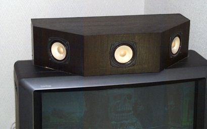

Nagaoka MX-10
There was an improved version of MX-1 called MX-10, with more bass output apparently using some sort of reflex port extension hidden in the base.
The 4 element matrix was the same as in MX-1.

This MX-10 DBR looks quite interesting, as you'd need a stand anyway. And, instead of a matrix connection it would be fun to try a classic series/parallel connection to use it as a speaker for one channel with wide dispersion (I'd put the front firing ones next to each other then). Or, with a multipole switch it should be possible to use it as both a single matrix speaker, or as one half from a stereo pair.
But from the drawing above, it is not obvious what the dimensions are of the ports (a) between top and base, and (b) between base and the outside world.
