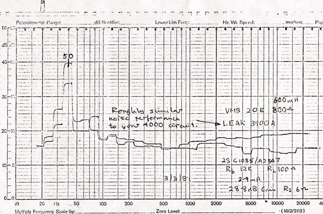

Here's an example (not transimpedance) measured with our steam powered B&K 2307 & 1/3 8ve filter set.
The B&K 2307 chart recorder has slipped by 1 tooth so 50Hz (hum) appears at 40Hz. 1dB/division. I await with bated breath for Doug to show us how to get unmeasurable hum with unbalanced stuff 🙂
The MM is an Ortofon VMS20E. The Ortofon MC, either MC20-2 or MC10. The MC preamp is set for very high gain 28.8dB so if adjusted for equal loudness from the 2 cartridges, the noise advantage of my little circuit is even better.
What this shows is that with the common noise weightings, the MC with this circuit is at least 3dB quieter than the MM into a good MM RIAA preamp. The character of the noise is nicer too. With RIAA, MM noise is whitish while MC is redder than pink and less obtrusive.
If we use Doug's Virtual Reality Input Z, you can claw back 1dB and a bit for the MM but the MC with this circuit would still be quieter.
Of course, you need a very quiet MC preamp to realise this and the measured 1980 device is surprisingly still the quietest such beast in the universe .. 0.28nV/rtHz.

Most MCs have higher 'power output' compared to most MMs.
But MMs are further hobbled cos their inductance doesn't allow their 'power output' to be realised fully. A Transimpedance Amp may be the closest.

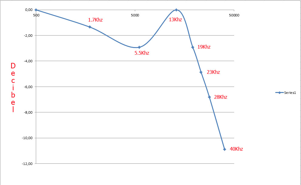

I have transferred your Grado's 500 to 50Khz plot as accurate as possible into a version with a dB and frequency scale.
Here is the result, showing a 6dB/oct roll off from 13Khz upwards.

Thanks Hans for the effort, I would think the slow drop to 5k would have a signature. IIRC I got similar results with the fancier wooden Grado in an MMT arm and on a VPI table. If I get a chance I'll try and do a Python script to do this in 1/10 octave bands averaging the level and frequency and see how it compares.

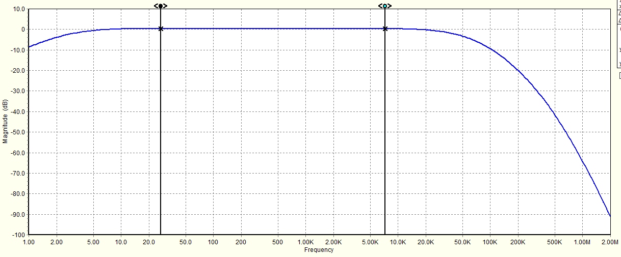

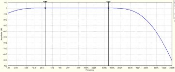

Since the SE and Balanced Aurak diagram was performing so well at first attempt, I changed the very fast LT6202 amps for the more mondain OPA1642 Fet amp.
Bandwidth is a bit less now, -1dB at 227Khz, but still more than excellent. When I add all 10pF, 22pF and 1.5nF caps being included in LD's and Brinkman's diagrams, it's obvious that these caps are castrating the perfect transfer function to -1dB at 27 Khz and should not be used.
The OPA1642 is stable as a rock as doesn't need these caps.
I also measured an excellent 71.8 dB A-weighted S/N ref 5mV@1Khz and notice that this figure includes the Cart connected !
Usually S/N is specified with a short circuited input, giving a much better figure.
Hans

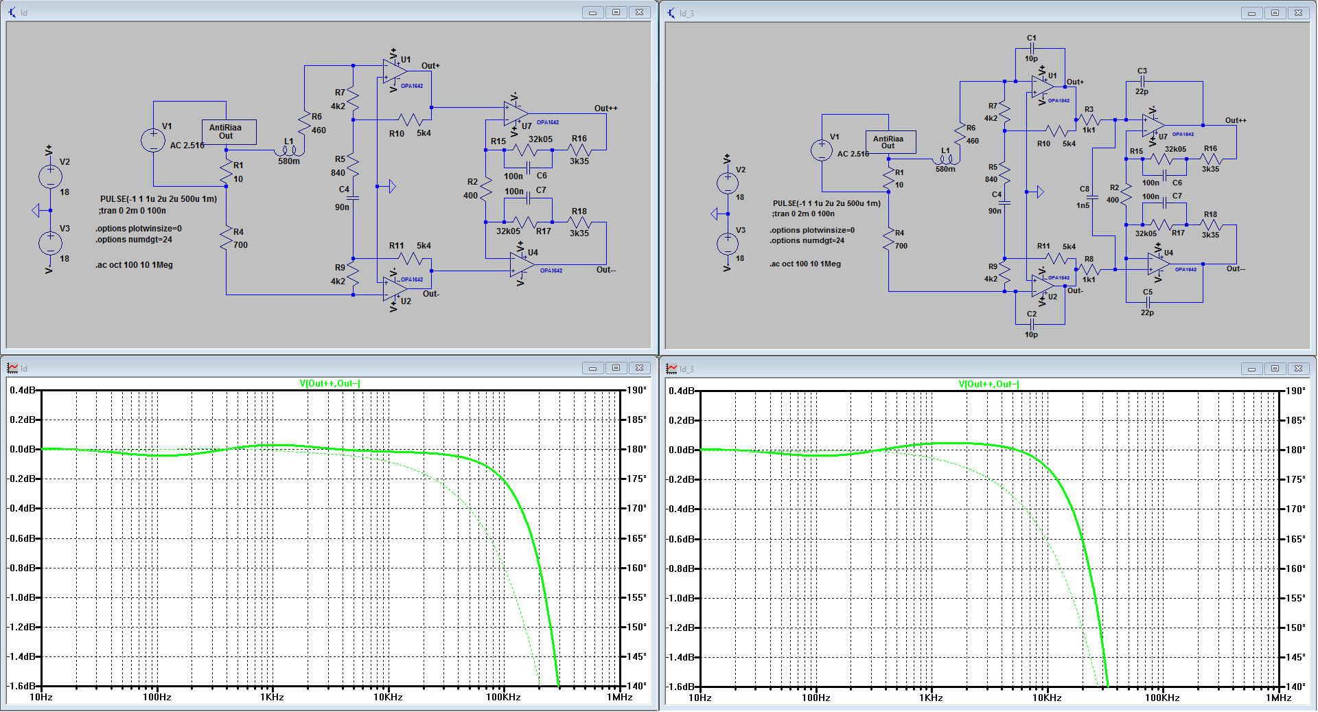

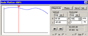

I simmed the circuit in Post # 204 by luckythedog & no matter what value i give for R, i always get a depressed mid ! What am i doing wrong ?
Can't guess, but for sure the simulation of the circuit as sketched should have a f response (transfer function) which looks like this, pretty much ideal...........
I just re-ran it.
It's devised so that total cartridge resistance (coil plus external series resistor R) in ohms needs to be twice the cartridge inductance in mH. Cute, I still think.
Hans

Agreed. These are MM carts too, hard to imagine perhaps.......
These look like Transimpedance amps.
So am I'm right in guessing this would give even better S/N on MMs than Doug's Virtual Reality Input Z? 😀
