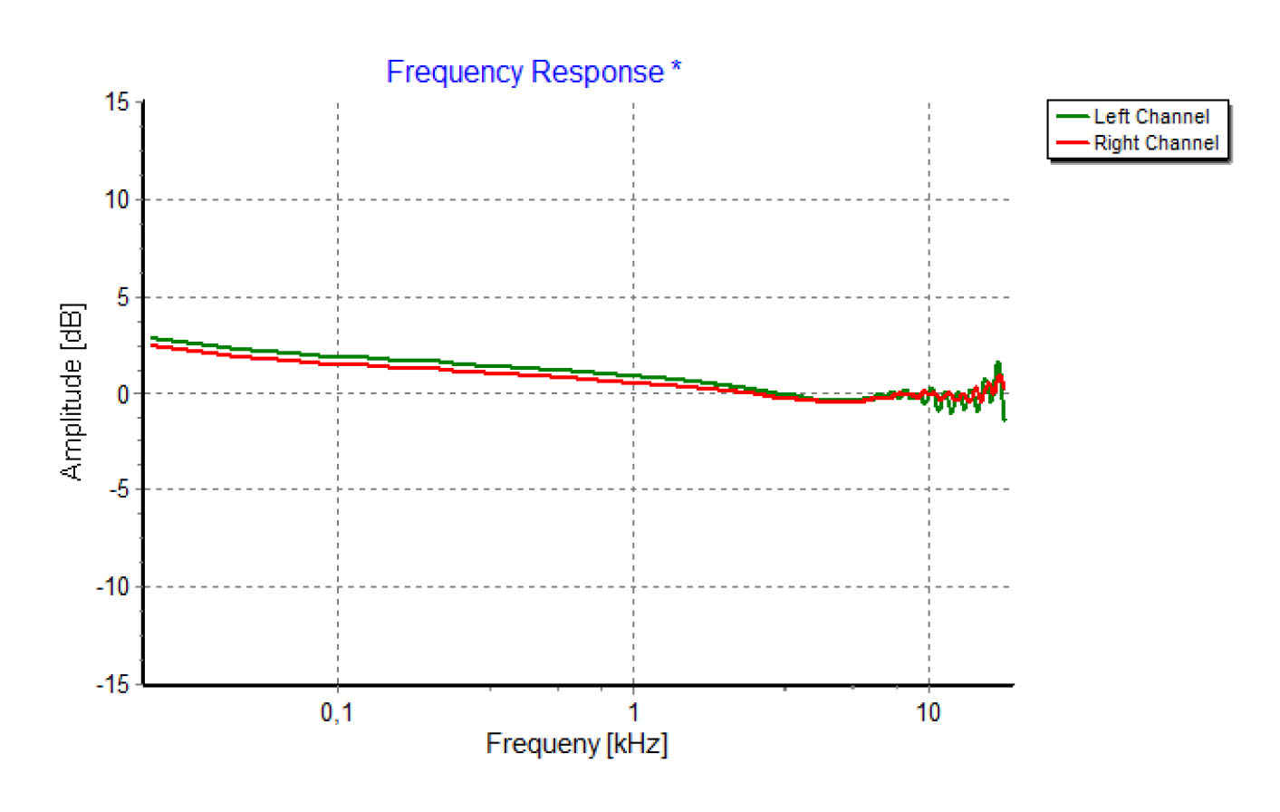

Does someone has any experience with Adjust+ from Dr Feickert.
Dr.Feickert::Adjust+
Adjust+ combines test software plus an LP with test tracks.
With my Benz LP I got the frequency response recording below.
I have no idea why at the upper end the response is going up and down, maybe because modulation is quite strong ?
Hans

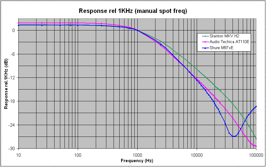

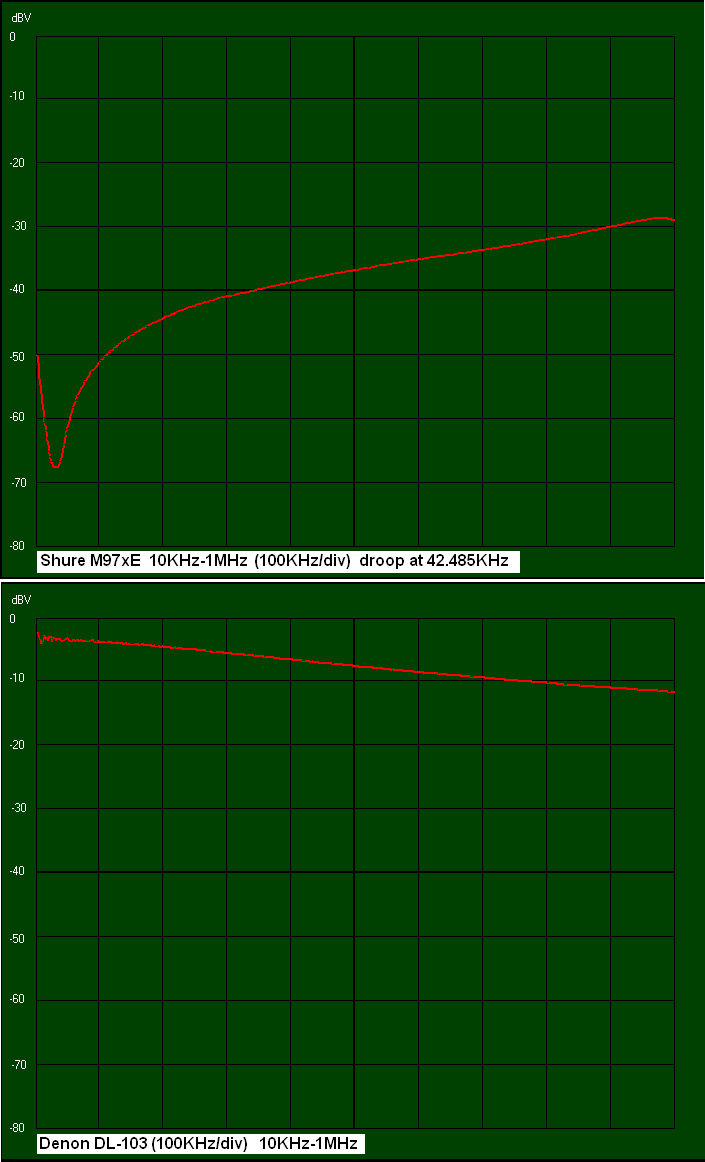

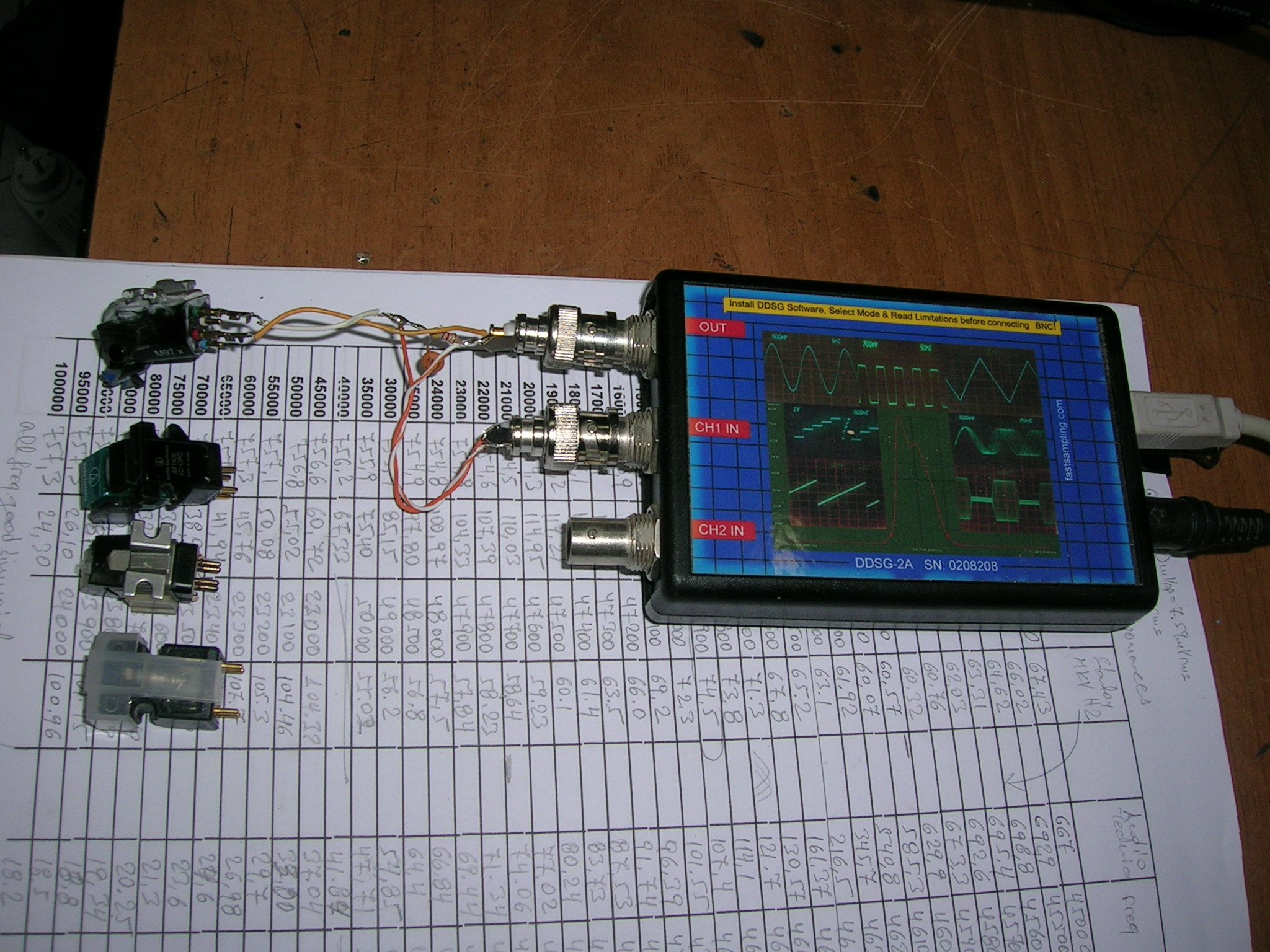

Now I have a digital signal generator and I can repeat the measurements in a much more consistent way and I will go higher in frequency.
Here is manual spot freq test and Auto frequency sweep (flat freq input, flat frequency processing. No RIAA pre-emphasis/ de-emphasis)
In both cases each cartridge is connected in series to a 50 Ohm signal generator and to the detector with a loading of 47KOhm//220pF. Interconnecting wire is 6cm twisted pair with a few pf capacitance. Detector input is1MOhm//47pF.
All measurements shown are with cartridges on air.
I’ve done many more detailed frequency sweeps on all the cartridges while touching the needle and the cantilever with my finger. No observed difference from the on air sweeps.
On the Stanton I removed the cartridge assy from the body and rerun the sweeps. Again no observed difference from the on air sweeps.
George
Thank you, George. It was puzzling to work out what might be going on! But looks from the photos and a quick sim to confirm like you're accidentally using a 470 ohm loading resistor rather than 47k? Plus, the loading, including the 220pf cap, is effectively in series with the coil.Here is manual spot freq test and Auto frequency sweep (flat freq input, flat frequency processing. No RIAA pre-emphasis/ de-emphasis)

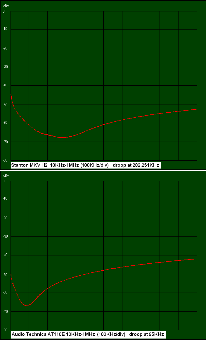

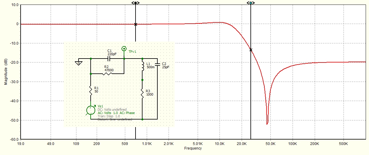

As to the odd resonance, seems what you might have accidentally measured is self-resonance of the coil in association with 220pf in series and whatever strays and self C are in parallel. Whereas, in reality, the topology is different, and all strays and loading C appear across the coil, so generator resonant f is far lower.
Nevertheless, interesting, particularly for the Shure cart where self resonance appears c 40kHz or so.
To 'repair' the topology, I think it may be necessary to unground the signal generator and measure directly across the coils. At present, you're measuring across the series loading, which might not be the intention.
LD
What I (almost) see as the load resistor is Yellow-Purple-Red which is 47K ??Thank you, George. It was puzzling to work out what might be going on! But looks from the photos and a quick sim to confirm like you're accidentally using a 470 ohm loading resistor rather than 47k? Plus, the loading, including the 220pf cap, is effectively in series with the coil.
LD

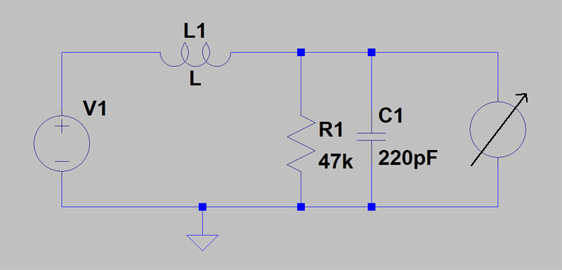

Measuring across the load is complementary to measuring on the coil. Vcoil= Vgen-Vload so to my opinion it makes no difference where to measure, so ungrounding the signal generator wouldn't make sense.
If this is the topology used, I do not see any problem.
![Test.jpg Test.jpg](https://www.diyaudio.com/community/data/attachments/555/555172-ba6b15196b5fd497395a7eb9e810e2ef.jpg)
Thank you Lucky and Hans.
The bloody resistor is 4.7K (yellow-purple-red). My eyes betrayed me.
I will run some of the tests again with 47K probably on Monday.

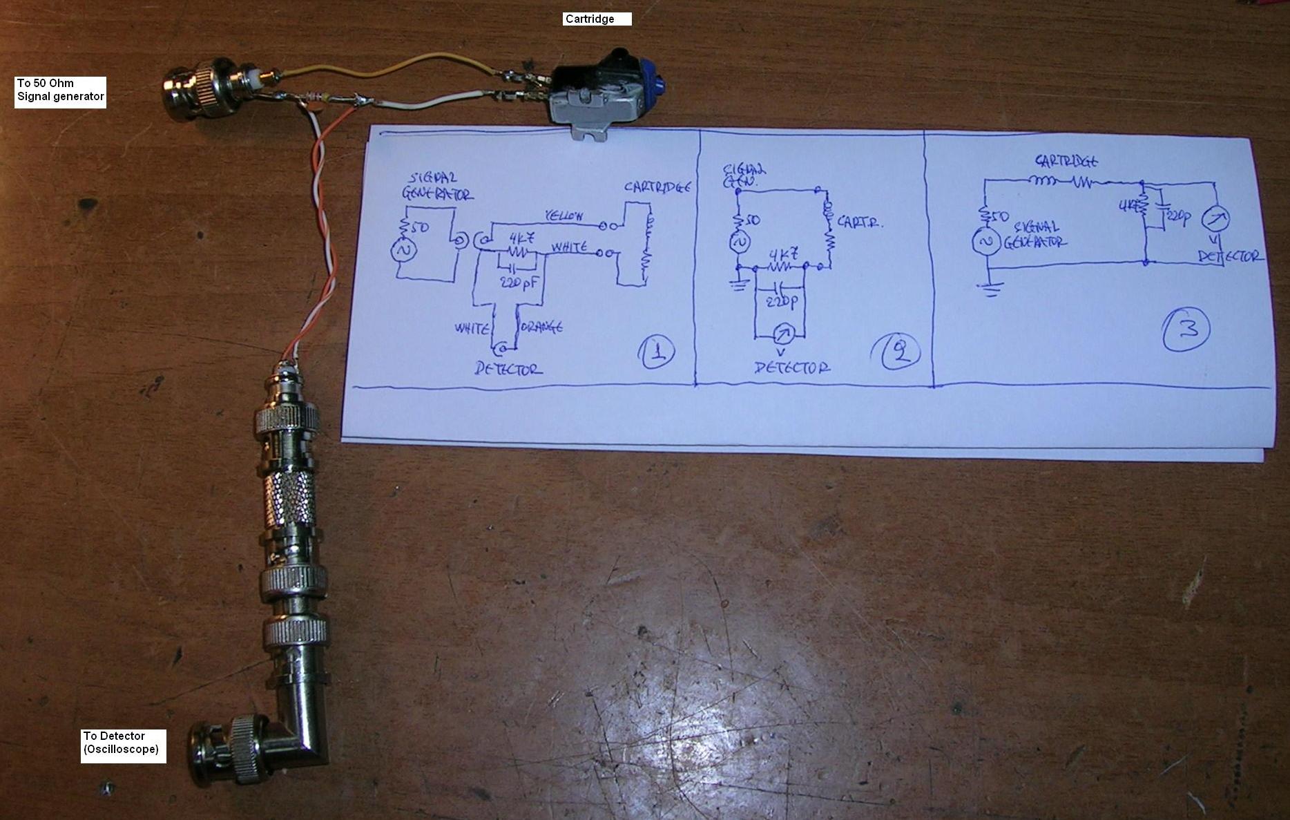

As for the way of jig wiring, the intend was to monitor the voltage across the loading elements, like Hans schematic.
Please see attached photo and commend.
No.3 should be the electrical equivalent of No.2.
No.2 should be the electrical equivalent of No.1.
No.1 is the drawing of the physical wiring as shown on the left.
The grounding is on the oscilloscope side. The signal generator is floating.
George

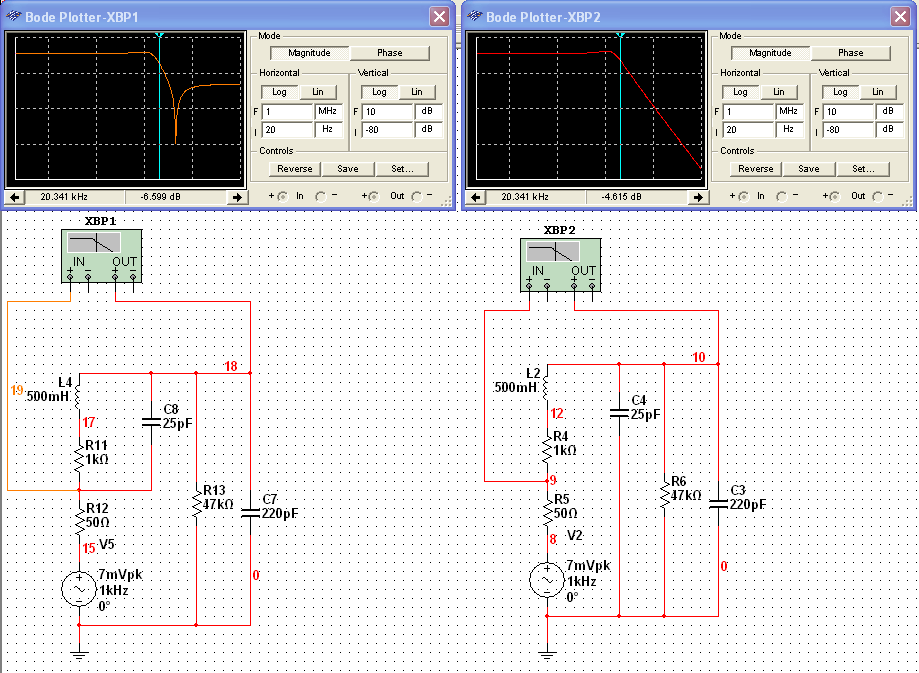

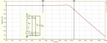

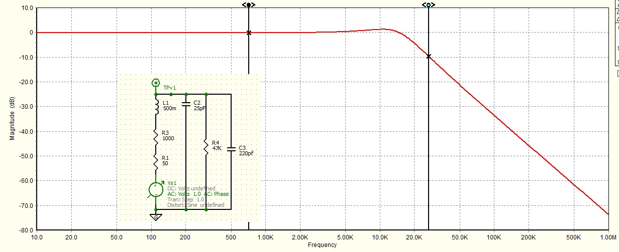

The resonance is very probably due to where you have the detector in the circuit. Attached are two plots inset with circuits: the first is as you have it, and includes 25pf for coil self C and strays. The second is more conventional and, I think reflects reality of where the voltage source and detector are during playback, in the context of the 25pf stray C.
I think you can see that the first case shows the coil self resonance, whereas the second case doesn't.
Nevertheless, it is interesting I think. As accidents can be !
LD

What could possibly be the reason to measure across the Cart, what extra information would be generated by doing that ?
The other way round, when the M97 shows a dip at 40Khz while measuring across the Rload, this would implicate that the Cart has an internal parallel capacitance of 25pF.
Hans
Hans
Well, I tried to build the second jig per the schematic of Lucky's post and I was short circuited. I ended up building the same circuit I already had built.
The reason is that there aren’t two approaches that can be physically implemented .
The physical difference between the two is fictitious.
The difference only exist in the world of simulation, i.e. where to connect the coil’s self capacitance of 25pF.
It is not immediately obvious but after taking the pencil and doing the rearrangement of the components on a paper, if we delete the coil’s self capacitance of 25pF, the two circuits end to be exactly the same, including the detector’s pick up point.
If we introduce the coil’s self capacitance of 25pF, at the first schematic of post #253, the 25pF capacitor is connected across the coil’s inductance and resistance.
At the second schematic of post #253, the 25pF capacitor is connected across the coil’s inductance, the resistance and the voltage generator.
These different options can not be realized in a test jig, as the coil’s self capacitance is part of the cartridge internal construction and can not be tapped from outside.
So let’s have the real world measurements guide us as to where the coil’s self capacitance is to be connected in the schematic for to achieve a realistic simulation.
George
