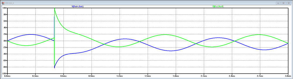

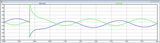

I experimented a bit further with static discharge pulses and found an even better protection, this time with 8 diodes.
This time I included 100pF cable capacitances on both sides of the cart and placed two 0.56pF caps from output to input over the first OPA1632.
As with the previous image in #436, what you see is the output from both 1632's.
A 20KV 1usec pulse was injected on one side of the cart from a 200pF cap with a 2KOhm in series, simulating the human body.
At the same time a 1KHz signal was being processed.
Current through the Cart never exceeded 10uA during discharge.
I think that this is as far as you can get when having to suppress really large voltage spikes.
Hans

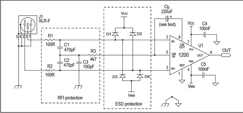

Hans, any reason why you didn't strap to the power rails? I've always followed the advice of Bill Whitlock in these matters (attached the esd circuit for the THAT1200 which I used in some places in my system). I realise your method doesn't rely on the power supply caps to eat the impulse but are there other advantages?
(LD: I know you have moved on from this, but for me it's interesting to explore around the topic and educational as well).
Bill,
The protection with 4 diodes to the power rails you are referring to are already part of the OPA1632.
That's why I believe that for normal use you don't have to do anything at all as far as protection concerns.
And that to my opinion is the very reason why Russ has no provision for extra diodes.
Whenever you are afraid for huge static charge build up in your environment, these 4 diodes are no longer capable of preventing a disaster.
On top of that both inputs should stay within a few volts to prevent damage.
So in case of severe static discharge, damage can only be prevented by inserting a whole series of diodes.
IMHO this is all a bit over the top, but as I have shown, even 20KV 1usec pulses can be kept well under control.
Hans

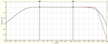

LD had earlier thought that the SE Aurak could handle 'something exotic' Got me thinking along those lines. Though the current Hans circuit measures exceptionally well using the 1642/32s.

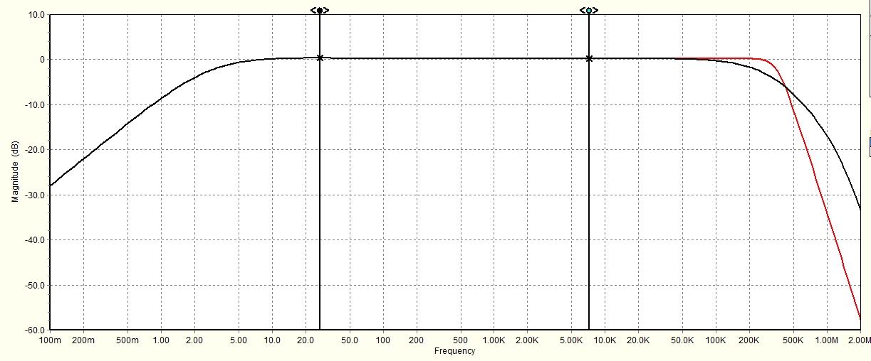

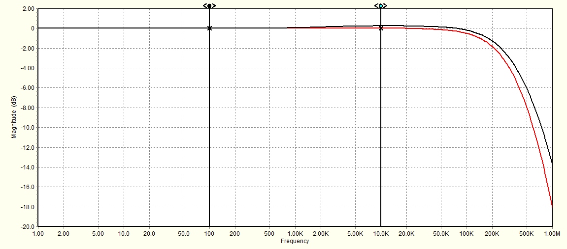

Yes, both SE and balanced Aurak versions can handle high GBW op-amps. However, as Bill points out, there's not much advantage above 10MHz GBW for either SE or balanced versions of Aurak. IIRC the use of a 1632 arises because there is a 'close cousin' pcb already laid out for it which is presumably field proven, and high GBW op-amps need good layout or throttling back to be stable of course. And it's fun !
Here's some sims of 10Mhz GBW versus 180Mhz, for balanced and unthrottled SE versions of Aurak. The SE version is 'unthrottled' by removing C13 and reducing C14 to 2pf in the 3.0 schematic sketch, which personally I include to ensure stability in prototype layouts.
LD
