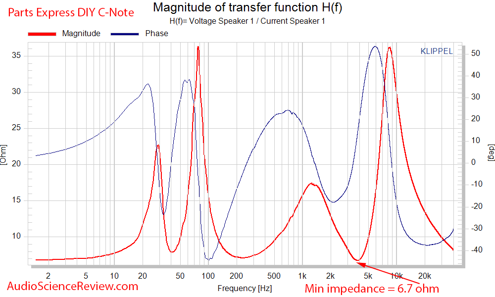

I've got these drivers and would love to give the build a shot. curious about thing. I had the drivers in the form of the cnote kit but the tweeters filter impedence caused the hf to rise dramatically on all my cheap class d amps. I believe it was due to the amps having load dependency, the speaker was unlistenable until one used a good hypex or class a/b amp. I wonder if this filter in the mechano22 would pose similar problems.
I ran into three different amps, all budget class D that gave me the problem, aiyima a07, smsl sa36, and some fosi model. Took forever to figure out what it was as, even had the speaker sent to PE where they verified it was fine. I made a thread here to figure it out but everyone who commented was wrong sadly and said it was my mic and that I don't know how to take measurements....
The amps do this, couldn't listen to the speakers, hurts your ears and sounds broken.
Then I got a crown xli and all was well, great sounding speaker after that. So yeah it'd be cool if one could flatten out the cnote tweeter impedance. That or I just get another a/b amp of which there aren't many cheap ones it seems.

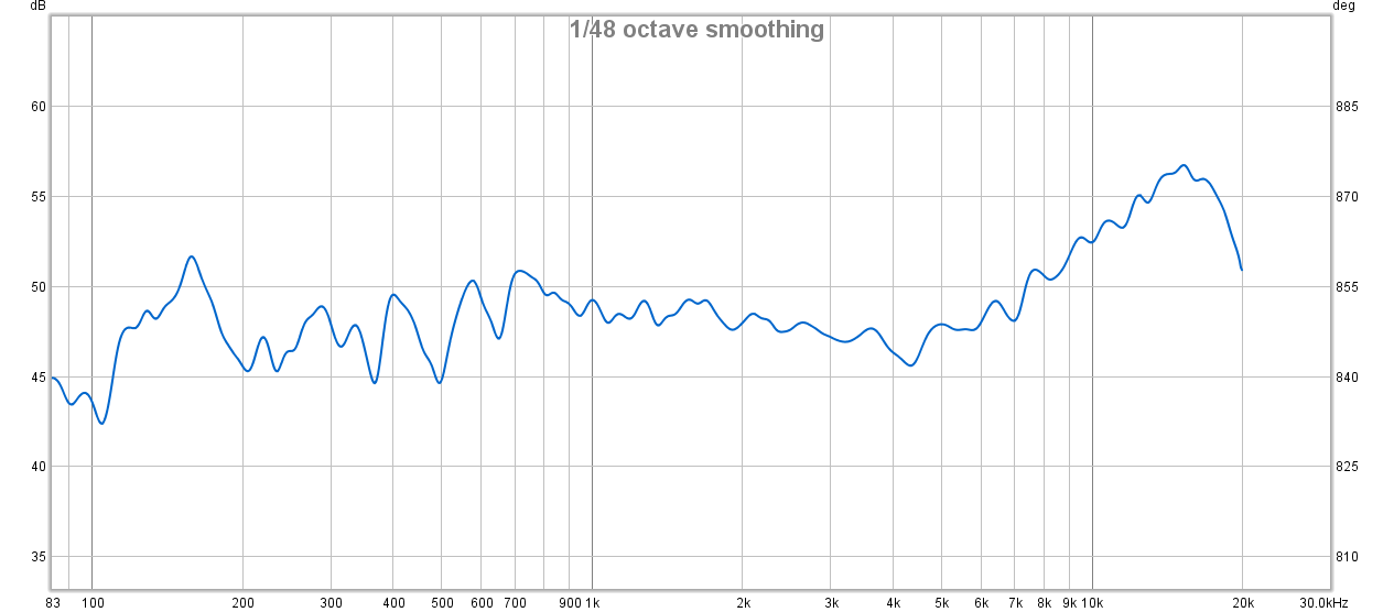

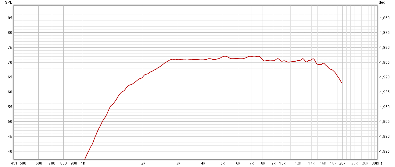

actually you'd be incorrect there. I'm currently using the tweeter in another speaker that is active using the same amps and it does not exhibit the hf issue. it's entirely down to the xover + this tweeter and it's interaction with load dependency. I have data showing each component added one by one and you can see when the issue presents itself, I forget where it happens but I've got the info on imgur.

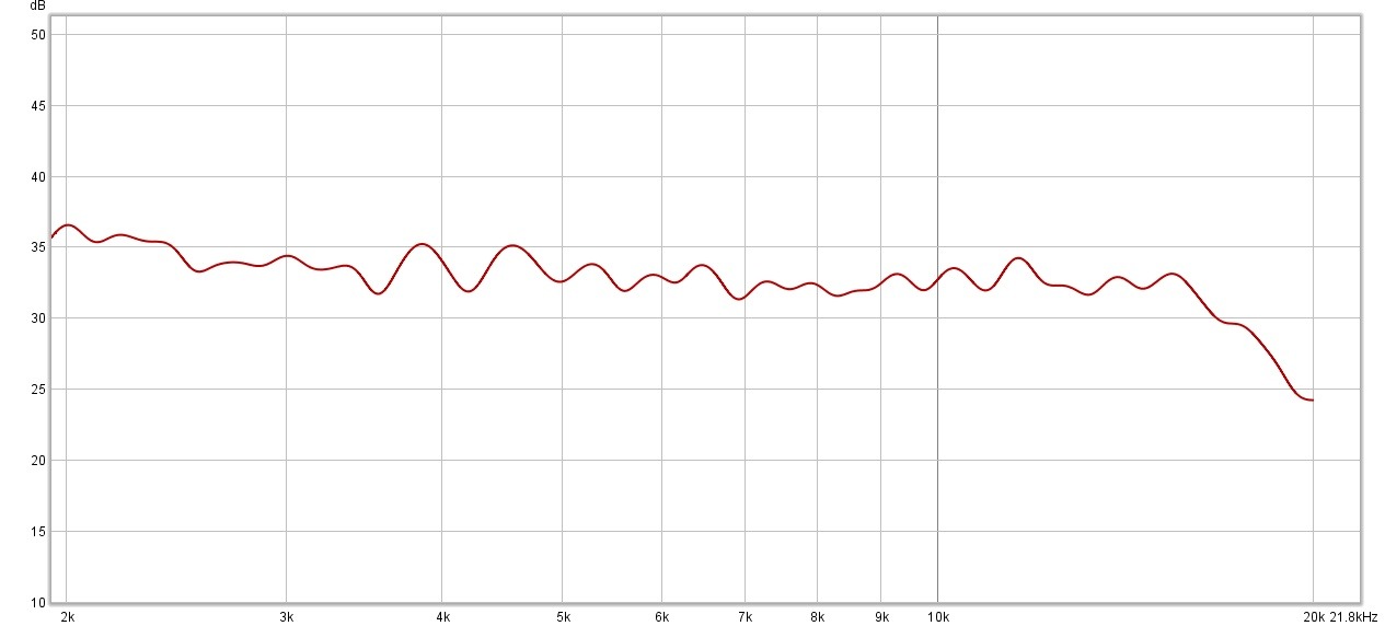

Here's the tweeter in my other speaker with a simple active 2500hx hi pass.

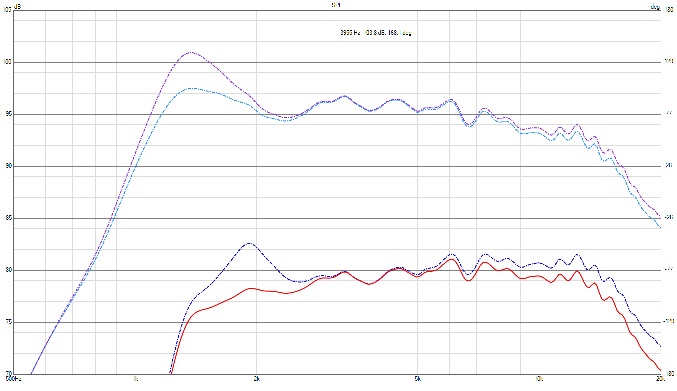

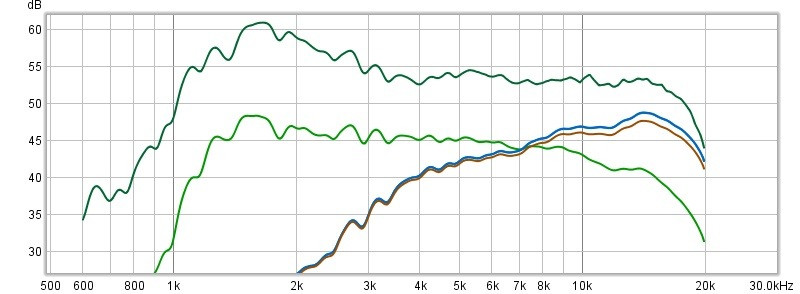

Here is the one by one component adding I mentioned. Some of the measurements overlap so it's hard to see. I believe it looks like once the inductor is added it freaks out.

Thanks for this, I didn't see your edit before.Here is the one by one component adding I mentioned. Some of the measurements overlap so it's hard to see. I believe it looks like once the inductor is added it freaks out.
Can you describe what each trace shows you adding and do you use the ND25FW-4 tweeter?

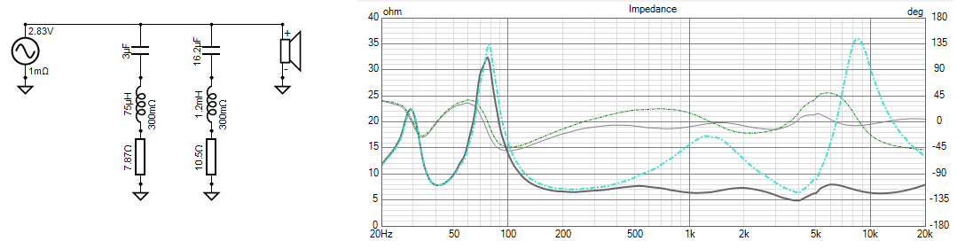

I couldn't reconcile the pattern, so I showed the effect of amplifier output impedance. I took the Dayton tweeter factory impedance and response data and simulated it with and without crossover. Voltage source and with 5 ohms output resistance. The traces are then level adjusted to help show areas of frequency response variation for active and with crossover versions. If your amp has a smaller output resistance, the areas will be the same only less variation.
