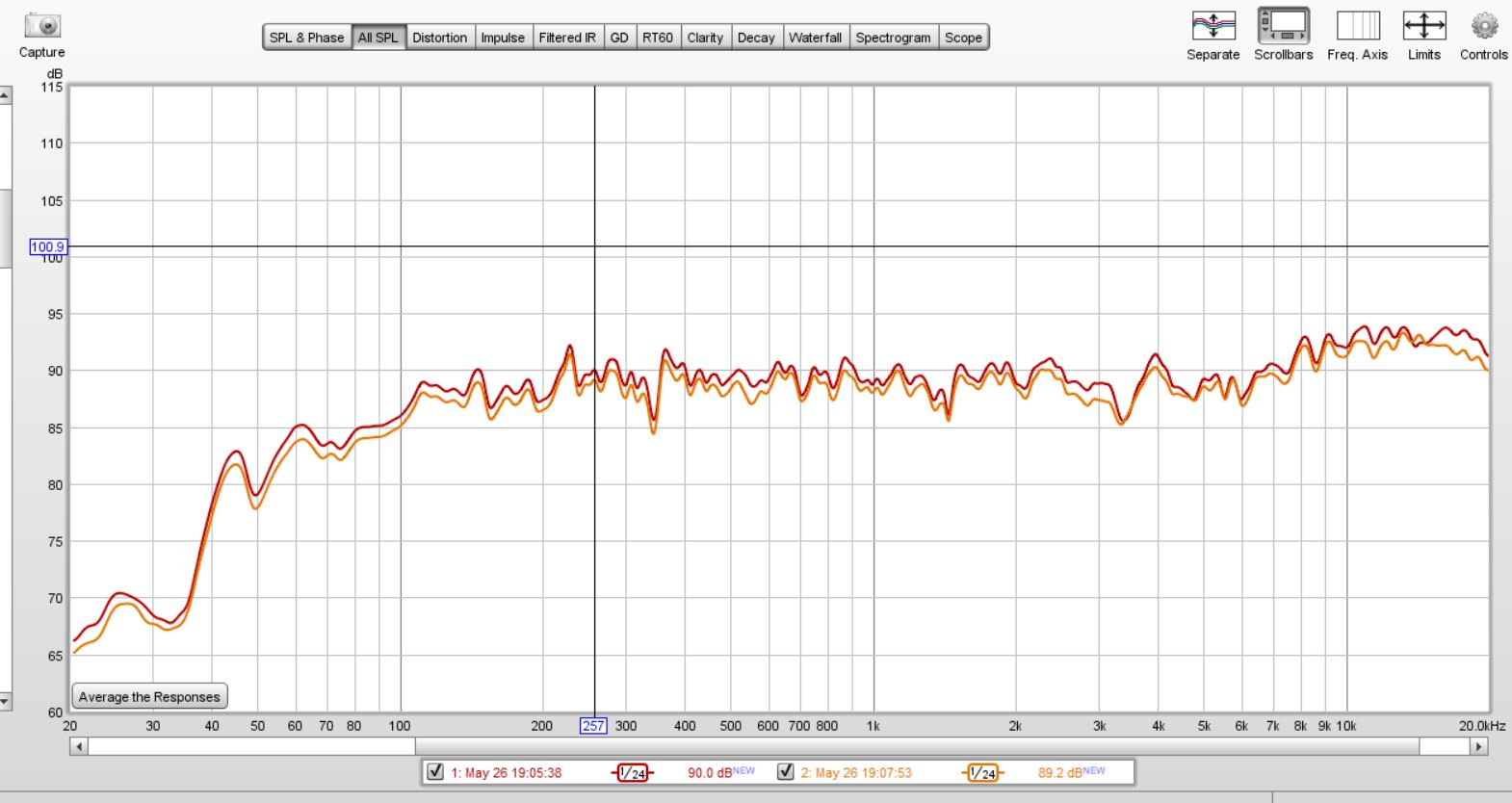

I agree it is bad, and seems like it's a result of keeping things cheap. I complain about it a lot on ASR in hopes the amp makers who sometimes join in the discussions start implementing designs without it.
Here you go AllenB, I was pointed to this thread when I was trying to diagnose the problem. There is some stuff in there that is beyond me, but one user states it's due to a lack of post filter feedback in the amps. I have no idea what that is but just some info to go off of.
https://www.audiosciencereview.com/...and-fr-into-complex-speaker-dummy-load.21682/
This is some data from another user on ASR who ran in to the same problem. I guess the blame really lies with the amps but these speakers are likely to be used with cheap class d amps so I wager a better solution is to create a xover load that doesn't present problems for the amps.

I haven't read the whole thread but there doesn't seem to be a comparison between a resistive and reactive load. Either the issue is or isn't fixed by using a resistive load. Furthermore either the issue remains the same over different conditions or it varies.one user states it's due to a lack of post filter feedback in the amps.
In other words it looks like either you can fix this with an equaliser or you need another amp.

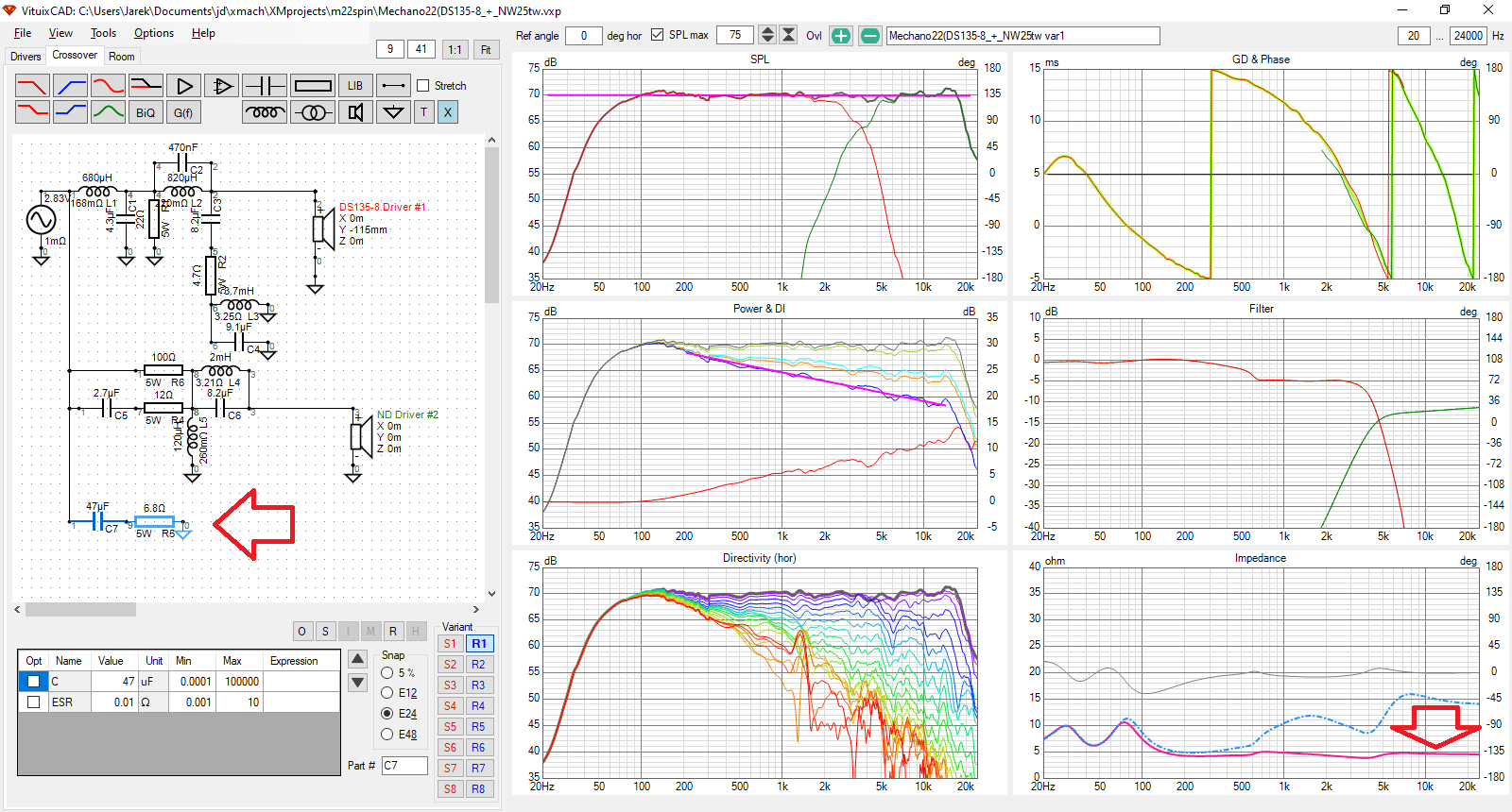

I've got these drivers and would love to give the build a shot. curious about thing. I had the drivers in the form of the cnote kit but the tweeters filter impedence caused the hf to rise dramatically on all my cheap class d amps. I believe it was due to the amps having load dependency, the speaker was unlistenable until one used a good hypex or class a/b amp. I wonder if this filter in the mechano22 would pose similar problems.
Impedance variations are smaller in case of Mechano22 than in case of C-Note, so the issue of load dependency should be less noticeable (but not non-existent). The situation can be improved by adding a 6.8R and 47uF compensation branch, see the picture. With this modification you can get 4.4ohm +-0.5ohm for f>150Hz, which should be ok for most class D amps.

I have only used HF filter version with the 100 ohm resistor and it doesn't seem to cause any problems.What was the consensus on the 100ohm resistor on the woofer?
Even though the crossover is a bit complicated there was no problem to put it in the enclosure which is approximately same size as C-note. Some flexibility with mounting can be gained by splitting the LF and HF on separate boards.Xover looks quite large and maybe tough to fit in the cabinet.
The crossover is designed to deliver flat SPL and Power Response characteristics. But the front baffle used is different than in C-note. You likely won't get exactly the same characteristics if you use C-note front panel.
According to my bills, I payed c.a. 100USD for xover components for pair of speakers. But it was more than year ago and also prices in my country could have been different. Anyway, check if you're looking for right components. For example 3.7mH and 2mH coils are wound with a thin wire (intentionally high esr) and should not be very expensive.but the xover is quite expensive to source, over 200 USD
You probably still have your C-note xover. Try some RC impedance correction (something like shown in #68) for better D-class cooperation and maybe you're done. C-note is not so equalized (as Mechano22) but it still sounds good according to many opinions.I wonder if the software can come up with something cheaper.
