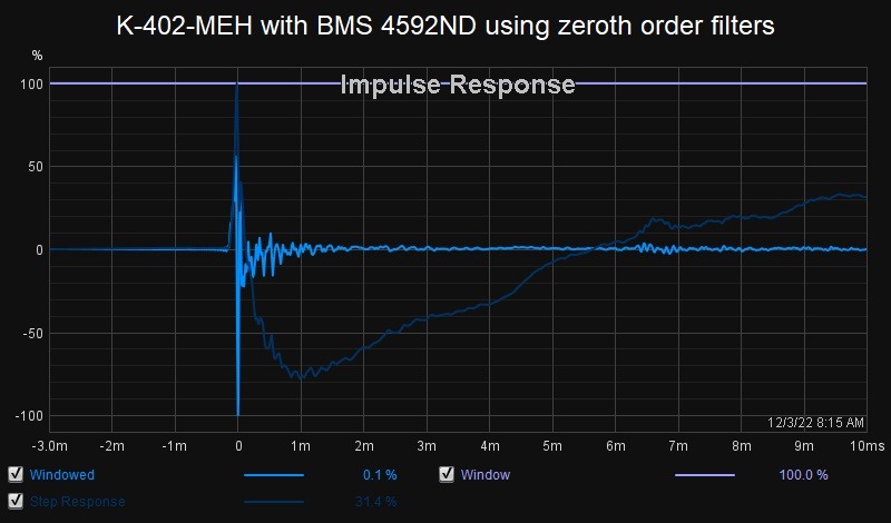

Well, in my case using steep linear phase xovers, as long as I have solid f-3 response at xover frequency, I've found i don't need to be concerned with response further down, at all. Look at the xover on latest build between sub (blue) and main-low (orange) at 100Hz and you'll see what i mean.I think the thing to keep in mind is you still want a good octave or two of solid output below the frequency you want to cross at otherwise when pushed to higher power levels things might not sound so great.
![syn11 dcx first tune 1m.JPG syn11 dcx first tune 1m.JPG](https://www.diyaudio.com/community/data/attachments/1059/1059854-d022fc2f4516766558cd7cdf13c2b45b.jpg)
That's for home use, when FIR delay can be tolerated.
For live sound when delay can't be tolerated, I wouldn't have concern with more than an octave of overlap, mains to sub.
Because then I shoot for an acoustic 4th order xover, down 24dB at one octave.
That's going to take at least a second order electrical xover, where voltage required one octave down is 1/4th, and power is 1/16th. If it takes a 3rd order electrical, of course halve those numbers....getting down to nothing iow...
So I just can't see that the low-main driver is being pushed much,( or really providing much output) past an octave down.
Maybe solid output is required two octaves down if someone is trying to achieve a second order (or first, yikes!) acoustic xover, sub to main.....
but to me that idea seems completely at odds with a speaker built for higher SPL.

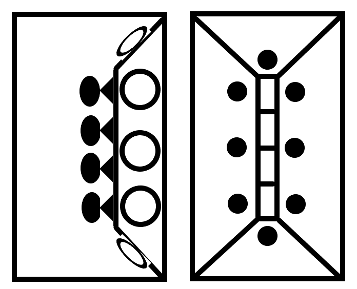

Multi compression driver is required if you need more output than a single compresion driver can provide (live mic'ed cymbals come to mind as difficult material). The large coaxial ring radiator drivers are more efficient than normal compression drivers so represent the greatest single driver output posible, if this is enough for your application it will be higher fidelity than an arrayed HF solution. Even the J7 has a far from perfect frequency response with lots of resonances in the HF, this is the price to pay for combining multiple HF drivers. Easy to work from the expected sensitivity, power handling, audience distance and target SPL to see what output you need from the box and if a single driver can manage it.

Well, in approximate numbers for example, a 20" square = ~13543/80 = ~169 Hz, shrink it to 10" = ~338 Hz, so your call versus a larger horn/mid-bass two way cab with either passive or digital time delay.Is there a small size MEH? Something below 20" wide
Or that's just no benefit to go for MEH if the size is not big enough?
