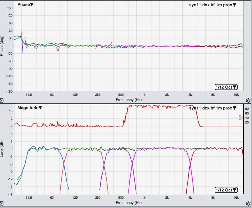

I think the thing to keep in mind is you still want a good octave or two of solid output below the frequency you want to cross at otherwise when pushed to higher power levels things might not sound so great.
Well, in my case using steep linear phase xovers, as long as I have solid f-3 response at xover frequency, I've found i don't need to be concerned with response further down, at all. Look at the xover on latest build between sub (blue) and main-low (orange) at 100Hz and you'll see what i mean.
That's for home use, when FIR delay can be tolerated.
For live sound when delay can't be tolerated, I wouldn't have concern with more than an octave of overlap, mains to sub.
Because then I shoot for an acoustic 4th order xover, down 24dB at one octave.
That's going to take at least a second order electrical xover, where voltage required one octave down is 1/4th, and power is 1/16th. If it takes a 3rd order electrical, of course halve those numbers....getting down to nothing iow...
So I just can't see that the low-main driver is being pushed much,( or really providing much output) past an octave down.
Maybe solid output is required two octaves down if someone is trying to achieve a second order (or first, yikes!) acoustic xover, sub to main.....
but to me that idea seems completely at odds with a speaker built for higher SPL.
