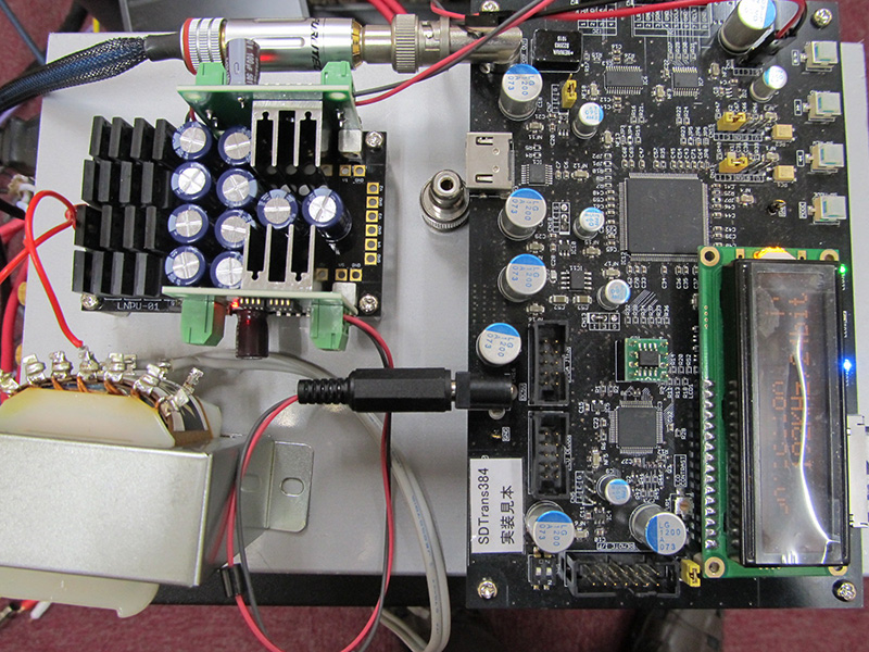

Finally I could try my SDTrans384 with LifePO4.
Connection is like this:
Single 3.3V LifePO4 -> CN1, CN5, CN7
Single 3.3V LifePO4 -> LT3045 LDOVR -> 2.5V -> CN10
-> LT3045 LDOVR -> 1.2V -> CN13
I got sound via I2S to Soekris, however Nothing is on SDTrans's LCD. Anyone can advise where should I check? Or I still need 5V power supply for LCD?
Thank you.

Hi Sumotan, after feeding 5VDC, the LCD is up.
So now the the SDTrans384 is running with both LifePO4 and 5VDC shunt. It is not the thing I want but there is no solution yet.
I got one issue is suddenly Soekris DAC output level is very low, so have to deal with it first, before keep exploring the SDtrans.

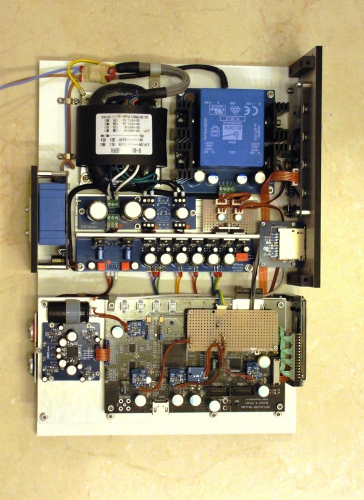

A friend who owns a SDTrans for years wants to have the same treatment as I did to the DV20A :
https://www.diyaudio.com/community/...crescendo-ii-ak4495-dv20a.285630/post-6094886
So here it is, only waiting for a proper case.
DAC is a choice of AK4493/5/7 with a common PCB layout.
Patrick
