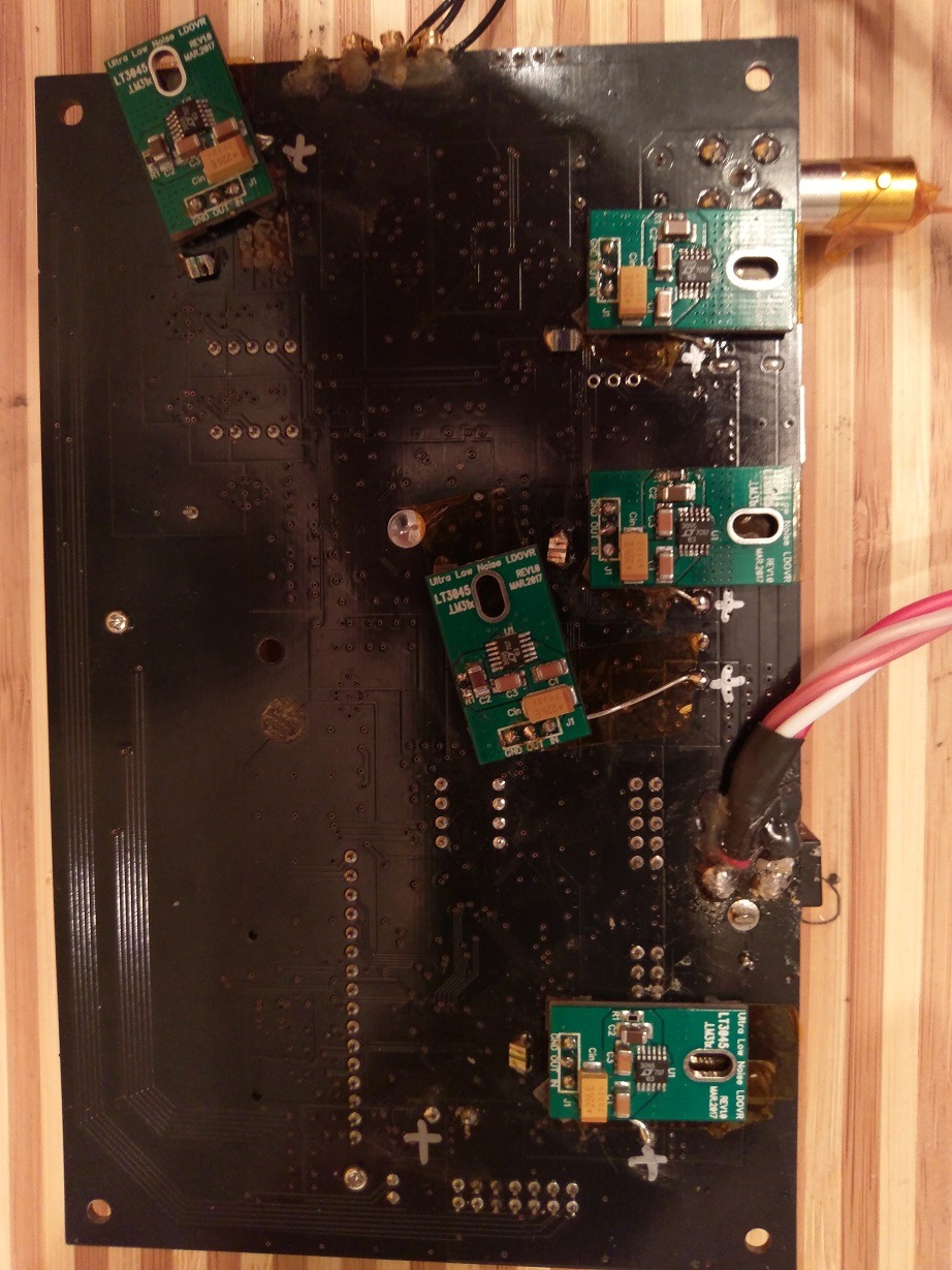

I have 2 SDTrans384, one modified with LDOVR.com LT3045 regulator boards mounted at the defined connection points for external power under the SDTrans384 board to keep the connections short (see pic). I also removed the stock reg chips from this board, not recommended as if any problem occurs, I doubt they will service it.
It was a definite improvement with the modified Soekris DAM 1021 attached to it. ALSO I am trying out one of the new Gustard R26 R2R DACs using my SDTrans384s as sources via I2S-over-HDMI and clearly heard an SQ lift swapping from the stock to my modified unit.
Also, as I suggest above, I suspect using IanCanada's FiFoPi Q7 fed from the I2S pins with his HDMIPiPro on top would be a better output than the stock HDMI circuit on the board.

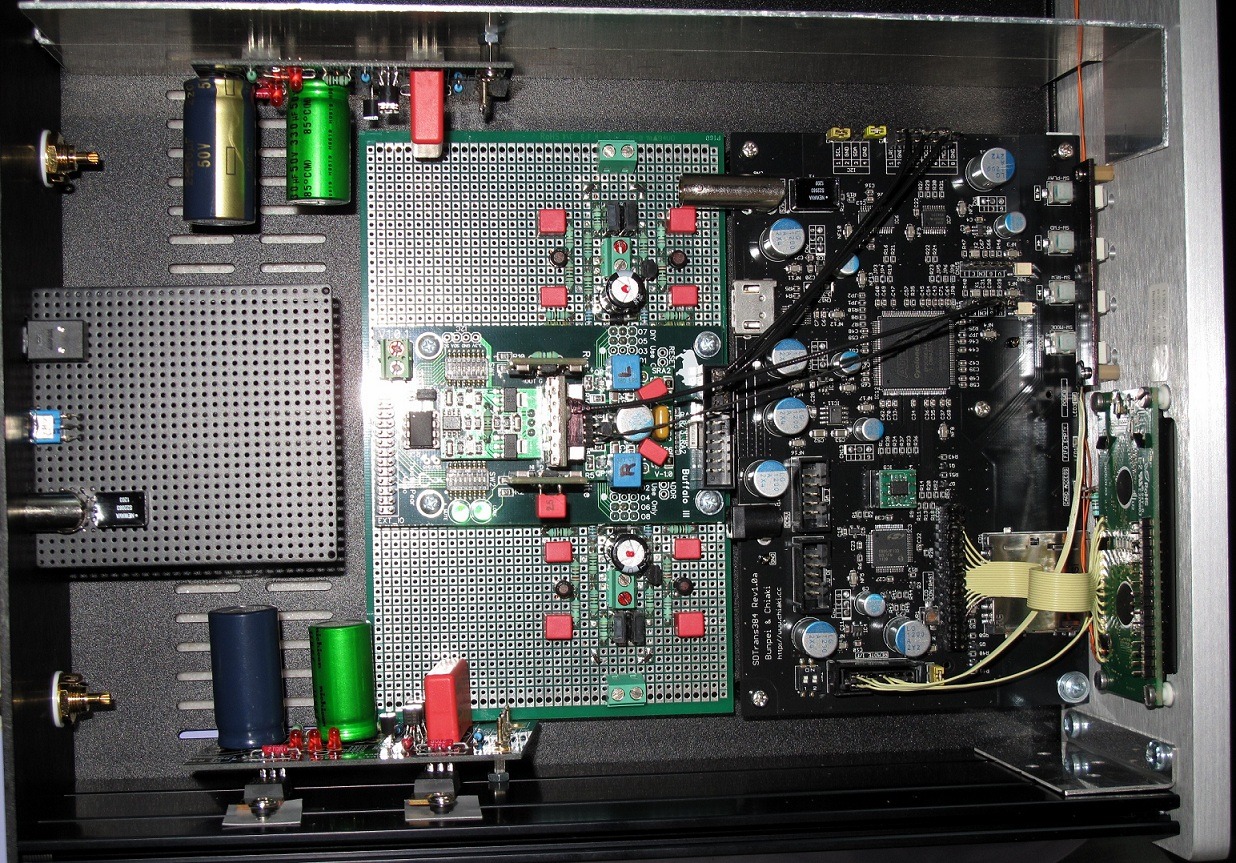

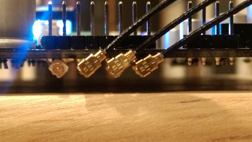

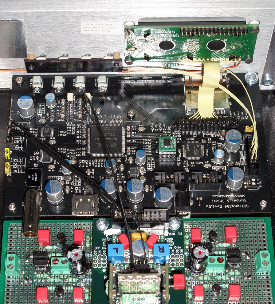

On remoting the display, I have not, but there are at least two implementations showing the display remoted. I believe one or both are earlier in this thread, but one may have been in one of the Twisted Pear Buffalo DAC threads as that is the DAC shown in the picture.
I saved the pictures from each, I am reposting the ones with the Buffalo DAC as it shows the most details.
Greg in Mississippi
P.S. I should add that I'd keep my u.fl connections MUCH shorter than shown here, based on experience. My SDTrans384 > Soekris DAM 1021 has <2" u.fl lines with the input side of the DAC board mounted up against the I2S output side of the SDTrans.
