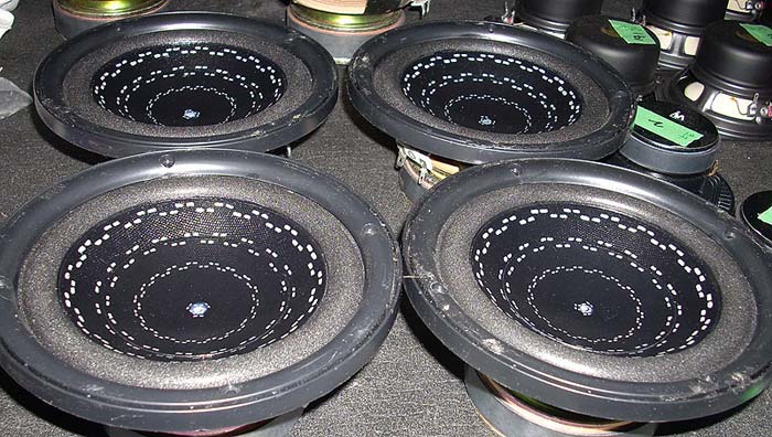

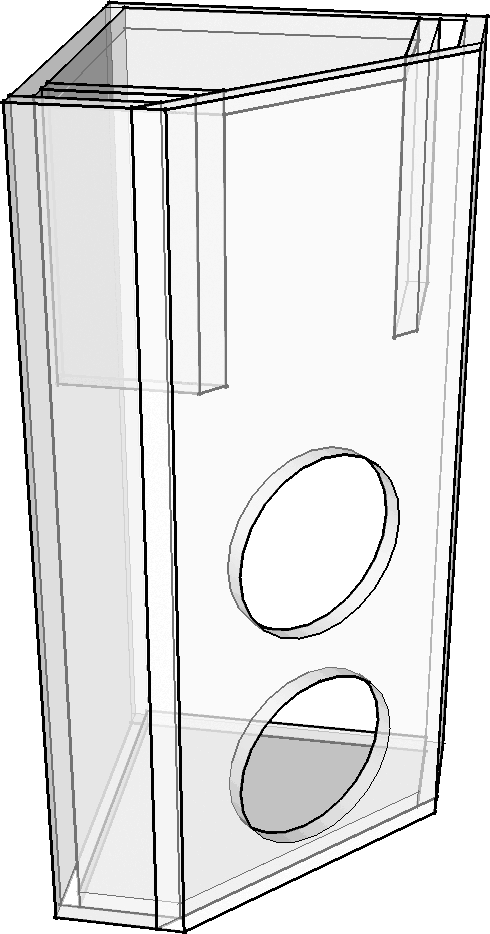

My system runs Alpair7 Pensil for mains, Alpair7 in small vented enclosure for center, and a pair of triangular corner mounted enclosures each with 2x 8" woofers, powered by a Rotel power amp off the receiver's LFE channel. (I've still not been motivated build and install the nifty little surrounds that Dave has sketched out). The largest FR speaker I presently have in the house are Fostex FE167E in a floorstanding enclosures, which are no slouch themselves, but when run as "large mains/no sub" they simply can't come close to the dual "subs" and Alpair 7 combo. More musical? perhaps, but for movie soundtracks theatrical effects, etc., they run into serious problems of distortion, congestion, and the imaging of the front row falls apart.
Maybe that big. A tad bigger than SDX7. Salvaged Eastech OEM units made in Malaysia, and optimized for LF duty (they were XOed at 200 Hz, in their original life).
I've not heard them yet, but being a pair of pairs corner loaded they should perform admirably, and with the basically retangular room, create fairly even bass room-wide.

Note, the woofer enclosures have been inverted from Dave's sketch - i.e. slot ports downfiring, with the enclosure sitting on a 4" high kick base ( WAF strikes again)
Yes, considering that the front corners are the only suitable locations (one behind a folding shoji screen, and the other a large potted palm), the bass is fairly well distributed.
