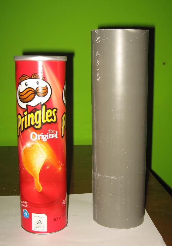

Thank you GM for the math.
And Dave thanks for incorporating it into a nice "changing port size for dummies" format...
Now I have no excuse to delay the port measurement and subsequent installation! My candidates - one slightly over 3 inches in diameter, one slightly less.
-Zia

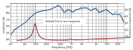

I have another theoretical question, this one regarding BSC for the EL70 MT.
It has been said that a bipole arrangement mitigates the presumed need for a BSC that a monopole with the same driver/cabinet would call for. However, this being a MarkAudio driver, there is an engineered increase in output (from ~ 200-500 Hz with the EL70) to approximate a built-in BSC.
So, in theory, would this bump be prominent when playing music? Does anyone recall experiencing such a coloration when listening to music through the EL70 MT's?
I know I'll probably be tweaking with my MT's in-room response after I have them playing, but I'd like to get some anecdotal perspectives, too.
Thanks!
Marc
