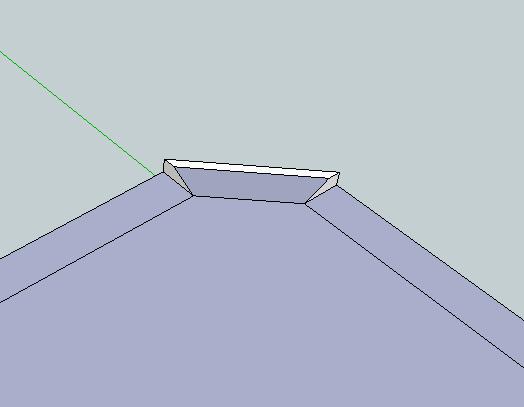

Cute design - my only concern would be diffraction effects from the extended panels making the side bevels.
Oh, just the extended portion, yeah I was wondering about that myself. I originally drew them extending a full inch above the top, in subsequent drawings I've reduced them to 5/8 for that reason. I could reduce them even further if it might help the sound.
Perhaps they could be chamfered on the inside?
Easy for you to say 😱
Actually, I think I could handle that. If I cut the bevel on the end before I beveled the sides of the strips it should work fine.
Something like this:
yup
