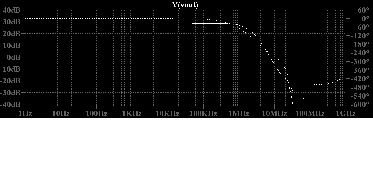

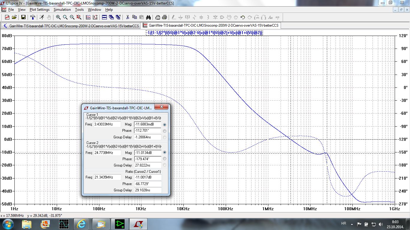

What do you think about this Loop Gain, it is from the CFA, asc file attached, Bode Step to pronounced?
BR Damir

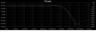

What do you think about this Loop Gain... Bode Step to pronounced?
Hi Damir
When any kink in the loop gain is -10 dB or more down then it is not really a problem.
The check is the amplifier response, there is a little bump but it is well below 0 dB so no cause for concern.
But as a rule of thumb, I try not to have the loop gain plot actually peak after the ULGF, I just want it to flatten but not climb back up.
I don't have a mathematical justification for this, at the moment, it just seems reasonable to me.
So I would flatten that Bode Step just a little.

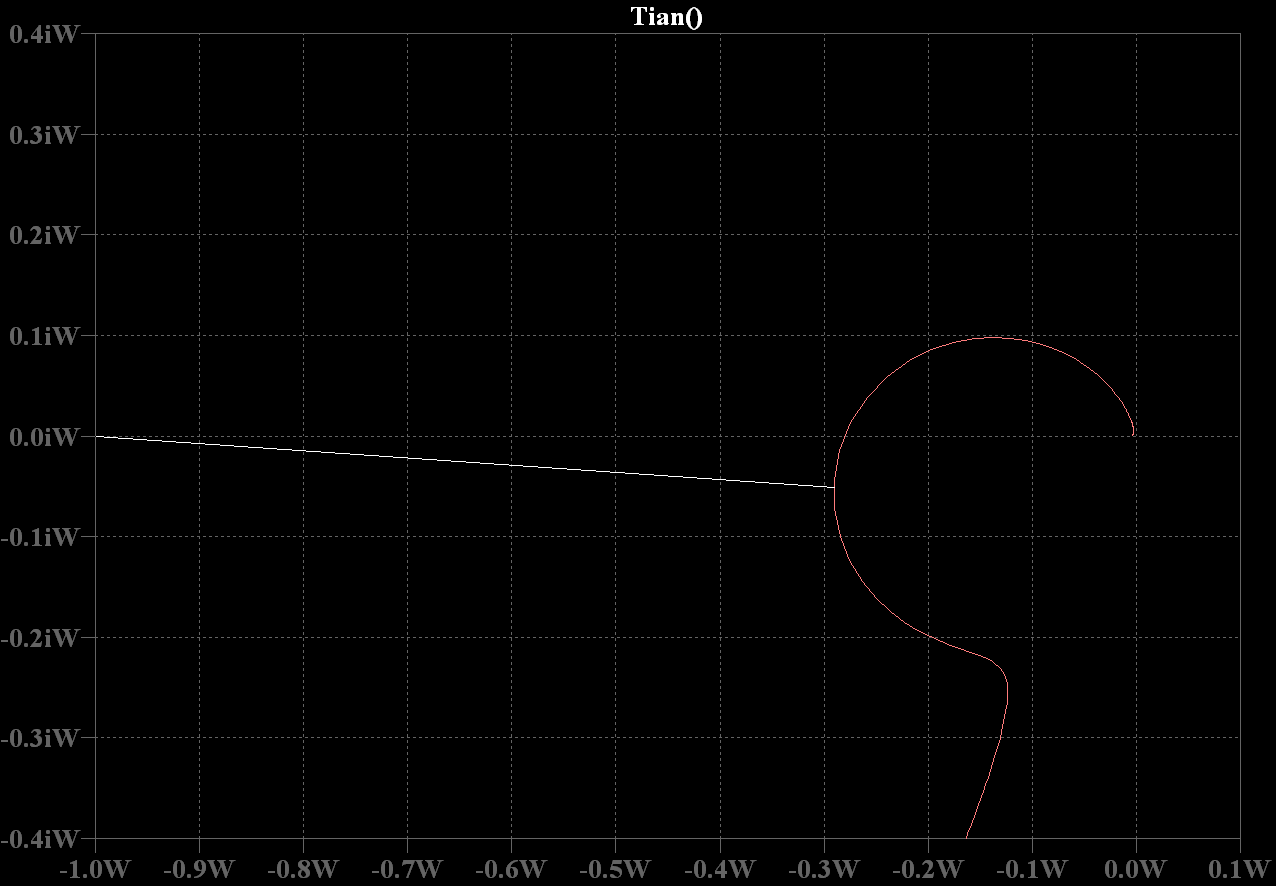

David, this is Nyquist plot around point zero, it looks strange but do not encompass it !
BR damir
I didn't mean to scare you, what you have is pretty solid.
That spike looks bad but is actually not a cause for concern.
In fact, there are even some potential benefits there.

No! We are suspicious of bumps in the input-to-output response of the amplifier, often called the closed loop response.
That name can confuse because people assume we want the response of the loop itself to be smooth.
But the optimum "loop gain", better called Return Ratio, is not a simple line!
Bode showed this in his book back in 1940 (I don't want to be repetitious but I really recommend it).
This is similar to my comment to Paul that his concern about the peak is also mostly unwarranted.
This goes against my instincts. See peaks in plots as warning signs. But this is probably wrong. What are the warning signs in open loop responses apart from meeting the conditions for oscillation?
EDIT: I see you have already answered this for Damir...
Exactly. We put the step in precisely to raise the phase peak and improve the PM.

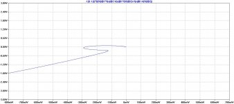

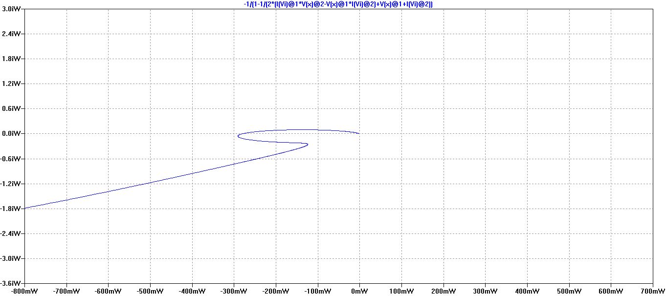

I think it is best to set the real and complex parts to the same scale.
Then you can easily see the closest point of approach because it's just a circle centred on (-1, 0i), and I have drawn it in white.
Note that it is not at 180, which would be a level line.

What means if that line is not in level?
Only that the worst case is not at 180.
So the GM, which is at 180, doesn't tell the full story.
In your case it's very close, so the GM tells more about stability than the PM.

I don't see why, for comparable stability when properly measured - that is, with the probe in the correct place for that feedback loop structure.
I suppose there are small differences in the shunt loads but I expect that to be very minor.
It's not a simple question, and our previous discussions still haven't properly sorted it out, I look forward to more.
