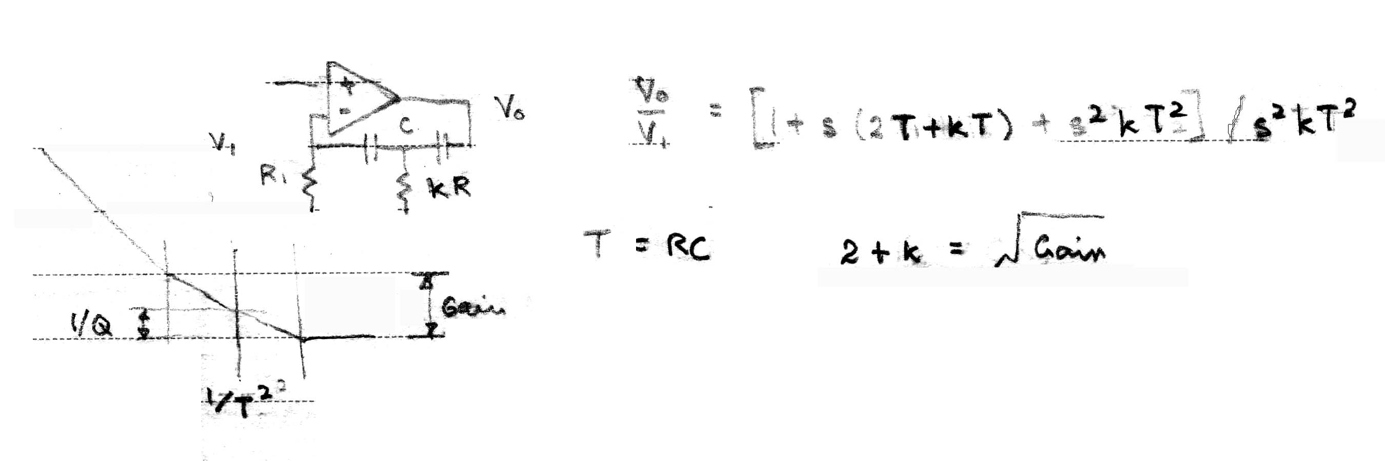

But as evidence that I kan reed en rite, here's an analysis I did circa 1980 to help design TPC.
Du.uuh! Xcus 1 hu kunt reed en riteCome on, it's not that hard to search this forum for posts on "DTMC", in date order to see how it started and develops.
I just did it and even the first post pretty much explains the idea.
And I'm not sure that TMC & DTMC come under the monkeys too.
