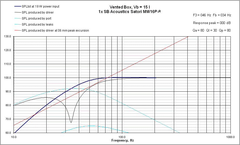

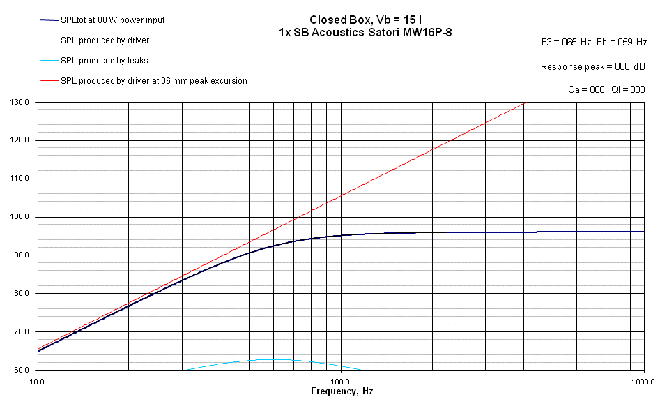

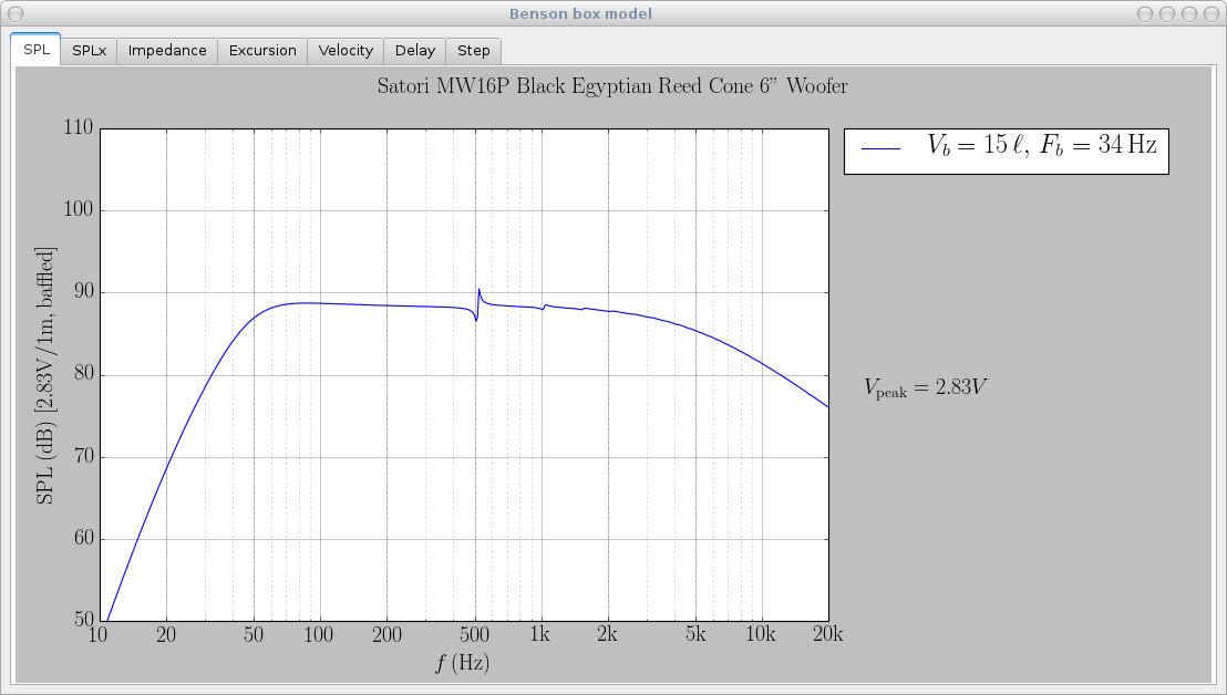

I found this linkwitz tranform simulator which generates FRD files Linkwitz Transform Design Program, which will work with the Unibox "Frequency response correction filter"
I did a model with the 4ohm Satori
Target Fsc 23.00 Hz
Target Qtc 0.57
Plus I added a sub filter at 25hz 1st order roll off for xmax protection.
plugging into unibox with the 15L sealed looks great.
With 8watts I can hit ~91db max and stay within xmax limits. With 6watts I can hit 90db. Well within the limits of the TPA3116.
Response is -2db at 50hz and -4db at 40hz and -8db at 30hz
I might tweak the model a bit, but this is close to perfect for my target application (stand-alone without sub). I still need to work up the with-sub roll off version.

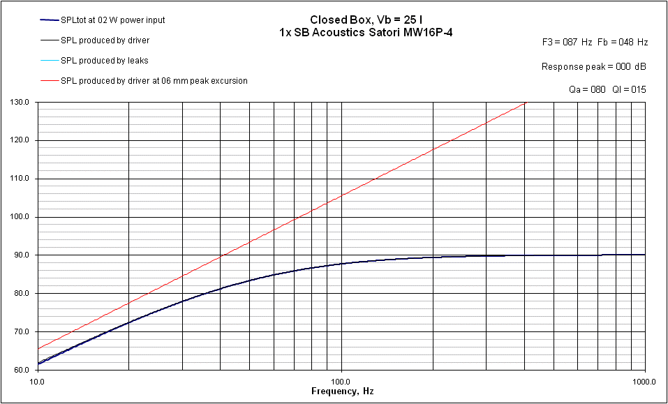

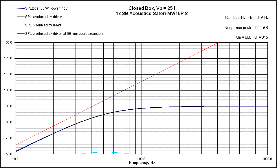

I have to admit that the satori in a 25L sealed box does look very good. Almost critically damped (qtc 0.445 for 4ohm, 0.534 for 8ohm). But this is just very big for my near-field application.... unless I went for a mini-tower sealed-box approach. hmmm. I could probably do something with internal dimensions of 600 x 190 x 220 mm (H W D). That might work?
I have also always wanted to try an aperiodic tuned enclosure. You can't find them commercially anymore. I wonder if I could get a 12L or 14L box to look like a 25L with the right aperiodic tuning?
OK I am 98% convinced on the Satori MW16. Still not sure if I should go for 8ohm or 4ohm. They model quite differently in unibox. Both should be ok for my TPA3116 classD amps (rated for 50watts 4ohm).
