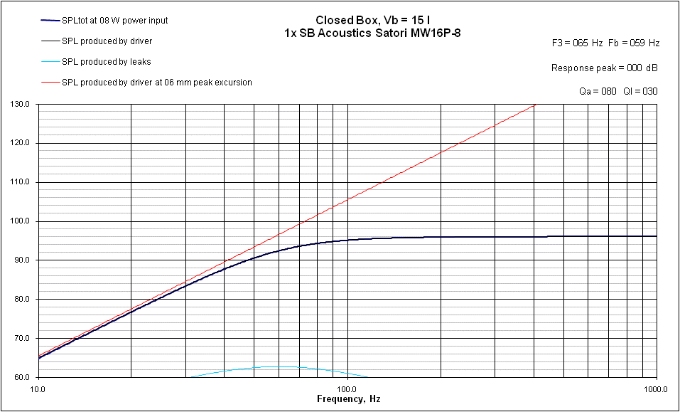

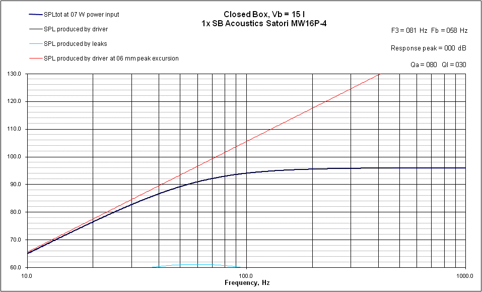

Maybe I am missing something, but the 8ohm satori models a little better with an F3=65hz while the 4ohm models with an F3=81hz. Even though the 4ohm is more efficient and would allow for more DSP eq gain, wouldn't the 8ohm require less eq to get the right amount of bass correction? I think (based on the unibox) I would only need 4db of low shelf eq to flatten out the 8ohm 15L satori to around a 50hz F3. I think the 4ohm satori would need closer to 6db low shelf to get a 50hz F3. The 8ohm is modeled with 7.7watts and the 4ohm needs only 6.5watts.
But yeah if the 4ohm tests as cleanly (low distortion, clean midrange) as the 8ohm, then maybe it would be better to go for the more efficient 4ohm satori. They model close enough, and the TPA3116 is rated for 50watts @4ohm.

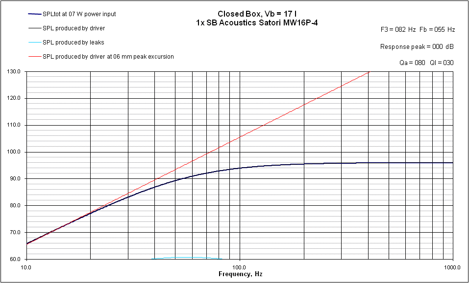

I attached unibox models for both 15L and 17L sealed for both 4ohm and 8ohm satori based on the published driver specs.

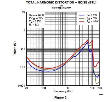

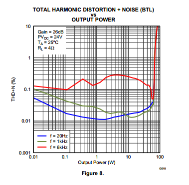

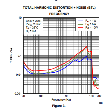

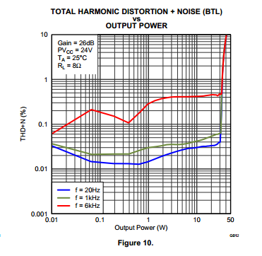

I looked up the spec sheet on the TPA3116 http://www.ti.com/lit/ds/slos708c/slos708c.pdf and from what I can tell the max voltage is maybe 14v or 17.5v with max current maybe 7.5amps. I think this just means 50watts 4ohms, 25watts 8ohms, 12watts 16ohms. At lower impedance it becomes current limited.

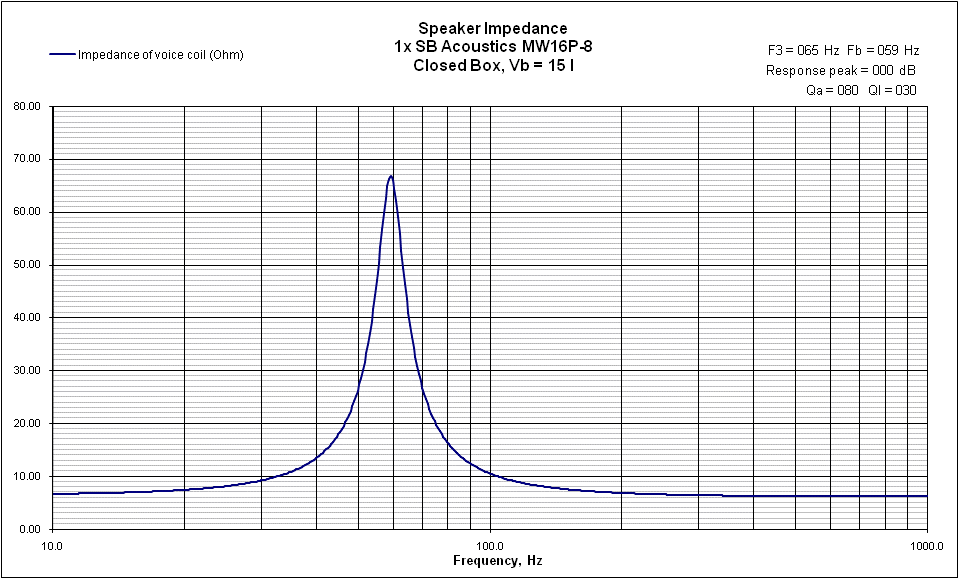

That isn't quite what I was meaning. The bass response that you will get out of the driver will closely mirror what you get in the simulation program. Amplifiers are constant voltage devices and vary the current they put out and thus the power delivered, based off of the impedance they are driving.
What I was trying to get at was that to work out the power delivered to the driver you need to look at the impedance too. It might appear that the 4 ohm version needs 6dB of boost, by a given frequency, to reach 'flat' and the 8 ohm version needs only 4dB of boost. But if the 4 ohm version has reached an impedance maximum, around the box tuning, then the power required to actually give you 6dB might be lower than what the 8 ohm version needs.
If the impedance shoots up and the power therefore goes down, this is a good thing because it means the efficiency around that point has increased.
TI rate their class D amplifiers at 10% THD, which is ridiculously high and you will never want to reach this point during normal listening. If you look at the curves of power vs distortion you will see that it remains roughly flat up to a point, then sky rockets. You will be wanting to use the amplifier up to the point before it sky rockets.

Here are the impedance plots for Satori 4ohm and 8ohm in 15L sealed (min fill). 4ohm satori impedance peaks at FB=58hz and 46ohms, the 8ohm satori peaks at Fb=59hz and 67ohms. At 50hz the 4ohm satori impedance is 20ohms, while the 8ohm satori is 27ohms at 50hz.

Obviously you're still better going for the 4 ohm version as it will have more headroom with the TPA.
I think I can also see also why you recommend the linkwitz transform network.
I think its a bad idea to apply LT for them.
If you are building sealed, it has to have sub or woofer helper.
The LT can have a number of useful applications and lends itself well to both situations.
If you've put the Satori in a slightly too small box, such that the Qtc might be 0.9, it is quite useful to use the LT just to reduce the system Q down to 0.5, even if you're not going to lower the tuning too. This actually has the effect of lowering the required power around the old system resonance at the expensive of increasing it a little lower in frequency.
In an unassisted (sub less) environment it also gives you the option to lower the response, which is something you need to take care with, as it is easy to over do it, but it is something I wholeheartedly recommend. I mean if you're only going to listen at low SPLs, then by extending the response down to 50Hz, you're just making better use of the resources you've got. Does the driver have the excursion? Yes. Does the amplifier have the power? Yes. Then go for it.
In the assisted situation the LT also makes a lot of sense. Say you want to cross over the sub to the mains at 80Hz. In this case you set the LTs target response to 80Hz with a Q of 0.7. In addition to this you apply a high pass filter with a target of 80Hz and also with a Q of 0.7. Like this the LT and the high pass will sum to give you a 4th order roll off with a Q of 0.5, or a 4th order LW Riley. This is perfect for mating to a sub.
