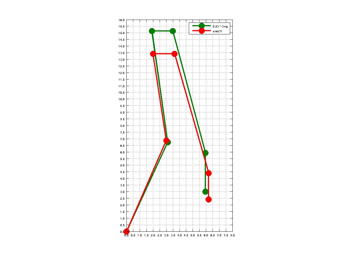

i just discovered i had 4 of the tc9fd drivers laying around and was fooling around and took the original box dimensions and scaled by 0.53 and compared to what you published (see attached picture). I am trying to understand the slight differences i am seeing (red = xrk, green = 0.53 * original). Also would you share your akabak script? btw i quite enjoy these threads (built the cornu spiral)

Harperrc,
Honestly, I don't recall how my dimensions ended up so different than 0.54x. My height is 15 inches and as I said optimized the dimensions to maximize foam core usage as boards are 20 in x 30 in so 15 in is half of a board length. You can go with the actual 0.53x or whatever it is not that critical. Good luck. Try the 0.4x if you want a quick and easy build.
