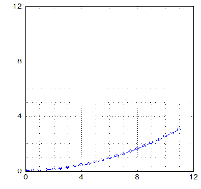

The K-slot curve is actually not as critical as how wide the gap is at the narrow end and how long it is. I actually hand-drew the arc portion and made the skinny part about 3/8 in wide and truncated it about 3 in from the top. For your single driver version, maybe 1/4 in in wide slot that stops 1.5 in from the top is good. You are an artist so I know you can hand draw a smooth arc from the 1/4 in wide slot to the bottom corner. If you want to be perfect, I have converted the published K-slot (from K15) into a mathematical function which can be scaled. I can generate a curve for you if you want - give me a couple hours. How is the build going?
X
Edit: Here is the curve coordinates (note that x is the along the height of the speaker and x=0 is at 1 in from the top, thus at 11 in the bottom of the speaker y coordinate should equal half the width of the front baffle.

xdim (in)	ydim (in)
0.00	0.063
0.50	0.070
1.00	0.090
1.50	0.122
2.00	0.166
2.50	0.223
3.00	0.291
3.50	0.372
4.00	0.466
4.50	0.571
5.00	0.689
5.50	0.819
6.00	0.962
6.50	1.116
7.00	1.283
7.50	1.462
8.00	1.654
8.50	1.858
9.00	2.074
9.50	2.302
10.00	2.542
10.50	2.795
11.00	3.060
If you are interested, the function in non-dimensional units (0 to 1) is given by: y(x)=0.974 * X^2 + 0.00874 * X + 0.0207
Enter values of x from 0 to 1 and scale that by your height. The resulting answer for y varies from 0 to 1 and scale that by half the baffle width.

THanks X, I did up an excel spreadsheet for scaling, but then realized the picture you posted, I can just print to scale until it is right. With the kids in town for Thanksgiving, and the addition to the shop half done, the build will have to wait a week or two.

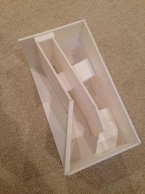

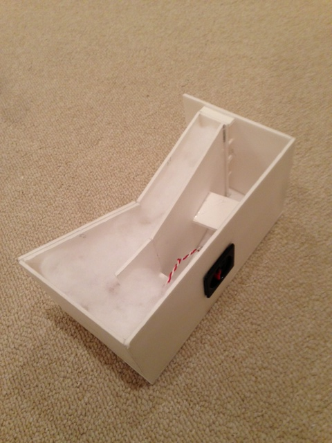

I just started on the single driver 0.4x scale Karlsonator this morning. It is a cute little speaker at 12 in tall 6 in wide x 6.5 in deep. Very easy to make out of foam core due to the small size of all the pieces.

0.4x Scale Karlsonator with single Vifa - Build 3 - Completed
The speaker is completed. Here is a photo of it with a CD case for size reference. It is very small and compact at 12 in tall x 6 in wide x 6.5 in deep. This size is perfect for a bookshelf or a desk.
How does it sound? In a word - amazing! It sounds very very good. The highs are clearer than the dual driver 0.54x scale version . I think it may be that the direct radiator cone area is better matched to the Karlson aperture size in this format - or the mid-bass is cleaner? The bass extension is quite nice - not as deep of course as the 0.54x version - but very satisfying. I played "Sermon on the Mount" by Dave Brubeck and his sons - there is a beautiful Cello and it comes through very natural and smooth. I played some Robert Cray and that sounded great. If you pair this with a sub crossed at 80 Hz and below it will really shine - but it sounds great as is. For a desktop computer speaker, it will easily beat a $100+ pair that is out there. The wide angle directivity is very nice and apparent when you step back and walk around the room - it sounds very uniform.
Anyhow, I don't have any reservations about recommending this build. You will not be disappointed. For the cost of a $10 Vifa, 1 sheet of foam core, some pillow stuffing, and a $0.85 terminal cup - this speaker is awesome!
