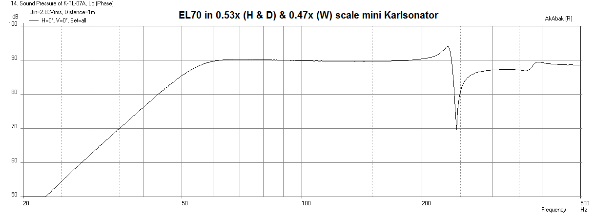

It looks like it works pretty well in Karlsonator scaled 0.53x in Height and Depth and 0.47x in Width.

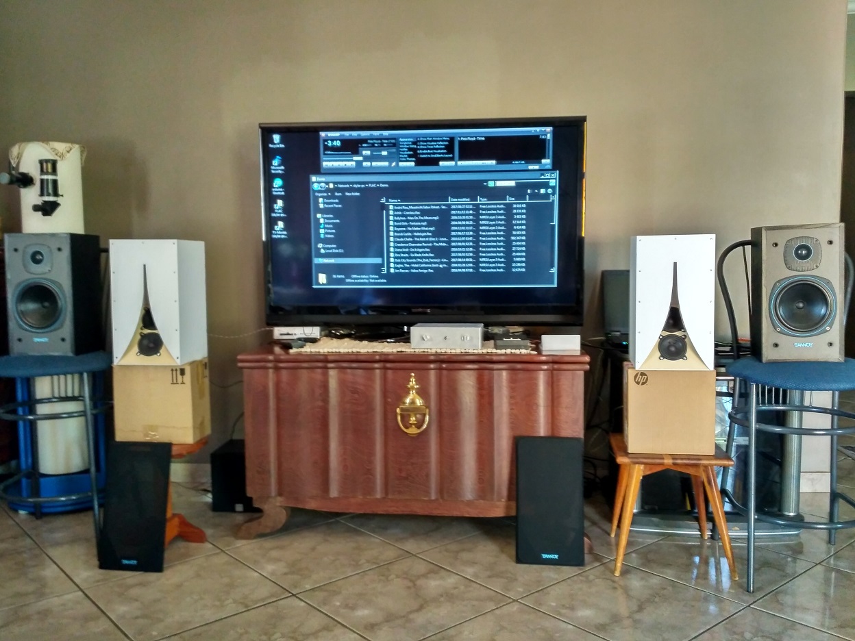

Reporting back on Skylar88’s Karlsonators - 0.53X build with dual FaitalPro 3FE22 drivers. Build plans here: Mini Karlsonator (0.53X) with Dual TC9FD's
We had a good listening and comparing session on Friday. Playing mostly FLAC files from a laptop using a Sabre ES9023 USB DAC, B1 Buffer and a TDA7297 amp. A single powered sub was occasionally pulled in for experimenting. The mini Karlsonators were compared to Tannoy monitors of similar (physical) size.
How do the Karlsonators sound? Amazing. Just the initial presence they create is jaw dropping. They do fill the room with sound. And they can play very very loud without a hint of struggling or loosing control. They really sparkle in the high frequencies and the midrange is very natural. Details are incredible. Vocals are beautiful and accurate.
How do they compare to the Tannoys? The Tannoys also sound very very good with the TDA amp, and definitely dominates in the bass and mid bass areas. But the Tannoys do not have the same sparkle as the Karlsonators and sounds slightly muffled or darker. Could it be the difference between wood and foam core we experienced? The Karlsonators have more life and detail, and even the bass is incredibly deep and tight, but could do with a bit of help. Combining the Karlsonators with a sub-woofer really creates something special. Which means these Karlsonators will really shine in a FAST setup I think.

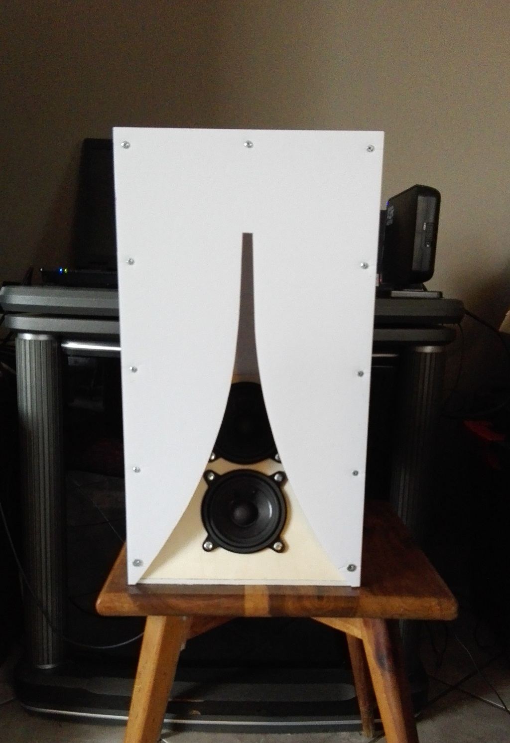

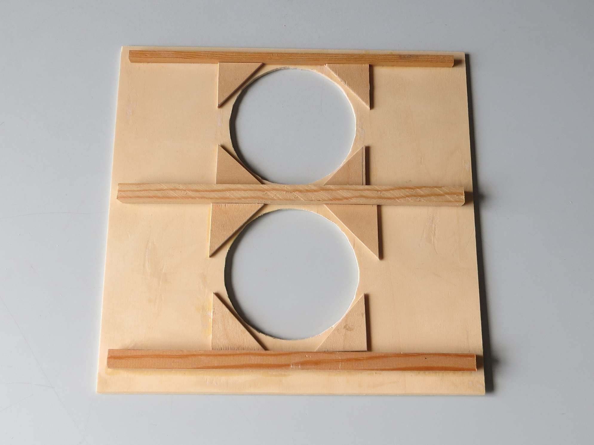

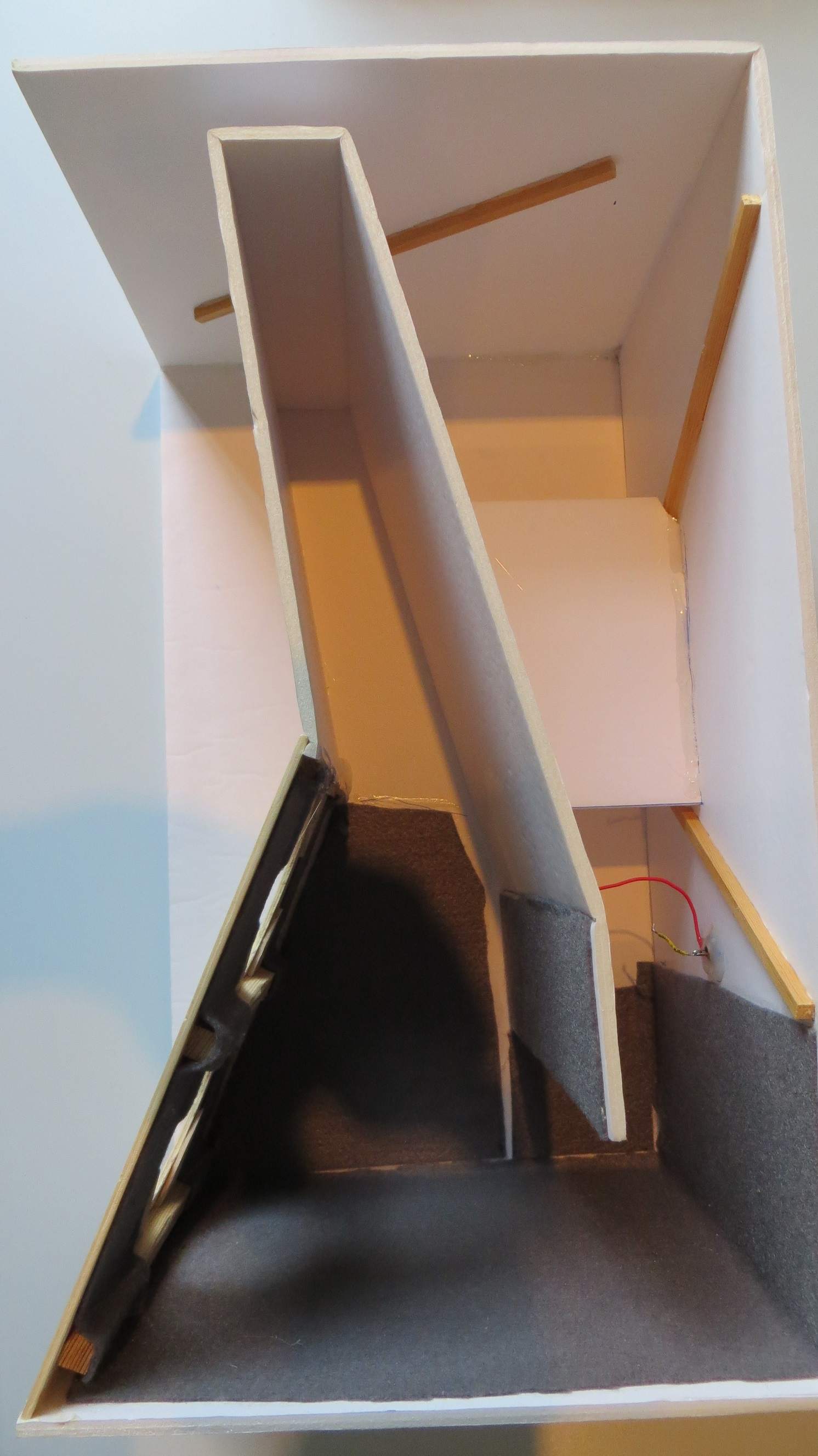

Skylar is very happy with his first diy speakers. Here are some photos of his build. He used Liteply (3mm quality plywood used in model aircraft) for the front baffle.
Regarding speaker height. I read somewhere (probably on this thread) that the Karlsonators are supposed to stand on the floor. However, after experimenting with the height, both Skylar and myself prefer the Karlsonators at ear level. The sound stage, imaging and even bass is better at this height. You can see our make-shift stands in the photo above.
Thanks for the report of our listening session, Jerry. Your description of the sound of the Karsonators is very accurate and ecactly what I also experienced. To say that I'm 'very happy' is an understatement. :cheerful:
The drivers used is actually dual FaitalPro 3FE25-16 Ohm (ferrite magnet) connected in parallel for effectively 8 Ohm. I had to make a call when ordering the drivers and in hindsight, I think the 16 Ohm version was the right choice.
I want to point out that it was originally my intention to use 12mm MDF, but with the uncertainty about whether wood enclosures sound as good as the foam board variants, I decided to use foam core board. A decision I don't regret when I listen to them. But I may build 3mm Liteply enclosures to compare, because I think I may want more professionally looking speakers eventually.
