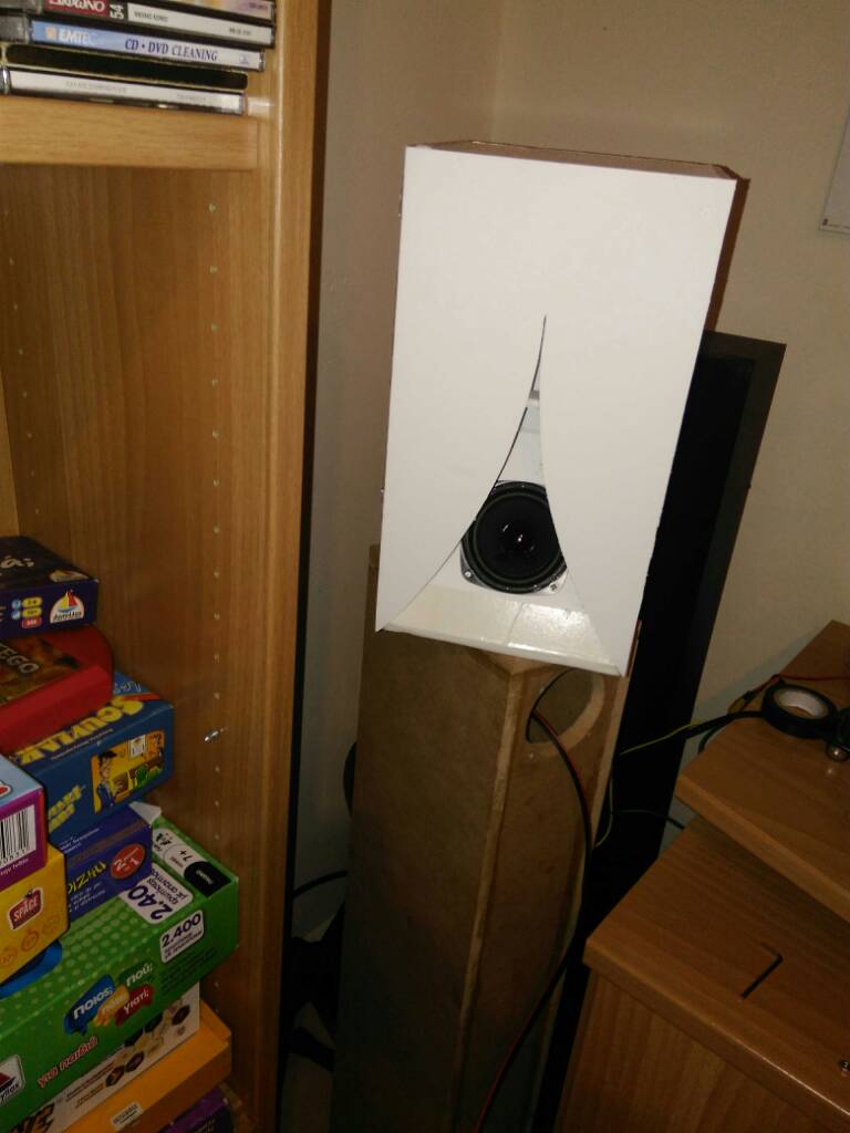

I' ve just finished my mini karlsonators. I used visatons frs8 driver that I removed from my needles in order to paint them.
I was very pleased with them and I decided to built the mini k's as a test built, before I go for the biggest 0.53 with dual 3FE25 drivers.
My impressions:
1. Build process:
a. Foamboard is quite expensive here in Greece, I should had built them out of plywood.
b. Working with foam was quite awkward and I ve found it difficult to maintain straight cuts.
c. I used white glue cause that was available and I didn't want to spent money on this.
2. Listening impressions:
For now I am listening to them without the K aperture, as I ve run out of foam. They sound good even without it, but cannot tell till they are finished. I ll post more when I am ready.

Thanks for sharing and for trying. The foam board makes a difference in sound quality. Plywood does not sound as good.
In US, foam boards are 20in x 30in and $1 ea at Dollar Stores. Nice quality Elmers brand is $6 sheet and much more durable and harder to cut.
Cutting straight requires laying on carpeted floor, use nice metal straightedge like drywall ruler, use sharp utility knife with new edge (breakaway type blades are perfect for this). Cut 3-5 strokes deeper each time to make clean cuts. Takes practice but is far easier than pulling out a table saw and making dust.
Use hot melt glue to tack pieces together and PVA to seal. Hot melt is key because your hands are the "clamps" that hold it until it sets in 40 seconds. Other glues require clamps to hold for hours.
It does sound quite good without K aperture. Bass will be deeper and soundstage will be wider and more uniform with aperture.

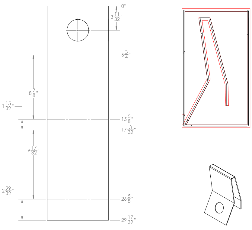

I've tried to look through the thread for a drawing of the .53 in centimeters, I can find a lot of good drawings for the .40 but not for the .53 , have I missed something?
hehejaa,
you'll find them in post #1, I had to look thru it a few times myself in order to track it down...
Post 198 has a nice CAD drawing of the dual driver 0.53x plans by Tb46.
diyAudio
and while that's a nice representation, with all the correct dimensions, I had some difficulty with the darned pdf and how troublesome it is to scale it up to a nice readable, PRINTABLE file. Curse you Adobe!!
Do yourself a favor and print MudJester's .40 Karlsonator referenced in line 1 of post #1 for how it SHOULD be done. (Thanks Mike!) By studying both plans, you'll give yourself a clear plan of action for your own build.
Latest 0.40x K'nator Score-N-Fold Plans by Mudjester available here: Mini Karlsonator (0.53X) with Dual TC9FD's
Best of Luck!

>>Use hot melt glue to tack pieces together and PVA to seal. Hot melt is key because your hands are the "clamps" that hold it until it sets in 40 seconds.<<
Mainly this, as my cuts were clean and straight. My main problem was that I tried to cut the foam from side to side, so I started from 165 mm and ended to 162mm. Filling the gaps took me some time. I used PVA for the side, no problem with this. Pins were used to keep the pieces in place.
I have to say that not using hot glue helped me to make some adjustments while the glue was drying.
I have just finished the K Apertures, placed them in place with pins and plastic tape for testing. They do make a difference, although they vibrate enough since they are not glued.
I really like them. For sure they beat my three 5.1 systems.
Soundstage is big!!!, it feels like sound is coming through the back wall. I have to cross them with my (cheap) sub about 80 Hz for best results, but depending on the music, I could skip that.
The other thing I noticed is that radio music is not so annoying to my ears with these speakers. They are more balanced, more relaxing.
They also seem to fill the room with music. The sound is everywhere, it is not pointing in a sitting location. I can move and still here the same thing.
I was impressed when I listened to the first seconds of Pink Floyd's "Money". Stereo image was very good, music was travelling from right to left and back.
I cannot decide if the needles sounded better than these. Its the same driver in different enclosures, but I prefer these, as long as they are matched with a sub.

I still have my x0.4 files. It would be easy to re-scale it to x0.53 and make a new drawing. I can also make it inches or mm very easily. The k-aperature probably wouldn't fit on a single page anymore at 1:1. And I don't know if score-and-fold would still make sense, but I can give it a try.
Would anyone be interested in that?
Edit: Oh, looks like I already started. Worth completing?
Absolutely, would be useful for sure .

I finished them!!! K aperture is glued and sound is awsome. Much better now, xrk thank you again. Very rich bass, pleasant and relaxing. The only thing I noticed is that voices seem to come from a tunnel or a cave, but only in some songs.
Right now I am building a temporary case from the spare foamboard for my tda.
For now the visatons stay in the karlsonators. Needles need sanding amd painting.

If you make .53x score and fold plans you'll be my hero 😱
Lol, sounds like there's a desire for it. I'll do it.
Since I'm not planning a build for myself right now, I'd love some input (to help with all the minor design decisions that goes into something like this). Should I do score-and-fold plans, as much as makes sense? How should I make the aperture diagrams (multiple sheets, larger sheet, scaled down image, any of these would have dimensions of course)? I'll do two versions, one in mm one in inches.
Any other requests? If I'm going to spend the time on this, I might as well do a good one.
