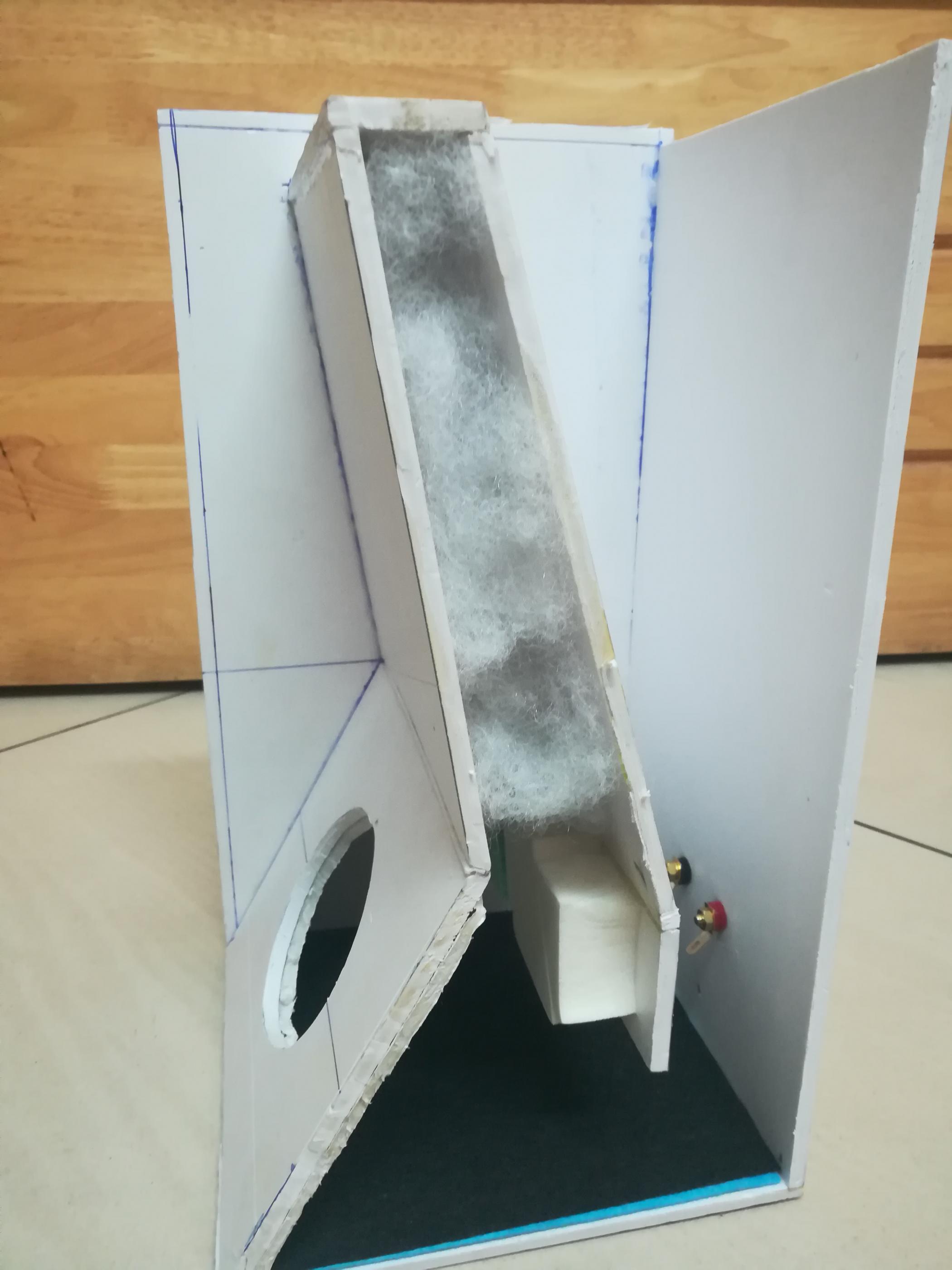

Mini Karlsonator 0.4x
Hello X,

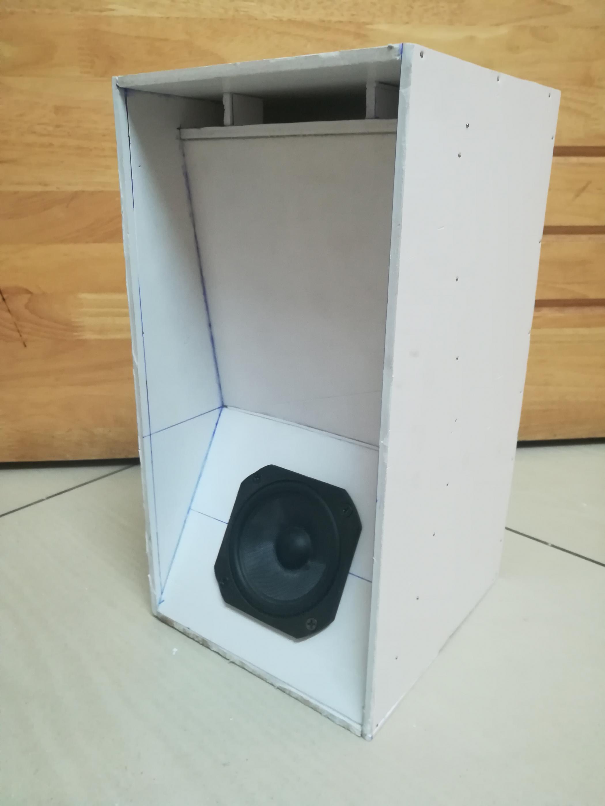

My progress so far on 0.4x mini Karlsonator. Still some way to go before I finish one speaker. I used something called sunboard for my build which is pretty strong but can be cut and worked with. It took full day's work to get here.
Can you please let me know if I can use Visaton B80 in these? I have kevlar version of TC9 which I can use as well if B80 is not a good fit.
Hello X,
Hello X,
That looks really good. I think the B80 should work fine - that's about the highest end driver I think anyone as tried in a 0.40x Karlsonator. I haven't done a sim yet but it is close enough to the other 3.5in drivers that do work (TC9FD et al).

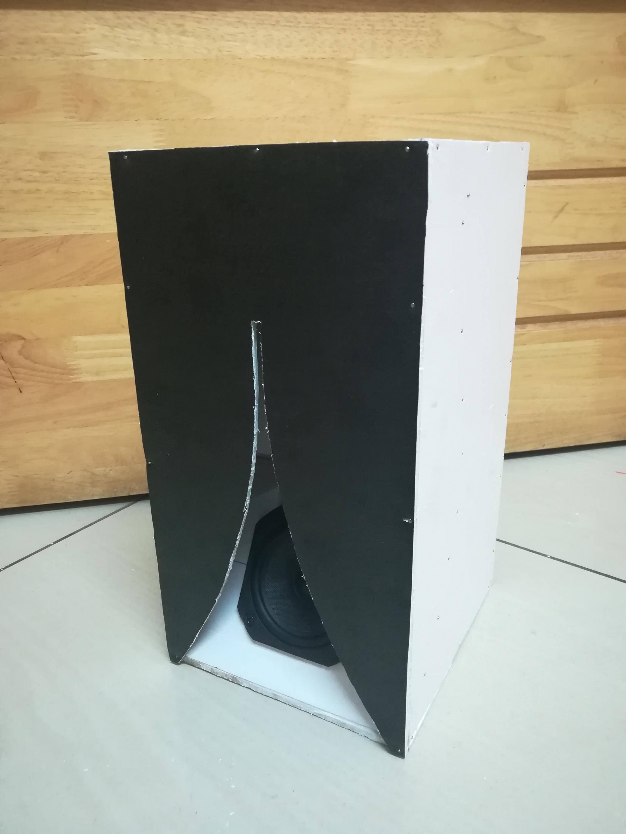

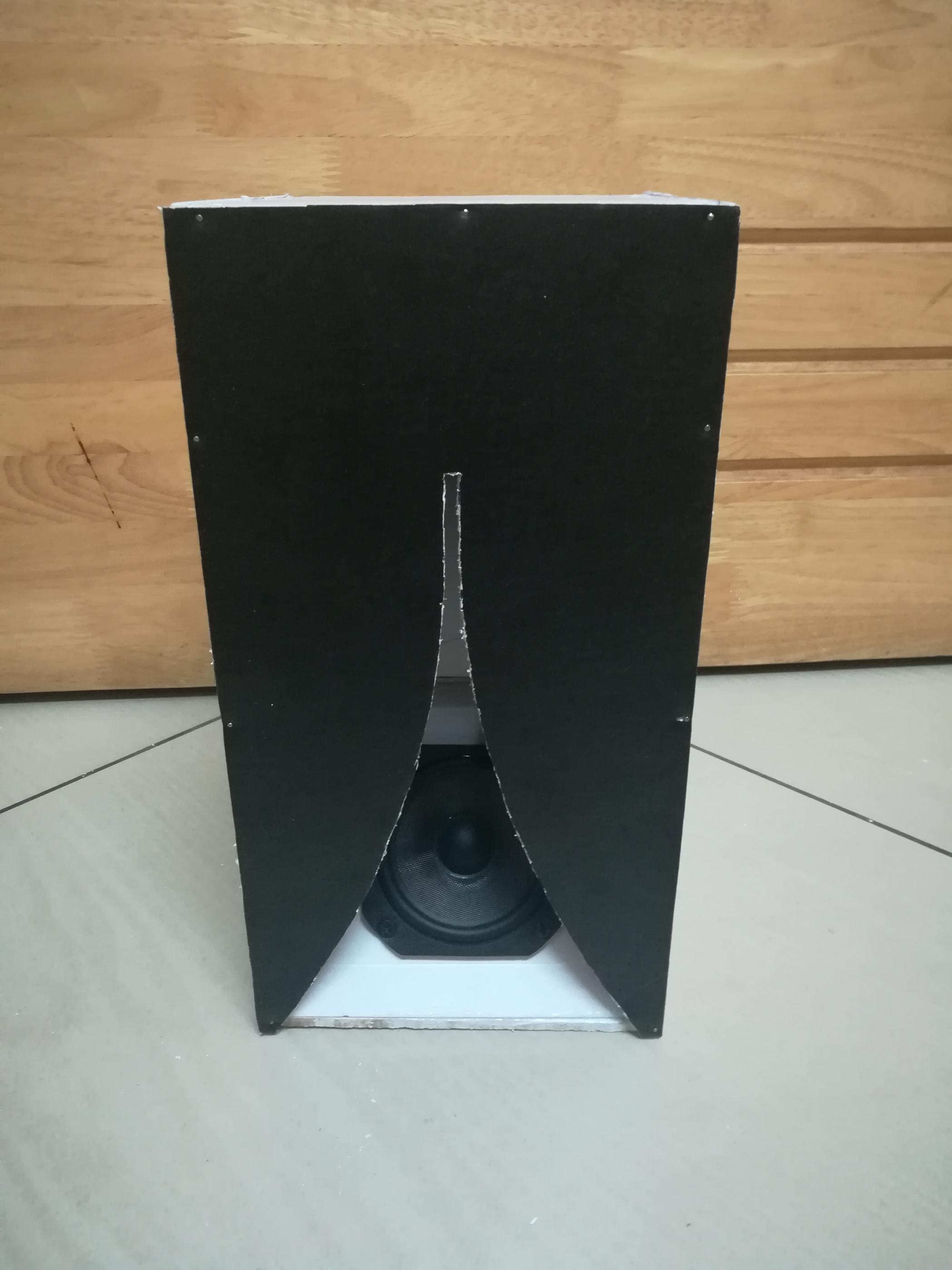

Completed mini-k 0.4x
Hello X,
I got one mini-k completed. It sounds fine and I can hear some bass but not sure how low it is going.
I need to spend time with it to understand it better. As of now, I am listening it with other speaker being Tabaq and after listening to this speaker, I realize there is some leakage in my tabaq since there is less bass in that.
Anyway, it is good speaker and pretty compact. Lets see how it goes.
Thanks for providing the design like so many others you have done.
Balaji

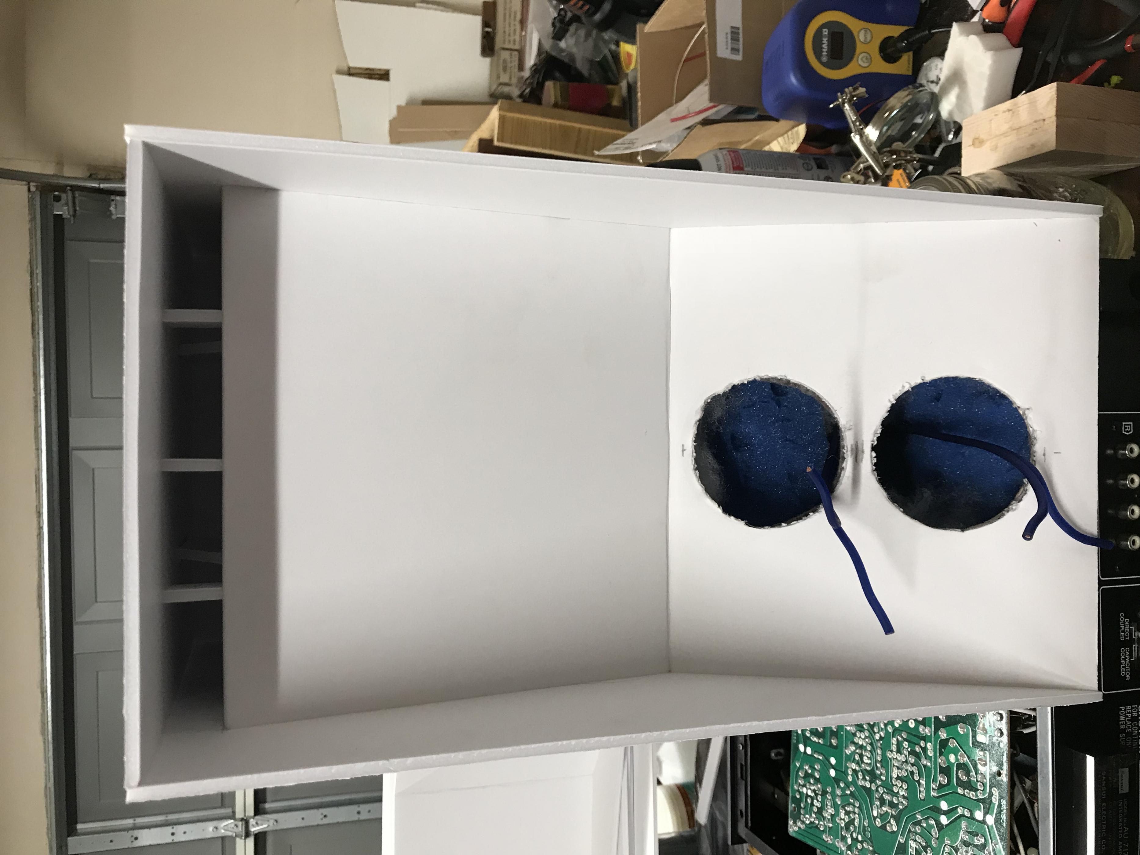

Finally making a little more progress. I got sidetracked with restoring my friend’s Sansui AU-717. Finished felt and foam in one speaker last night and glued the side panel on. All that’s left is a few solder connections on the drivers, a few screws, and the K-apetures.
Let me know if you see any issues with any of my work. I’ve left a lot of the foam and stuffing loose for adjustment later if needed.
