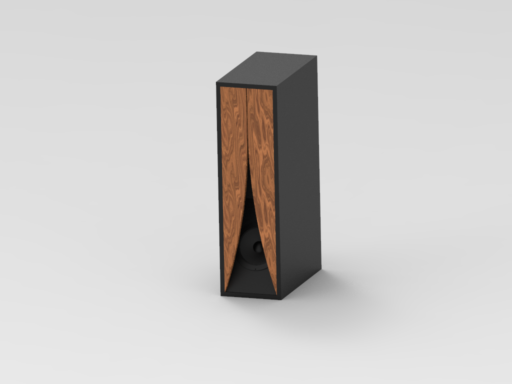

Hello, I just build a slightly modified Karlsonator to fit Tb W6-658E out of 12mm (shitty) plywood.
X-max:4.10 mm
Vas:28.31 Litr
Qts:0.44
Qms:4.49
Qes:0.49
Complete speaker data here: W6-658I - 6.5" PPM. Woofer - TB SPEAKER CO., LTD.

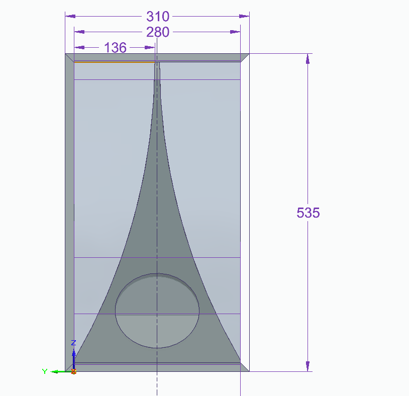

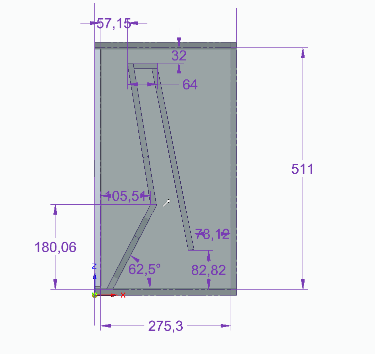

The dimensions i ended up with was something close to this:
704977d1537623537-mini-karlsonator-0-53x-dual-tc9fds-sk-rmklipp-png
704978d1537623537-mini-karlsonator-0-53x-dual-tc9fds-sk-rmklipp2-png
So far it does its job but i expect a more refined version sound better. The final version will probably be 16mm MDF.
The "original" karlsonator dimensions i have found seems to be this:
And the 6" version has more changes than just scaling:
Are the W6-658E suited for a Karlsonator at all and what would be the correct way to scale?

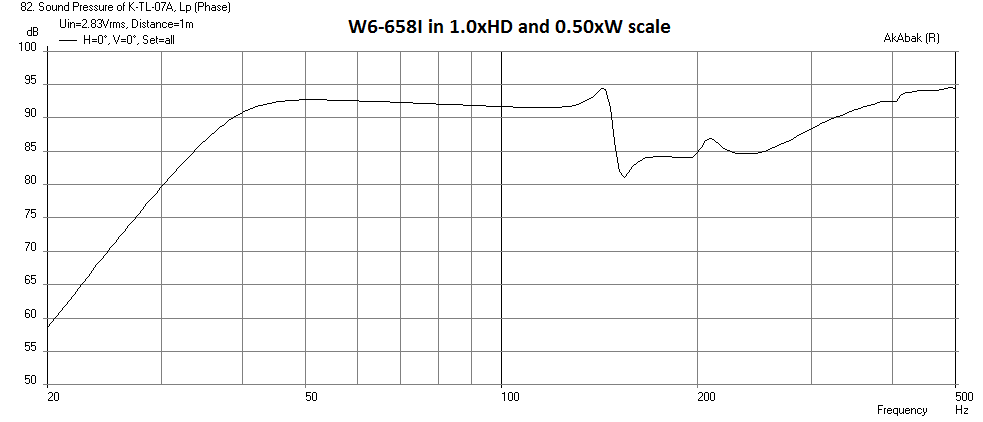

I just ran a sim for the W6-658I and it has a surprising result. The optimal speaker is quite large (1.0x scale tall and deep x 0.5x scale wide - a skinny tall aspect ratio). This gives the flat and deep response.
attachment.php

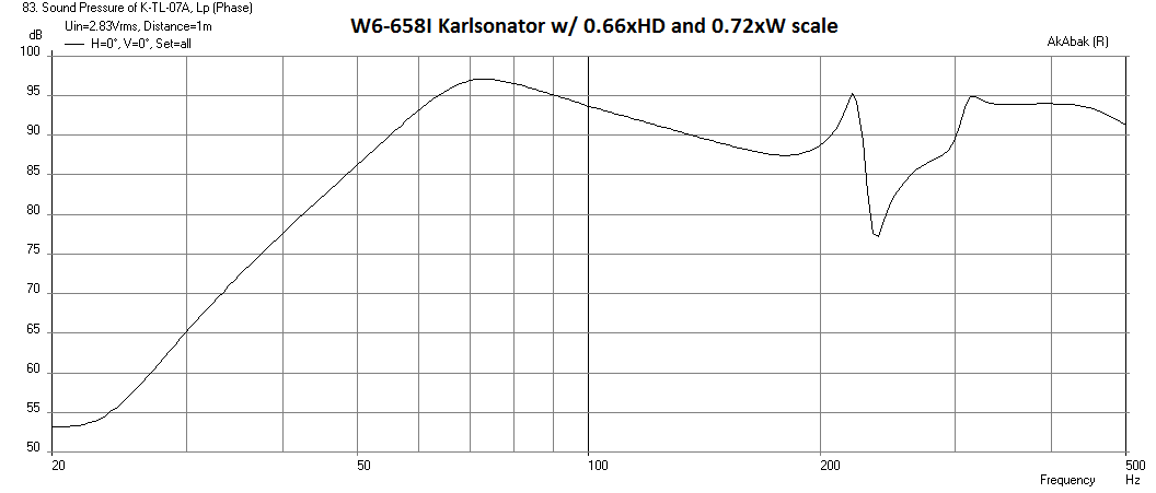

A Karsonator with scale of 0.66xHD and 0.72xW - which is approximately what you built has a predicted response like this (very strong 70Hz overshoot and not very deep bass):
attachment.php
708069d1538942538-mini-karlsonator-0-53x-dual-tc9fds-karlsonator-w6-658i-1-oxhdx0-50xw-freq-png

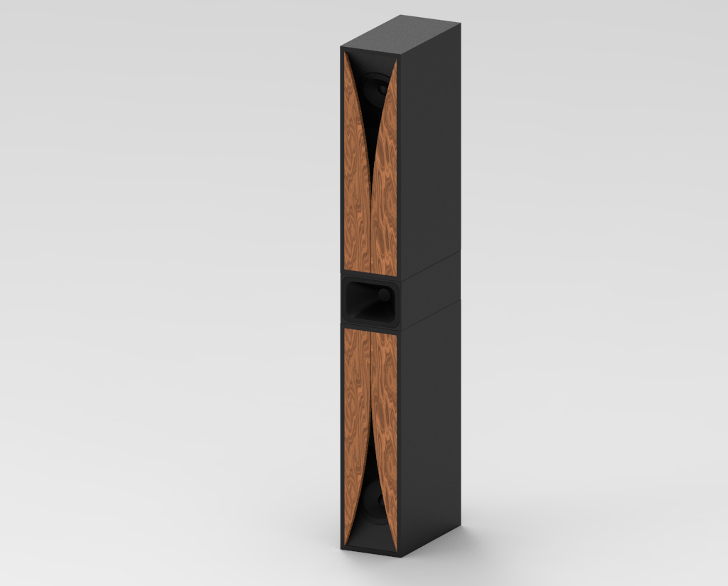

The woofer choice is only because i have a i few of them laying around.. (Intended for a cheap pick-nick boombox).
Since the woofer is not full-range, i need to add a tweeter. I have 4 Woofers available which means i could do something like this. Then i also have space for amp and crossover behind the tweeter.
attachment.php
I currently have this Random Tweeter. Would it make any sense to make a horn for that one?
