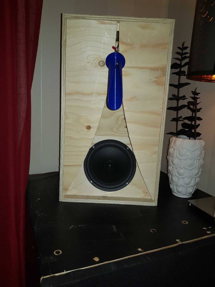

that may be the first blue and certainly 3D-printed K-tube in history. (-assume its the camera which gives the impression of a positive flare. Transylvania Power Company's "THE TUBE" had a downwards taper which Walter Zintz said conformed to Karlson's patent - also might have made it easier to pull from the mold ?) - the very HF go straight down the tube. They can sound great with compression drivers and need no contouring in the highpass filter.

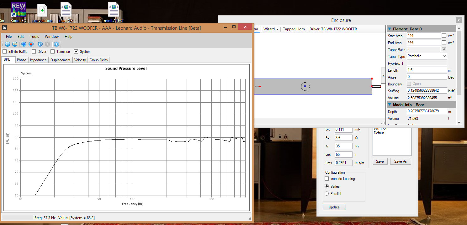

I did a simulation using a W8-1722 woofer and it has been the best sim I have done yet, one that reaches low and with nice output. It could be mated to a small mini-k sitting on top of the folded line.
Never had the chance to build it yet...
