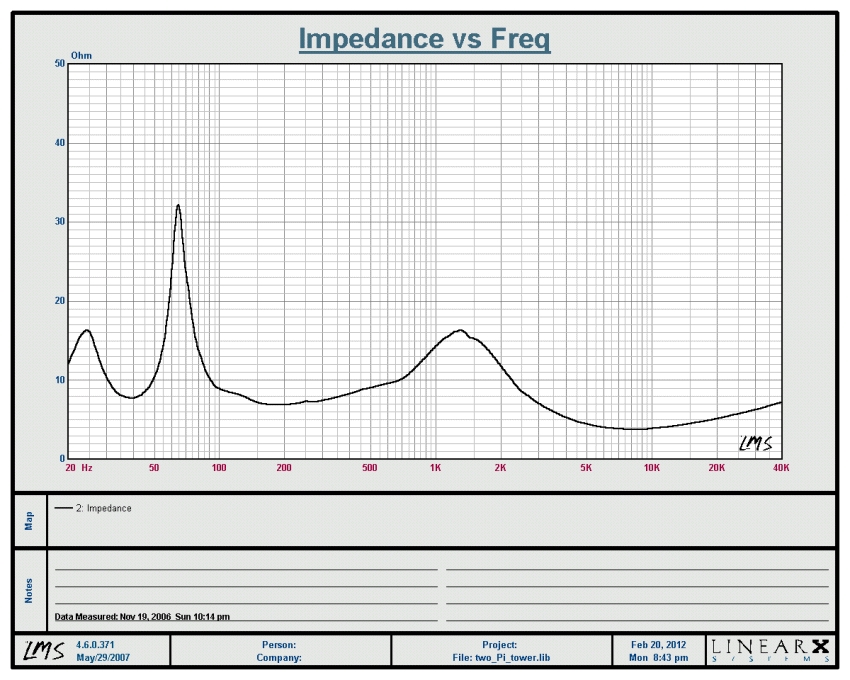

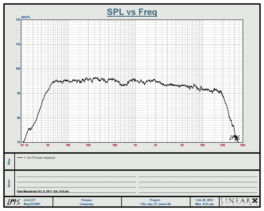

This is what I have archived. Not sure where I found it. The website is not all that informative.There's no measurements about the Pi's so, I can't comment.
Edit: This is where I found it: www.pispeakers.com/Measurements
I'm sorry, Skylar, but for bass response, you will have to look somewhere else. Looking at that graph, f3 is 55Hz, which I'm sure your dual driver mini-ks can do easily as well.
The 2Pi uses a 10" cone, so, it will move more air, but not that much.
You're quite correct, the dual 3FE25 mini-K's can do 55Hz, but it doesn't do it well.
I beg to differ. It will move much more air. If you calculate the area of one 10" driver and compare it to the area of two 3.5" drivers, you'll see it's 3.3 times larger. Also, the speaker I'm talking about is the 3 Pi Tower, which uses the same drivers as the 2 Pi, but is a much taller tower bass reflex design. That should count for something and I see it as the reason why someone commented that you don't need a sub with it.The 2Pi uses a 10" cone, so, it will move more air, but not that much.
