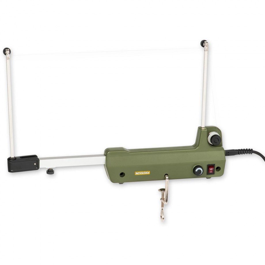

And so it begins. Hot wire cutter arrives.
Thanks for the help X , i hope this construction method proves as easy as it appears because I've had my eye on your creative and generous shared designs for a while , including the scaled up karlson k15's you simmed for me a while back ( once ive had my damaged altec 604's repaired :s ) and the Kazba open baffle ( wanting to try it as a sub for dmls and open baffles but still retaining some Karlson kick

Any luck with hot wire cutter? A sharp utility knife and straight edge work pretty well.

What i lked about the hot wire table was that itll keep cuts fully vertical ( or at a 'chosen' angle ) which freehand might not , depending on the skill of the person holding the knife.
