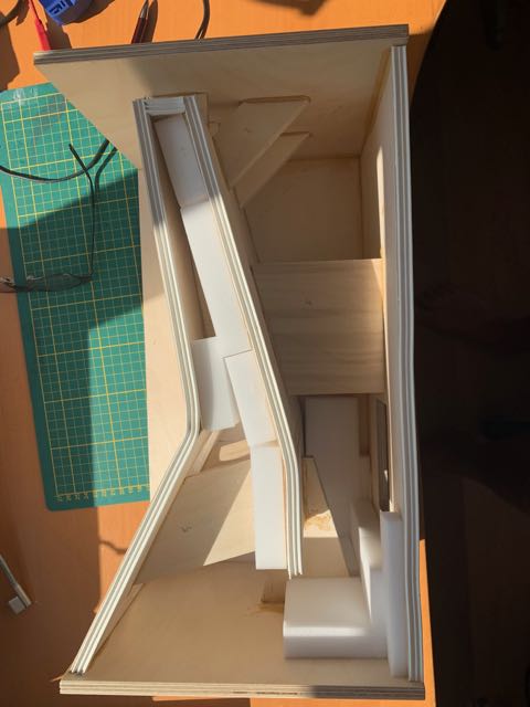

Now with damping

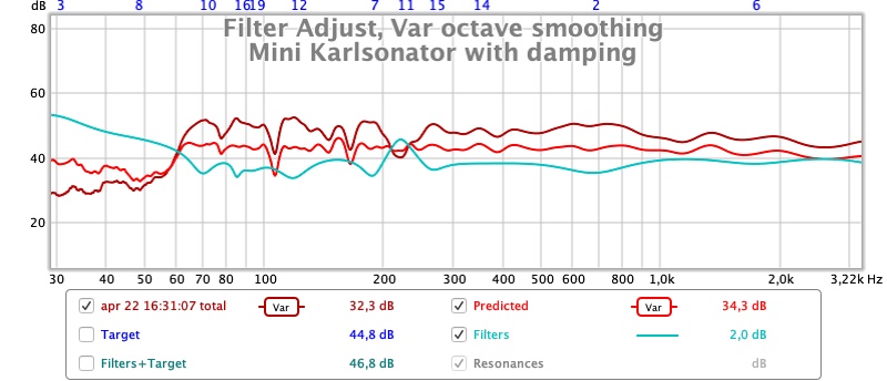

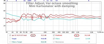

Sooo, I put damping in the test-mini. This makes quite a difference 🙂. Still no K-aperture but quite flat response nonetheless.
Any suggestions for more/other damping in the internals of the speaker before closing it up (i.e. glue the last side into place)?

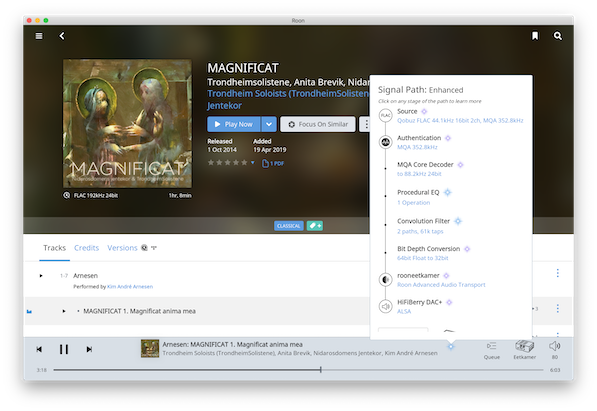

Here are some pictures of the damping, the REW measurements for the convolution filter (for ROON) and the filtering applied in ROON.

Looks good - add more foam on the bottom floor - cover it completely. Add a puff of loose polyfill in closed cavity above the drivers all the way to the bottom floor.
When you add the K aperture, it won't measure quite as flat - it will have narrow dips in the 300Hz to 600Hz range, but they are not noticeable. Just preparing you as these are not meant to be studio "flat" monitors.
But they sound great.

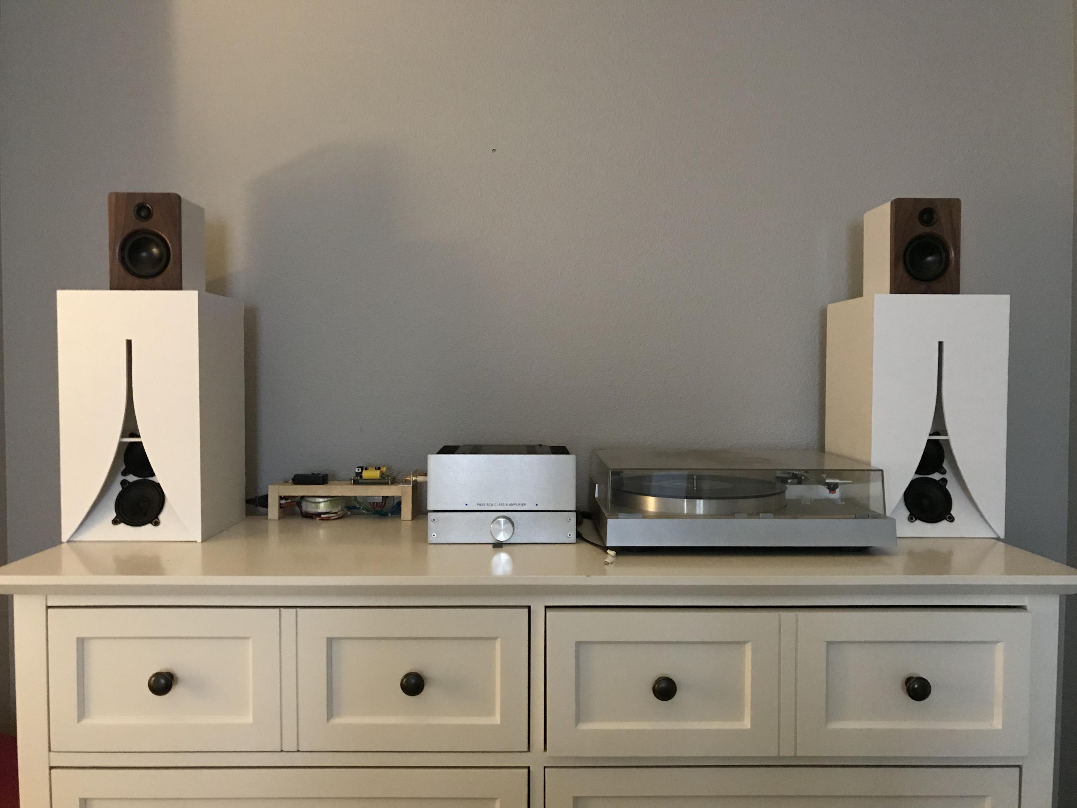

Finally finished my dual 3fe25-16 mini-k’s. I have them set up in our bedroom system right now powered by an ACA and a 2018 Wayne’s Linestage. I think I still need to play around with BSC but they do sound great! Imaging and sound stage are some of the best I’ve heard lately. I’m taking these over to a friends place tonight along with my Alpha 20w to do some serious listening. Should be fun!
Another quick update. Had a real listen to these at a friend's house last night with an ALPHA 20W amp and BAF 2018 Wayne's Linestage. They sounded impressive and held their own against my friend's Paradigm Studio 60 v5's. There is room for improvement. I still need to fit the BSC components and possibly add more damping material. My friend also mentioned that he could hear the sonic qualities of the foamcore. We weren't sure if that was a good or bad thing. He also asked it a wood enclosure would sound better. I told him that is still up for debate. Haha! I plan to do some tweaking and report back.
