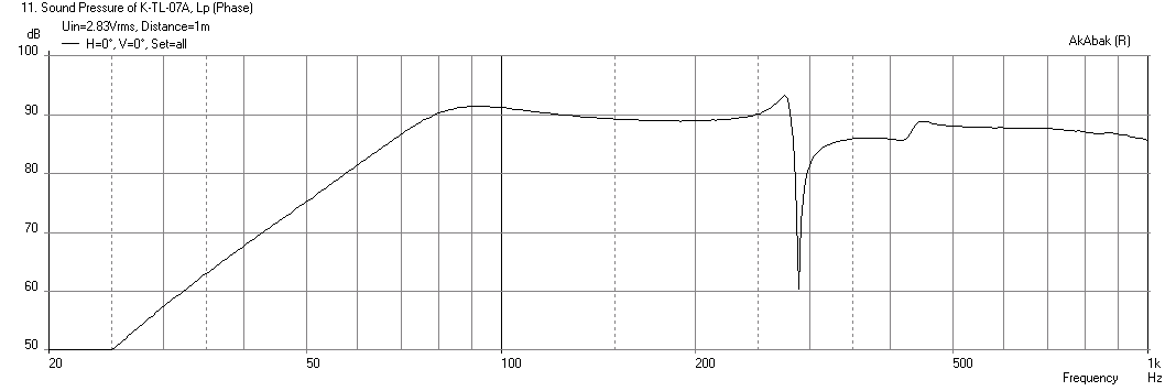

If the A10.3 is anything like the 10p in T/S parameters, I did a sim of the 10.3(or 2 - I can't remember) once and it looks like a 0.47x scale Karlsonator would work. Not the deepest bass at 70Hz -3dB, but pretty sensitive. The top end of the paper cone may be a bit muted vs the alum cone though. This sim was from Dec 2016. You might be able to find in this thread by looking at date.

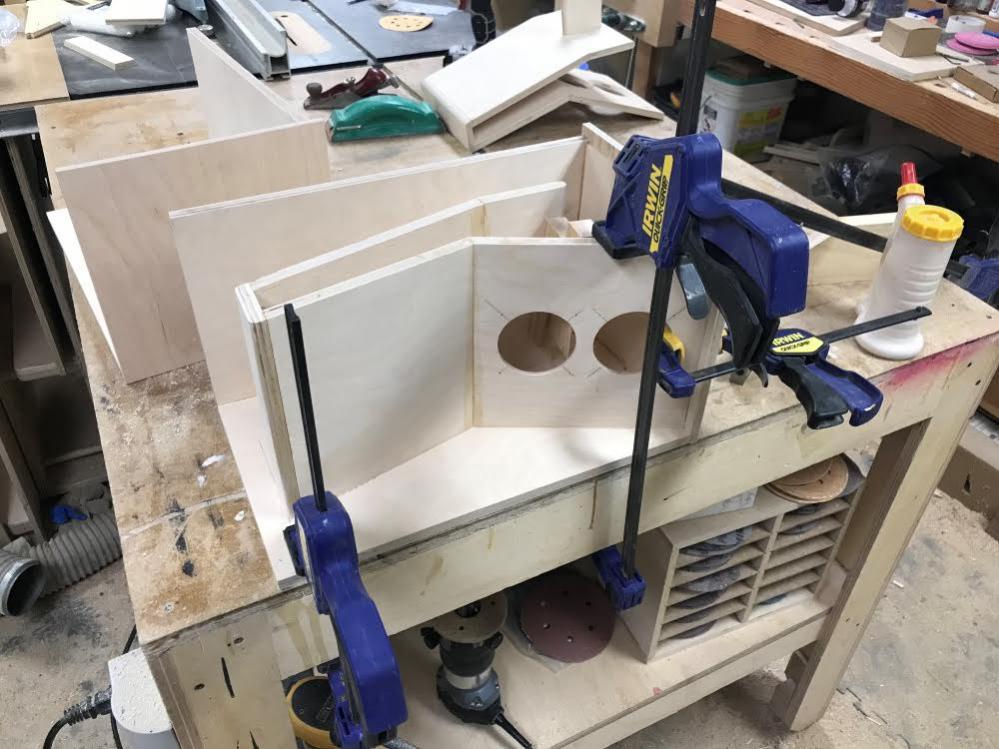

Another set of 0.53x Karlsonators for dual 3FE25-16 under construction. These will be finished in espresso brown stain on the outside with natural blonde satin finish on aperture and black Duratex on inside aperture front chamber.
- Full Range
- Mini Karlsonator (0.53X) with Dual TC9FDs
