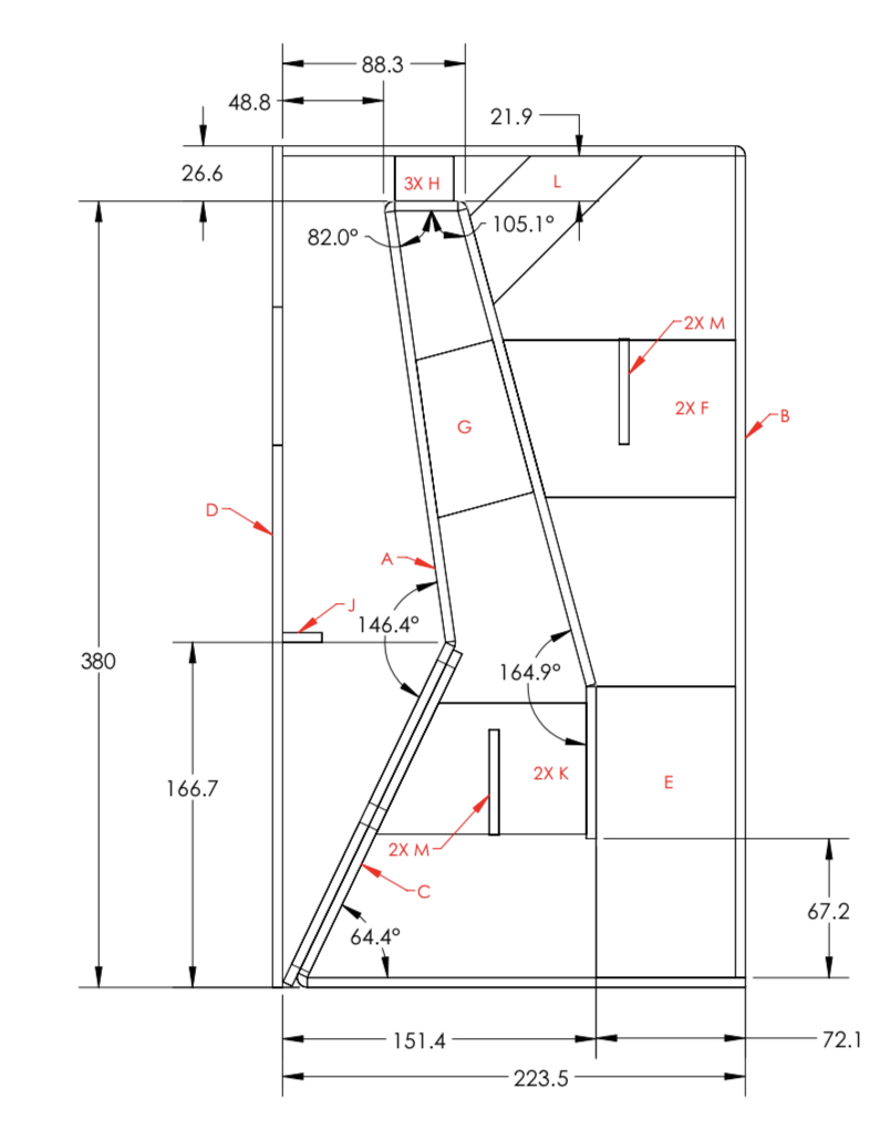

Hi Folks,
X has mentioned that more than one interested party would like to see some construction plans for a wood version. These plans were developed using Sketchup 2017, so it will require some familiarity with that tool to be able to pull out individual components and measure for size and the various angles. All components are 1/2" baltic birch except the front aperture, which is 3/8.

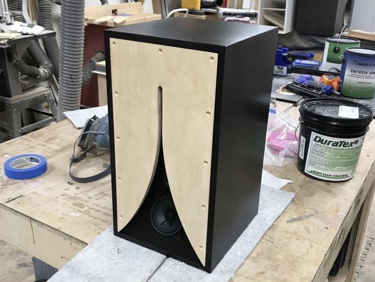

The dual 3FE25-16 Karlsonators are almost done. I am going to get the aperture tinted a more amber color than what is shown here. The finish is looking good though. Black Duratex on the inside of the front chamber. This was built using Jhofland’s Sketchup plans.

Morning all
Just busy cutting a set of foam core boxes from the 0.53x plans drawn by MuddJester
2 questions regarding the plans - I've had a search through the thread but can't find what I need (haven't read every post though!!)
1)
Is there a dimension missing from part L on the plan?
From where I am sitting it needs a dimension on either of the 2 parallel edges of the trapezium in order to cut out correctly.
I can see in the plan that length may not be critical for this part as long as the angles are correct and that it is neither too short or too long to connect both the back of the bend and the top of the cabinet
Can someone help with a suitable dimension?
2)
Why are there 4x side panels on the plans? Are they double thickness?
Thanks to all
Hi Sthcoaster,
L is just a brace, dimension is not critical - just make it approximate so that it helps to reduce panel vibration of the top. Those plans are for a pair of speakers so 4 side panels.
A good idea is to double the thickness of the top and bottom panels. Better with another material of different density, but if you do not have it, the same wood used in the rest of the furniture.
