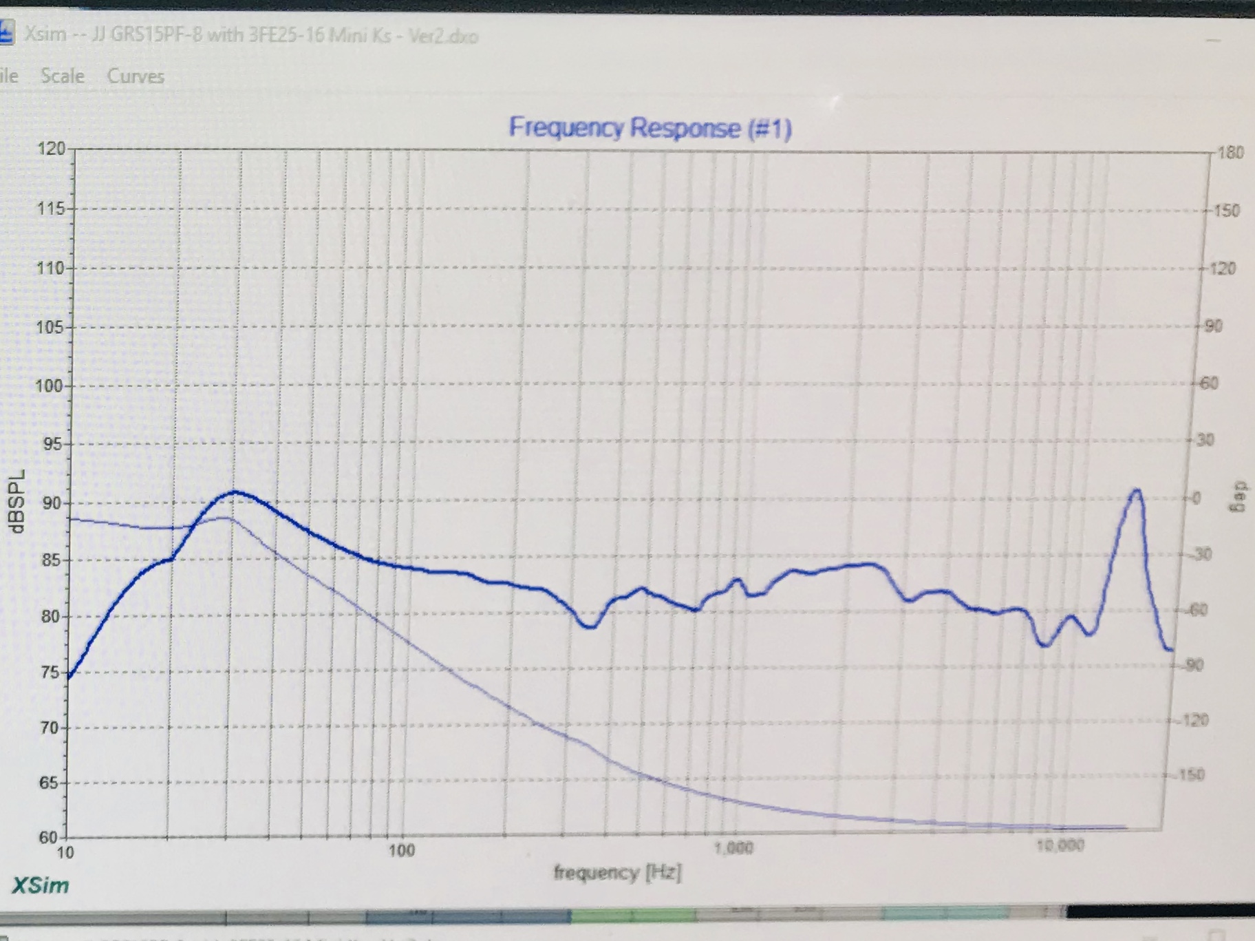

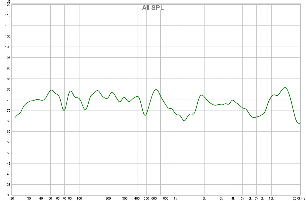

Ok, so it took me all of six and a half hours to get my butt into gear. I got my U-mik for Christmas 2 years ago and haven’t used it once. So here’s two images. The first is my XSim model. The second is my first ever speaker measurement. This is from listening position with both speakers active, with 1/6th smoothing. Looking at this I think I should cut the resistor on the mini k’s back to 8ohms. Curious to know what everyone else’s thoughts are.

Nice work! That’s a very promising result, and as you say, boosting the output from top end would make sense to balance it. Try several values of R, and see what you like. Many people prefer a tilt of 5dB greater bass from 50Hz to 20kHz. Sort of like you have in Xsim.
Thanks X. After some experimenting I settled on 8 ohms for a flatter in room response. This is a great setup. Basically flat to just below 30hz on open Baffle. Not bad.
I also measured just the mini-k’s on there own just for kicks. The response above ~150hz was identical to my previous measurements. So I know my XO is doing exactly what I predicted in XSim. Pretty cool stuff.
Here is the measurement with the 8 ohm resistor at the mini-k's. I was also curious about the FR I'm getting from the mini-k's. I feel it should be flatter. The dips at 500, 1,300, and 6-7k are much more pronounced than the data sheet for the 3fe's suggests. Is that just my room or a product of some combing affect from two full range drivers? I thought damping on the aperture may have an impact so I temporarily applied felt to the back and it had no measured affect. I'm open for other suggestions...
