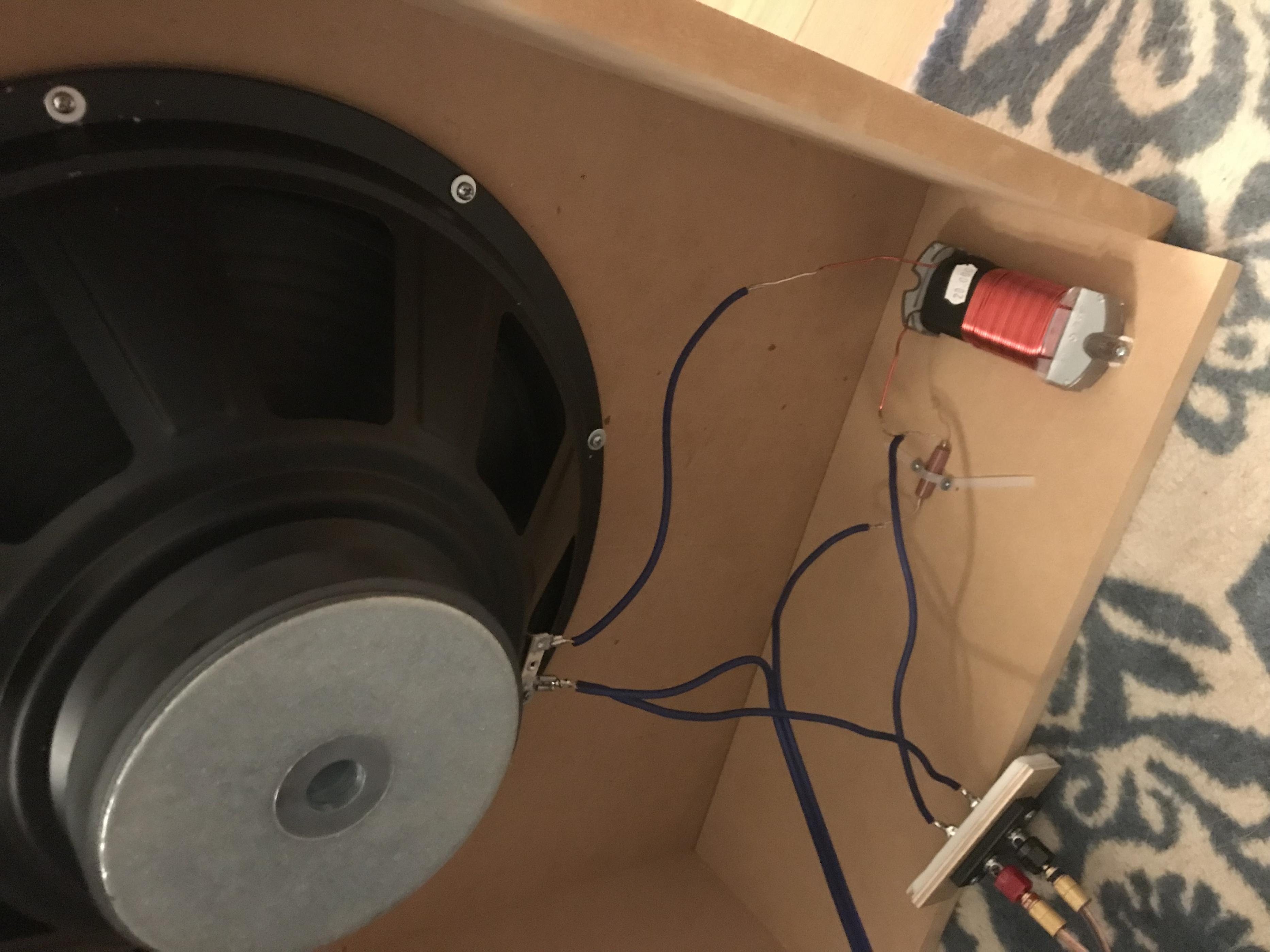

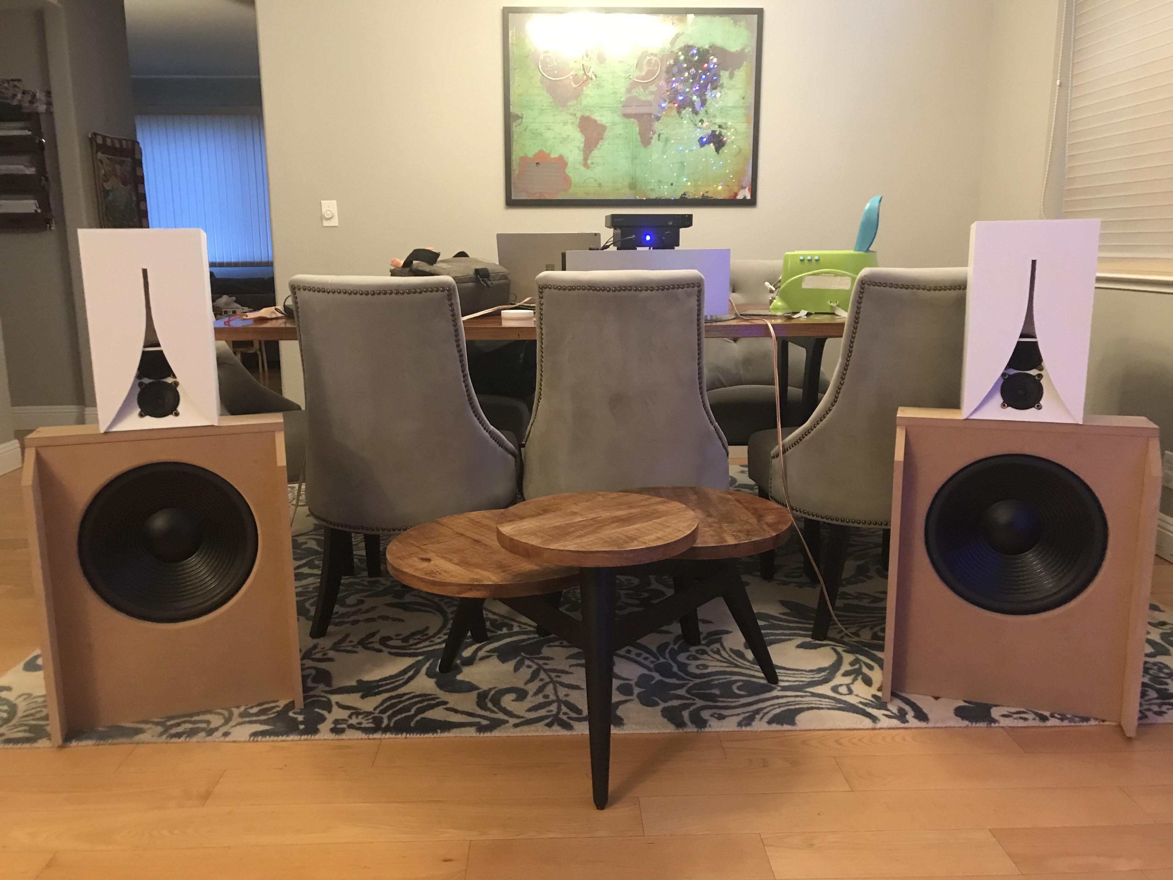

I built some open baffles to experiment with adding more low end to my system this weekend. They’re roughly based on John Busch’s Manzanitas in terms of the GRS15 woofers, baffle size and wings and the 20mH inductor on the XO. I have an 8 Ohm mills resistor in series with the 0.53x Mini-k with dual 3fe25’s. I like what I’m hearing so far. They blend pretty well and give the low end I was missing along with some good punch on percussion. I think the woofers still need some break-in time to loosen up the surrounds and things will get even better. Maybe some more XO experimentation later this week too. :D
Thanks for sharing. I have been thinking about doing something similar for a long time now and might just attempt it early next year. Are you running both sets of speakers from one amp? I am planning to try bi-amping but not sure how to implement the XO yet.
Your Manzanita like baffles are slightly different with the added wings to the front of the baffle. What is the reason for this? Getting closer to a H frame. I will be using a 12” driver, so I’ll be using the 12” Manzanita baffle size and add some wings (maybe 4”) to the back only.

Hi twocents. Yes, they’re running off of a single amp. Right now it’s my F7 clone (Class A with lateral mosfets) and have a WHAMMY as the pre. Great combo and still plenty of headroom left even with 20-ish Watts. According to my XSim simulation this combo should still be about 88-90db efficient.
Check out the Manzanita thread around post #1776 for an explanation of the wings by John Busch. He did 2.5” in the front and 5” in the back. I would think it’s getting closer to an H frame, yes. He may have also given some info about using this with the 12” peerless woofer later in the thread.
I can say the experiment was worth it if you’re looking for extended, toneful lows. It’s still not going to give you earthshaking, window rattling bass, but that’s not what I’m after. It was a plus I already had my table saw set up for another home improvement project so I was able to cut the parts from 4’x4’ of mdf with almost zero waste. I put them together in about 3-4 hours of work from start to finish.

Nice work Jwarch! It must sound great. I can imagine the sound of the open baffle bass is very clean, dry, and tight. Not flappy. Bravo!

Thanks X. Yes, the bass is nice and tight. You can really hear every note. Especially good with upright bass. A track i'm really enjoying right now is The Eagles, Hotel California, Live from a 1994 MTV concert on the Hell Freezes Over album. The bongo drums on the intro sound so realistic impact wise.

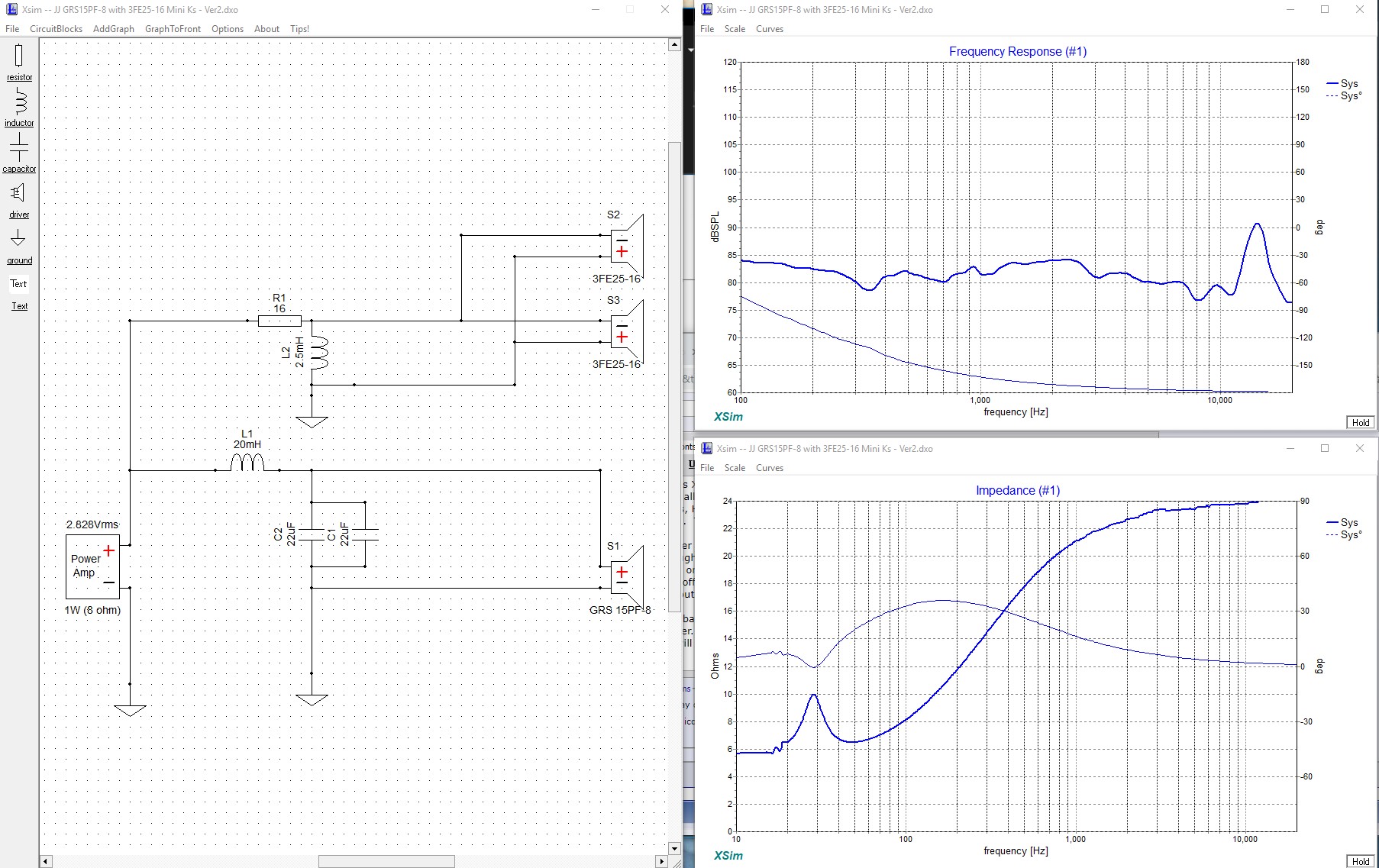

Another plus of the combo are the minimal XO components (only 2 right now). Although I'm planning on experimenting with another solution to roll the mini-k's off on the low end with a 2.5mH inductor and 16 ohm resistor, and invert the polarity. Then roll the highs off on the GRS15's with 44uF worth of caps. Image attached. Sensitivity will certainly take a hit but may sound better overall. I'll let you know.

For woofers don’t be afraid to use iron laminated core inductors to get the big mH values. No need for air core. Also, smaller gauge wire is OK too. Adds a bit of series resistance which will improve OB bass extension by making Qts larger.
Use two 10mH 18AWG in series for half the price of a 20mH 16ga. DCR of 0.78ohm x 2 = 1.6 ohms. Vs 16g which is 0.6ohms. An extra ohm of DCR is no big deal - and save $20ea.

Spent some time listening to the XO configuration I posted on post #3491 last night. In fact I couldn’t stop listening! This XO has taken things to a new level. I was experiencing some obvious resonances with the mini k’s on this like bass guitar before. That has all been cleaned up and I feel like the mini k’s and the GRS15’s are blending more seamlessly than before. Efficiency is down but I thing I still have enough power to get the volume I want. Time will tell with more hours in the listening chair.
