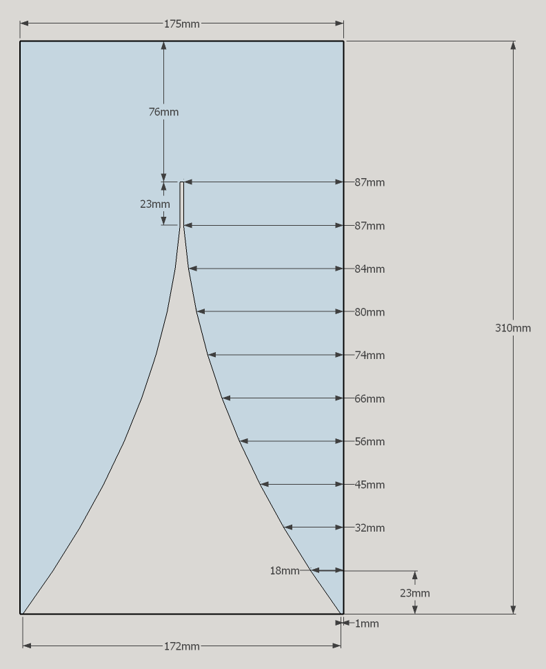

I've put together the dimensions shown in the attachments and was wondering if someone who's built one could give them a quick eyeball/sanity check before I start cutting.
Founder of XSA-Labs
Joined 2012
Blaides,
Nice drawing there! Looks good just a few comments:
1. you might want to try Grandcalmar's method of using one long piece for the front baffle with driver all the way to the internal divider. Score lines and fold and add glue to folds internally.
2. Make the K-aperture slot width wider - start at about 0.2 in wide.
3. Don't take the K-aperture to full width at bottom but truncate to leave about 0.25 in flat for durability.
4. If you have 4 drivers I recommend the 0.53x scale. Not too much more effort to make, but big payoff in sound difference as it has deeper bass extension and is four times as loud for same amp drive voltage.
The 0.4x sounds very nice and is good for smaller rooms and desktop use but the 0.53x, as Fran discovered, can fill a huge room with great sound.
Good luck!

Thanks for the advice.
1) I've already factored in Grandcalmar's idea for the front baffle into my build. I drew everything as separate pieces in my plans so I could make sure they were all in the right places and get the measurements etc.
2) + 3) Ok, back to the drawing board with the K-slot. Though this was the area of the build that I wasn't 100% sure of.
4) I only have 2 TC9FD's at the moment, but if I like the 0.4x I may well look to order more and build the 0.53x.

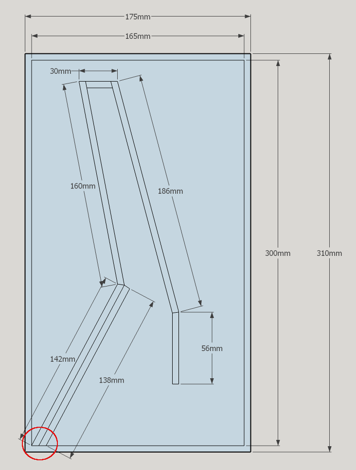

Quick question for the folks that built using the single piece method for the front baffle.
How did you handle the angled section where the baffle meets the bottom of the cabinet? (I've marked it in red on my attached image)
I was thinking of making the two sections of the baffle that hold the driver the same length, scoring/folding over, and gluing in place. Then when set cutting them to the correct angle.
