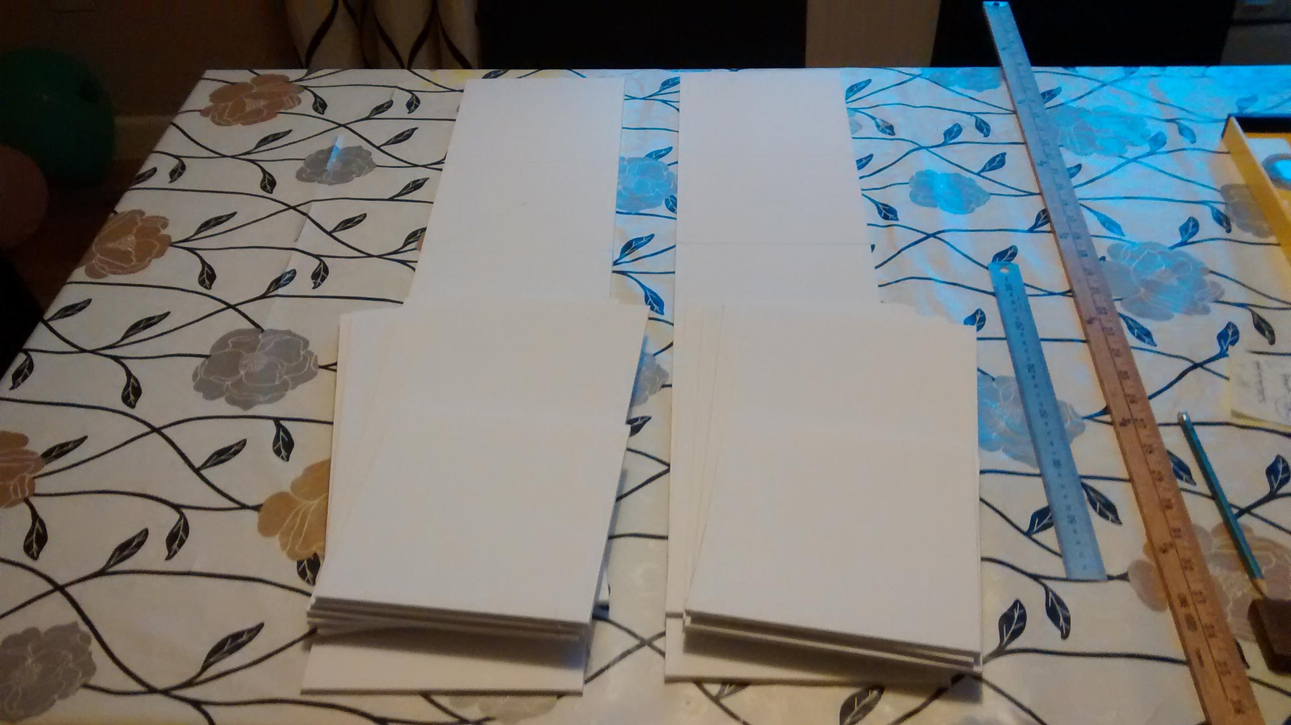

Mini Karlsonator (0.53X) with Dual TC9FDs
Blaides,
That sounds like a good idea. If FC panels were long enough you could make the entire speaker out of one long strip! Glue second panel for the double layer portion.
Thanks for the idea. As my sheet is 841mm long I can easily do this.
Oooh. I hear a challenge... What about your tiny box?
Challenge accepted :D
Sheets have been cut and are awaiting assembly :).
Hi X,
I haven't got round to gluing yet, other 'DIY' got in the way. But everything is pretty much ready to assemble, I just need to fold the baffle to shape. I was experimenting on scrap foamboard to get the depth etc. right before committing to the real baffle. Hopefully I'll get a chance tonight to get gluing.
With regards to bracing in the 0.4x version, I take it an approach like the one you used in your 0.53x build would be advisable?
