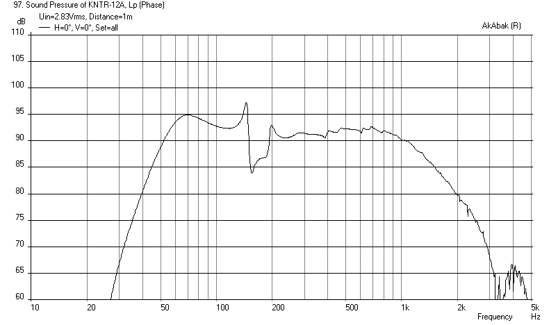

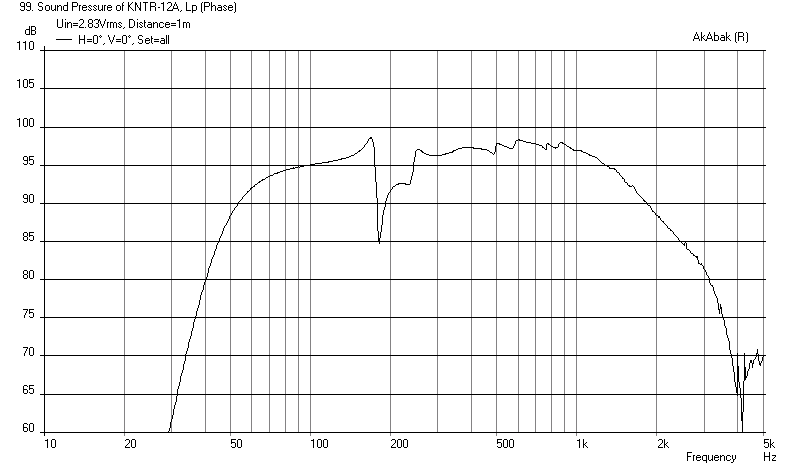

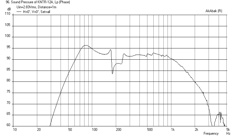

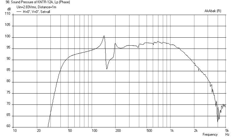

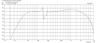

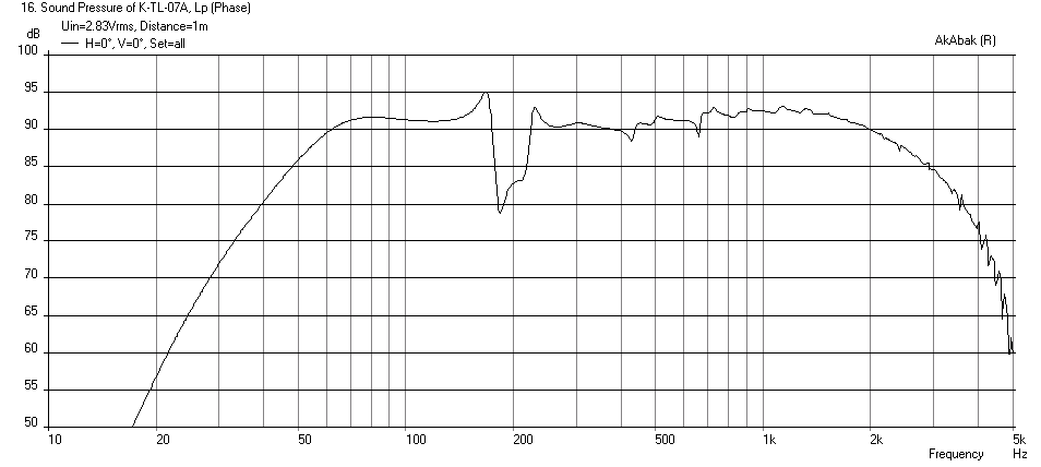

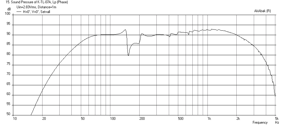

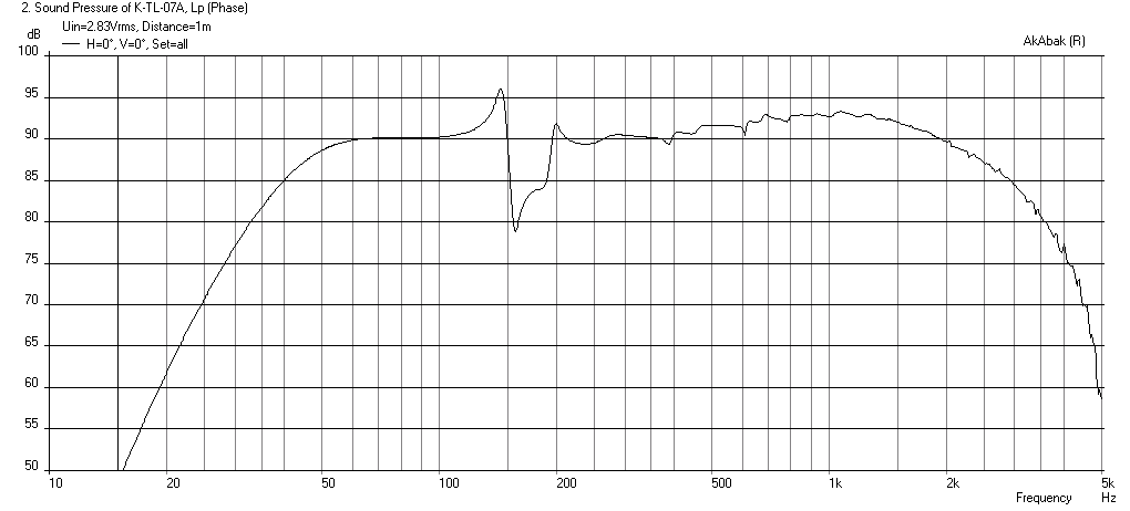

The Beta 10CX sims well in a fullsize Karlsonator (15 in driver sixe), but in a 12 inch size the bass extension is not great. The 12 LTA has a bass hump. What is a 12pe32?
Beta 10CX in fullsize:
Beta 10CX in 12 in K'nator:
Beta 12LTA in fullsize:
Beta 12LTA in 12 in K'nator:
I don't know - up to you I guess. It is interesting how the smaller 3 inch or 4 inch full range drivers can get lower bass extension. Probably due to higher Qts and larger relative volume.

My mistake then - if this drawing uses a 12 in driver then all my sims for what I call a "Fullsize" are indeed scaled 15/15. I assumed it was for a 15 in driver so when you say it is a 12 in Karlsonator I scaled to 12/15. So go with the sims of the fullsize above.

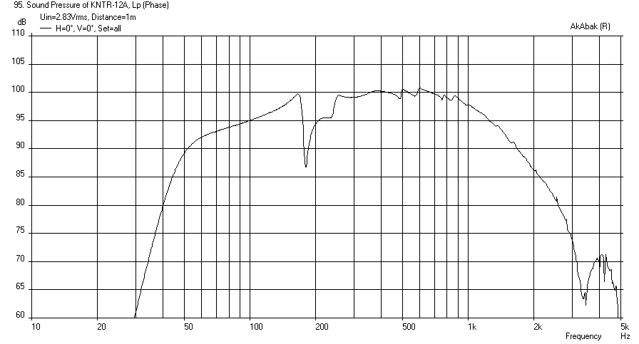

Here is what I thought was meant for 15 in driver and what I called Fullsize:
![Karlsonator.png](https://lh3.googleusercontent.com/-IsPCPSK6_lQ/TtU92CD8zMI/AAAAAAAABik/txissf4J4PI/w678-h524-no/Karlsonator.png)

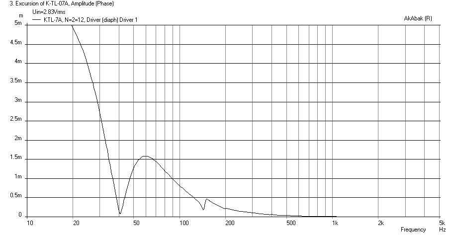

BG20 in Karlsonator 12
Freddi,
Here are the sims for the Karlsonator 12 with the BG20 - looks excellent actually. Just watch out for content below 40 Hz to prevent over-excursion.

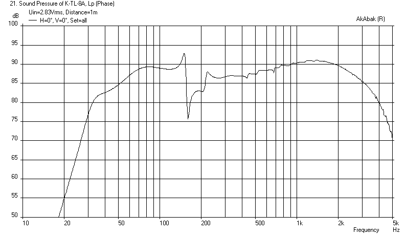

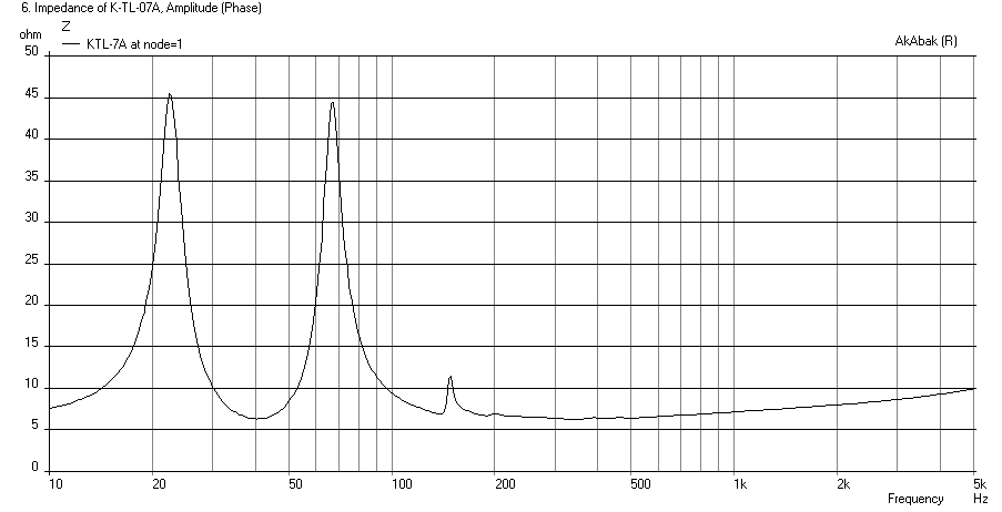

BG20 in Karlsonator 8
Freddi,
This is a scaled Karlsonator model to approximate the overall height, width and depth of the Karlsonator 8 (that is, I did not re-build the model from scratch based on the dimensions of the drawing above). I did take into account the fact that the K-aperture doesn't start until a certain distance from the top. I found that you can get a smoother response if you make the K-aperture go to a zero width cusp rather than a slot. Here are the sims:
With slot width K-aperture:
With cusp K-aperture:
It looks like a fine performer with nice "hifi" capability given the flat response and very gentle bass roll-off which should give a great impulse response and group delay. Here is the Impulse Response with cusp K-aperture:

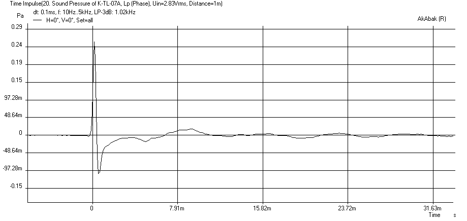

Freddi,
![416952d1399291554-mini-karlsonator-0-53x-dual-tc9fds-k7tla-k8-slot-bg20-freq-1m.png](https://www.diyaudio.com/forums/attachments/full-range/416952d1399291554-mini-karlsonator-0-53x-dual-tc9fds-k7tla-k8-slot-bg20-freq-1m.png)
![416953d1399291554-mini-karlsonator-0-53x-dual-tc9fds-k7tla-k8-cusp-bg20-freq-1m.png](https://www.diyaudio.com/forums/attachments/full-range/416953d1399291554-mini-karlsonator-0-53x-dual-tc9fds-k7tla-k8-cusp-bg20-freq-1m.png)
