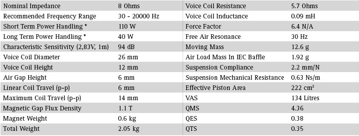

Hey Xrk971, any chance you could run a sim on this one?
I hope to have a back-up option in case the Fostex don't work out...

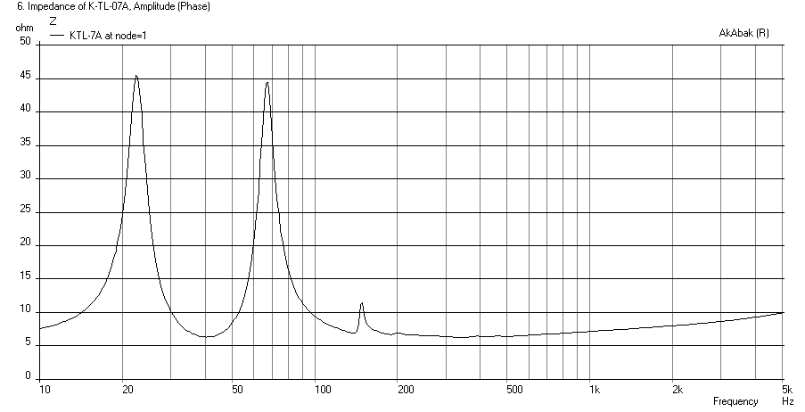

Here are the impedance graphs, first up is the Karlson 8:
And here is the Karlson 12:
Its pretty windy today so I wan't able to measure frequency response outside like I prefer to do. I had to measure it inside my woodshop, which is pretty horrific acoustically, so take what you see here with a big grain of salt:
The red line is the Karlsonator 8, the green line is the Karlsonator 12, and the blue line is a measurement of my Karlsonator 8 that I took outside several months ago for comparison.
I'm going to really try to retake the measurements outdoors if I can get a chance in the next day or so.

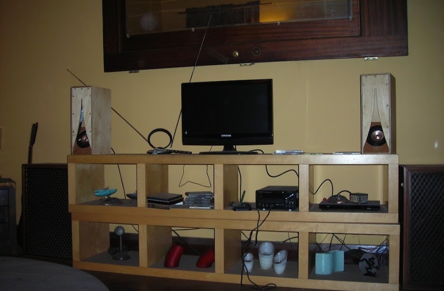

Here are a few snapshots of my own mini karlsonators, loaded with my 'old' MA gen 2 CHR70 drivers. These are .53 scale but 5.15" wide.
I'll attempt to get some measurements soon, but am still in the tweaking and experimenting phase. (who am i kidding, i am always in that phase. 🙄🙂:spin:)

hi Jesse - it looks for all practical purposes that the Karlsonator 8 does as well or better than the 12 for BG20 - did your mic point right on the dustcap axis? - that will usually show more top end. I really like GB's mini build (is that a sock lurking in the front chamber?) Which fullrange might suit the Karlsonator 8 better than the little Visaton? In K12, FE206EN had better quality on drums than my Klipschorns.
that's a very low tuning for the Karlsonator8 - Karlson's K8 tunes ~95Hz, the little SK8 ~65Hz, and I think my XK8 almost the same size as the Karlsonator8, somewhere in the low 50s (?)

Those are very nice looking 0.53x scale mini's. I recall running a sim for Illusus a while back for CHR70.3 - not sure if he ever made them but the dimensions were about the same. How do they sound?

Yeah, I basically used your suggested dimensions. Thanks! 😀
RE: the sound - The bass is much much much better than when they were in BR boxes, and they will play quite loud for a 3" full range. Also, there is no longer a need for BSC, as the bandpass gain of the couplers is doing its job. The passive filters I used to need with these CHR70 really kind of zapped the life out of them.
Vocals (mids and treble) are a little colored if left in this raw state with minimal damping, but I think I can fix it. A serious issue IME with Karlsons is that the 'reverb' and coloration in the mids and treble from the front chamber gets worse as the size gets smaller. I am experimenting with felt lining and the other ideas to reduce or eliminate this. So far the experiments seem very promising, and I am getting a very open and clean sound, while retaining the effortless and powerful thing. I'll update again after some more tweaking.
Glad it is working out for you. These do sound loud for how small the drivers are. I used polyfill stuffing behind the wings and that helped. Awesome that you eliminated the BSC. I never needed it either on these.

it would be interesting to see in the impedance with wings removed - wonder how much adjustment to the vents would be needed to move the tunings up a bit? - that info could be added to the plans. Perhaps a change in the first part of the slot on the 12 inch Karlsonator would be enough.
what might the blue aperture trace on the Karlsonator 8 plan do to the input impedance? response? "tone"?

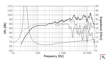

hi X - it would be great if hornresp could handle the original Karlson using a few assumptions. Would a Tangband W8-1772 work in the Karlsonator 8 or the 12 better? In Karlson's 1954 K12, I prefer FE206EN to W8-1772 - but 1772 sounded very good in a little "SK8" K-coupler - its like K12 was too large or something.
