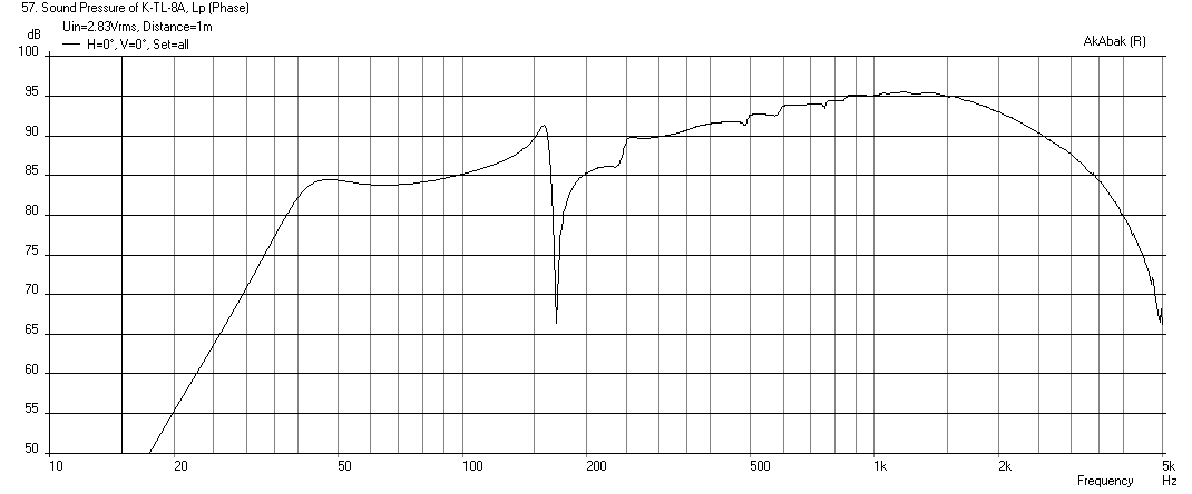

FE203EN-S in a Karlsonator
Ok, here is a sim based on Klang and Ton measurements which have a slightly higher Qts than the factory 0.14.
In a regular Karlsonator 8, you will have a bass peak and a sagging response followed by a very eat your ears off high mid range (stuffing or felt added behind the wings in the front cavity can help with this):

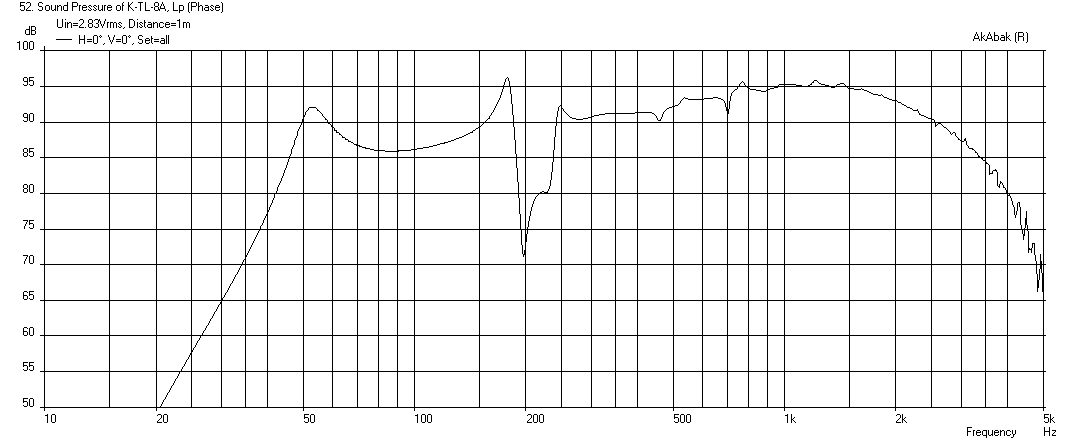

If I make the box smaller to get the volume down by scaling height and depth by 0.81x and width by 0.53x, we get this:

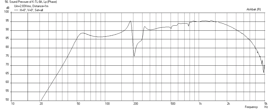

If you made the K-aperture go to a sharp cusp instead of a slot you can get some deeper bass extension but at the cost of a very imbalanced low vs high response:

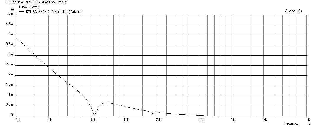

Looking at the cone excursion, it is as I expected , a runaway at low freq so a high pass filter is needed or XO, or just be careful with stuff that has content below 40 Hz:

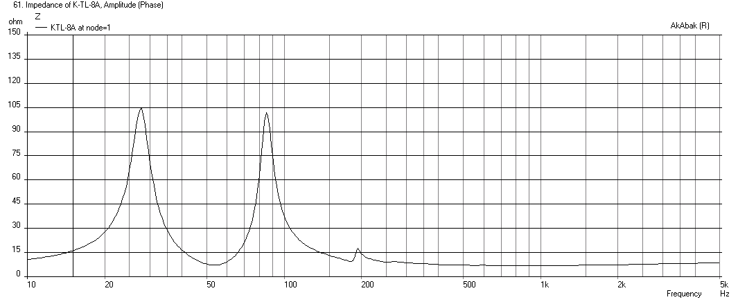

Here is Impedance of the 0.81x version with slot front aperture:
![417150d1399407427-mini-karlsonator-0-53x-dual-tc9fds-k8-tla-fe203en-s-freq-1m.png](https://www.diyaudio.com/forums/attachments/full-range/417150d1399407427-mini-karlsonator-0-53x-dual-tc9fds-k8-tla-fe203en-s-freq-1m.png)
![417151d1399407427-mini-karlsonator-0-53x-dual-tc9fds-k8-tla-0.81x-0.53xw-fe203en-s-freq-1m.png](https://www.diyaudio.com/forums/attachments/full-range/417151d1399407427-mini-karlsonator-0-53x-dual-tc9fds-k8-tla-0.81x-0.53xw-fe203en-s-freq-1m.png)
![417152d1399407427-mini-karlsonator-0-53x-dual-tc9fds-k8-tla-0.81x-0.53xw-fe203en-s-freq-1m-cusp.png](https://www.diyaudio.com/forums/attachments/full-range/417152d1399407427-mini-karlsonator-0-53x-dual-tc9fds-k8-tla-0.81x-0.53xw-fe203en-s-freq-1m-cusp.png)
![417153d1399407427-mini-karlsonator-0-53x-dual-tc9fds-k8-tla-0.81x-0.53xw-fe203en-s-displ.png](https://www.diyaudio.com/forums/attachments/full-range/417153d1399407427-mini-karlsonator-0-53x-dual-tc9fds-k8-tla-0.81x-0.53xw-fe203en-s-displ.png)
![417154d1399407427-mini-karlsonator-0-53x-dual-tc9fds-k8-tla-0.81x-0.53xw-fe203en-s-impedance.png](https://www.diyaudio.com/forums/attachments/full-range/417154d1399407427-mini-karlsonator-0-53x-dual-tc9fds-k8-tla-0.81x-0.53xw-fe203en-s-impedance.png)
